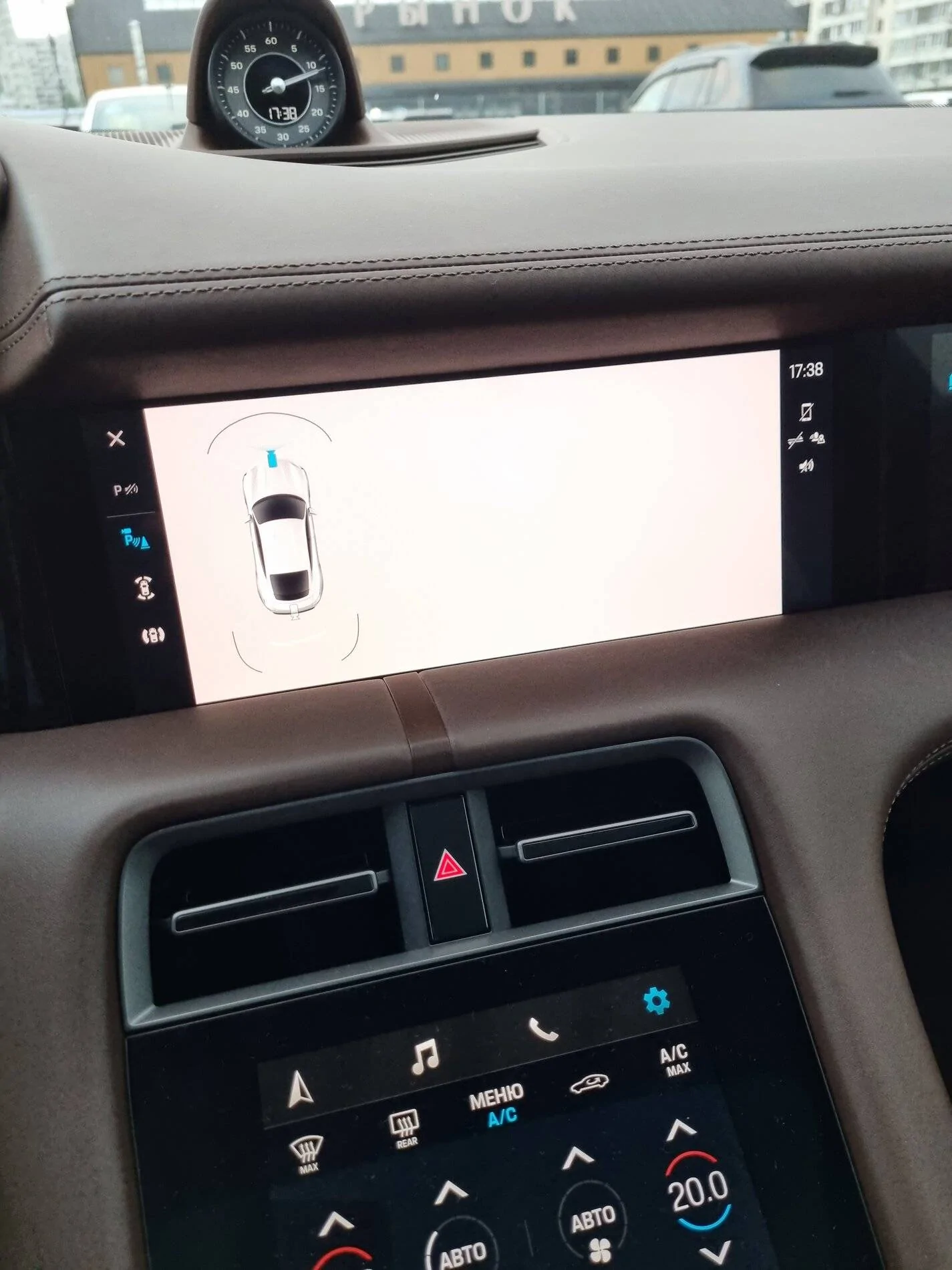

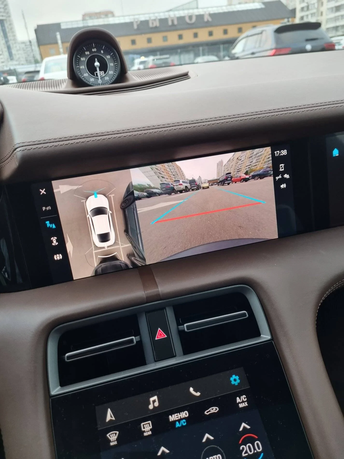

Problems with the camera started, it is activated for a second, followed by a white screen. What could be?

I had exactly this problem a few days ago. I turned off the car, got out, locked the doors, went inside the house, put the keys away, and stayed away for ~30 minutes. When I went back, everything was working again.
A few days later, while backing out of the garage, suddenly the cameras and PDC sensors all shut off and I got two alerts on the dash about malfunctions. I believe I just put the car in park and then back in reverse and everything came right back on.
Edit: No idea if this is the problem, but when I got the "white screen of death" I believed it was because I turned the cameras on too fast. I had been sitting in the car with it off for some reason -- I forget why -- and so everything was still booting up when I turned the cameras on. And the second incident was immediately after I had just installed a front license plate holder. So it's possible that the errors were in response to things I did, and they may not have been related to each other.

I've had the white screen before, goes away after locking and unlocking the car.
