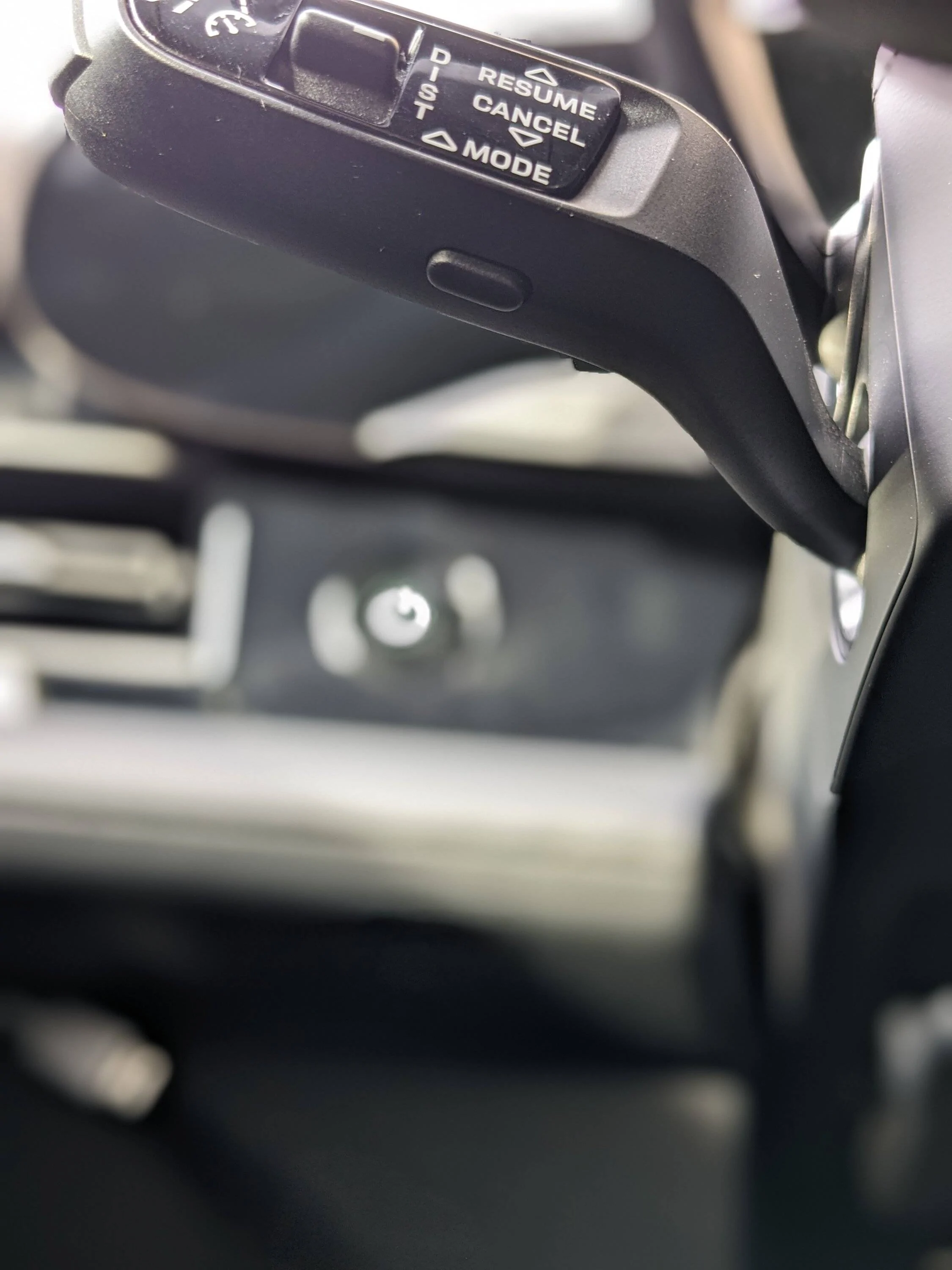

thanks to this thread, I discovered the existence (after 1.5 yr....) and use of this small button !
Porsche Taycan Taycan Instrument Cluster: 3 dial set up? PXL_20240121_111815230.PORTRAIT

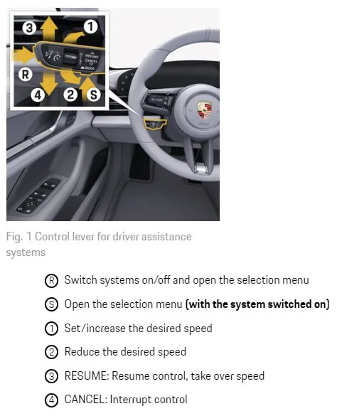

Omg haha I need to know, what does this button do?
24Neptune
Cheryl
Jan 16, 2024
58
71
Texas
2024 Porsche Taycan RWD, 2024 Audi SQ5 Prestige
Driver Assistance mode
