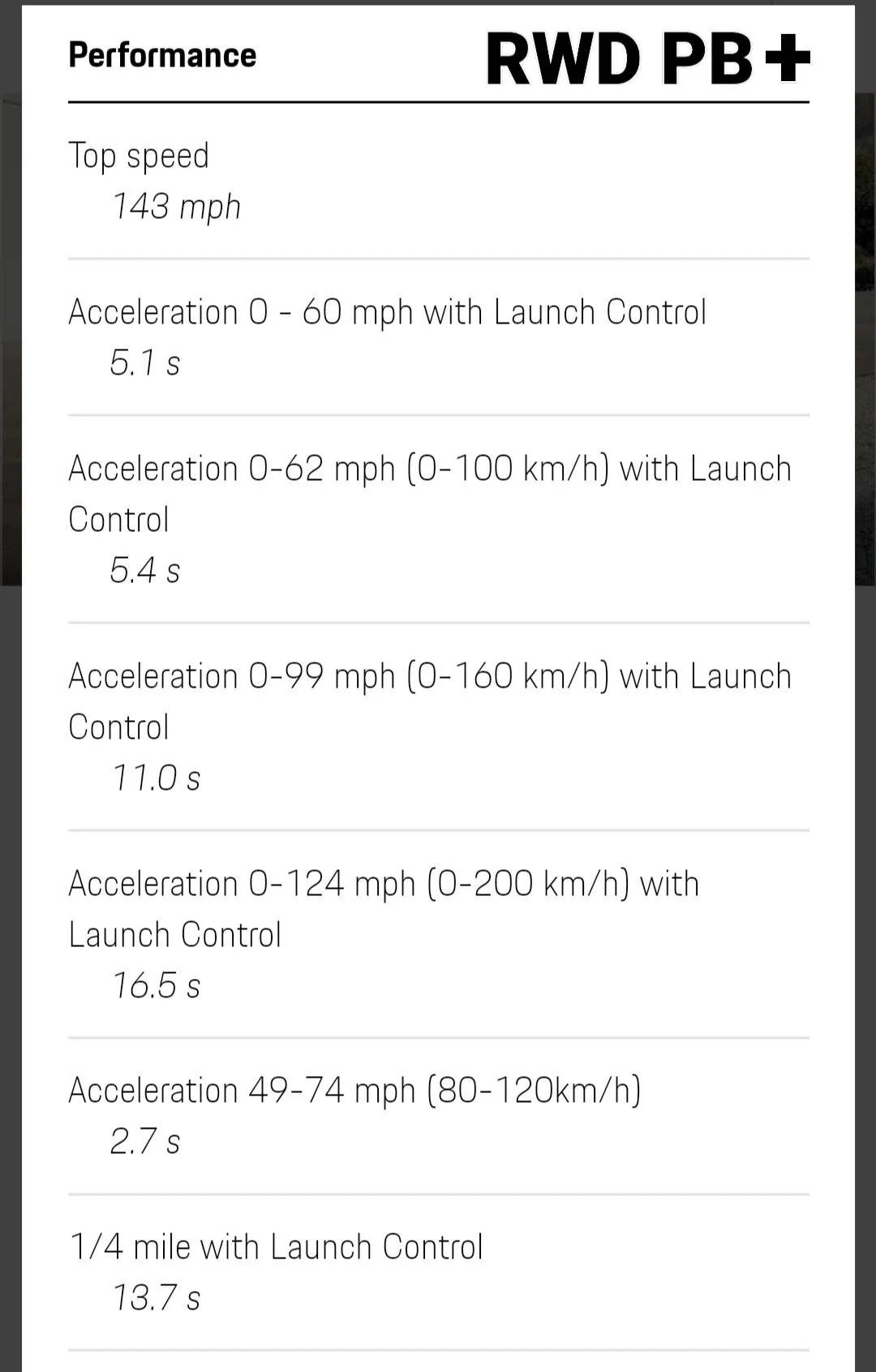

I had posted the official Porsche figures for the RWD/PB+ previously as they seemed a bit strange. Same as standard battery 0-60 and 1/4 mile - but faster in between??
Also, when compared with the other Taycans, I had assumed/guessed you lost a bit on 0-60 due to AWD v RWD. But once the momentum is there, the lighter RWD may reduce the advantage..... Just guessing here, becuse grip doesn't seem to be an issue launching my car in the dry??
