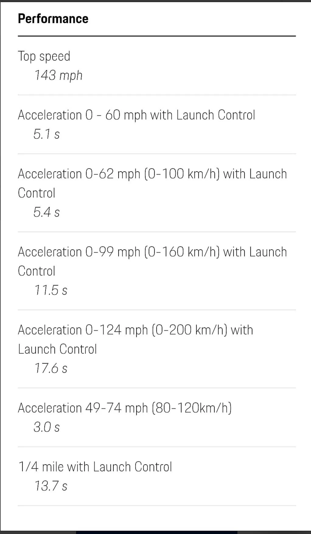

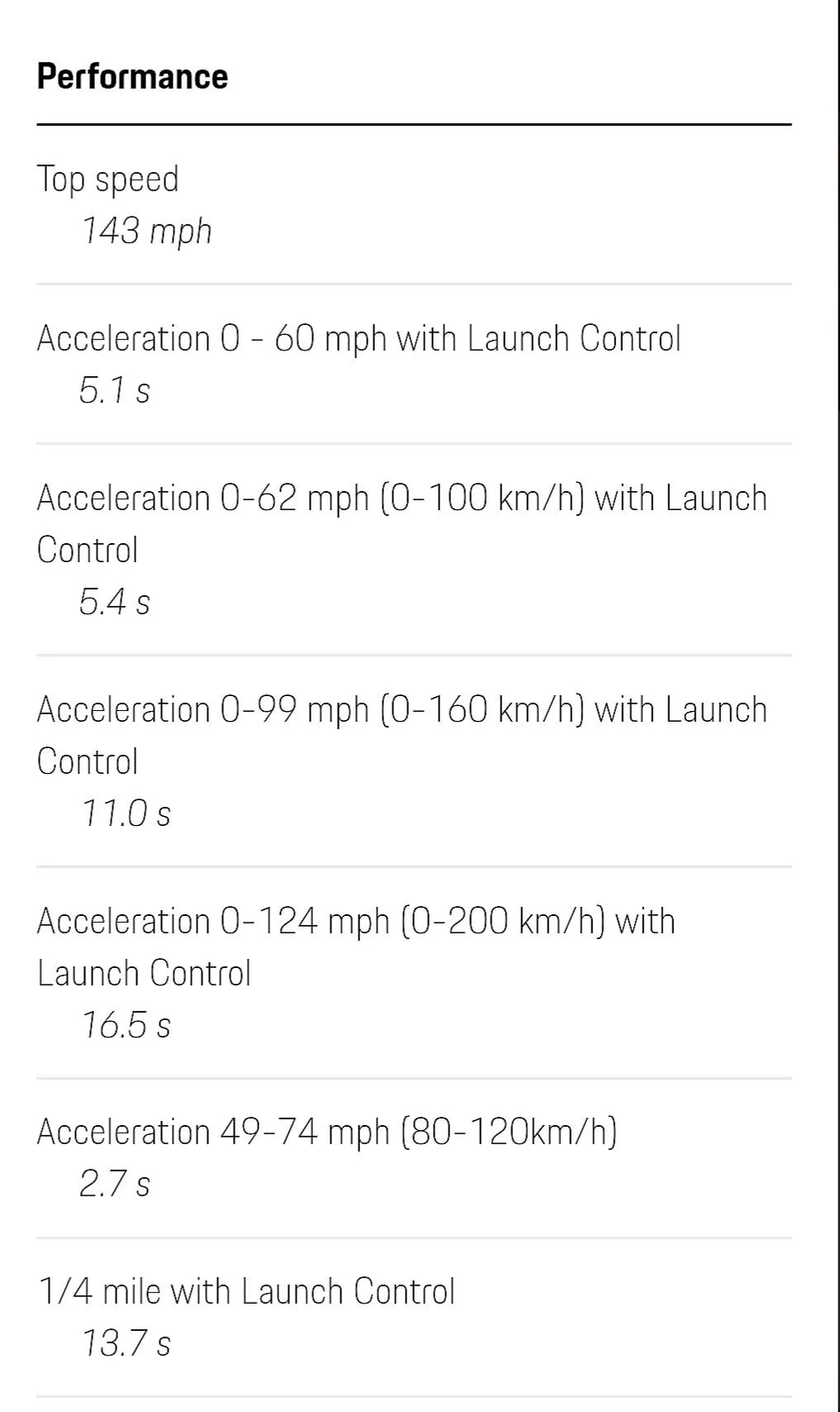

Apologies if this has been posted before, but I have never seen it.
I decided to look at the tech spec on the configurator when ticking the standard and plus battery option.
As most reports focus on standing start times (0-60 and 1/4 mile) and top speed, they always state that they both have the same performance due to the extra weight (80kg). Which is true.
But I am also interested in the 'rolling times' as looking to compare with my current M2 and was surprised to see different stats for some of the quoted figures. Points 4, 5 and 6 in the comparisons below are all different (PB+ is top pic).
Bottom line is that you do get a bit of 'real world' (80 - 120 most useful stat imo) performance increase as well as extra range.
Porsche Taycan RWD performance - 79.2kw v 93.4kw battery Screenshot_20210801-055956_Chrom
Porsche Taycan RWD performance - 79.2kw v 93.4kw battery Screenshot_20210801-055834_Chrom

Numbers make no sense. Battery+ car is .5 faster to 99, but no faster in the 1/4? How does the small battery car close that gap? Impossible…
We need real world results. I suspect the battery+ car is much fast from a roll, without overboost especially.
Who has a draggy?
Who has a draggy?
Yes, strange that the PB+ is faster for
0-99moh (11.5s v 11s)
0-124mph (17.5s v 16.5s)
Yet the quarter mile is the same, which is in between these two
(13.7s)
That would suggest the PB+ starts off quicker to 90mph.... then looses ground and the PB catches up to 1/4 mile .....then speeds up again to 124mph and by then is a full second ahead.
