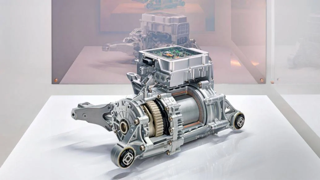

Powerhouse: the electric motor and two-speed gearbox (front) are arranged parallel to the rear axle. The power electronics are located on top.

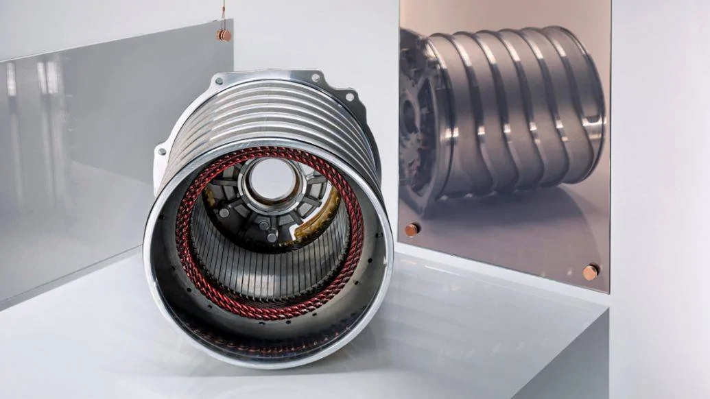

Centrepiece: the stator of the e-motor essentially consists of circular sheet-metal discs layered into a tube and the copper coils. U-shaped bent wires are inserted into gaps in the tube and connected to each other.

Technology driven to its very limits: this Porsche gene is reflected in a special feature of the Taycan motors, known as the hairpin winding. Here, the coils of the stator consist of wires that are not round but rectangular. And unlike classic winding processes where the copper wire is obtained from an endless reel, hairpin technology is what is known as a forming-based assembly process. This means that the rectangular copper wire is divided into individual sections and bent into a U-shape, similar to a hairpin. These individual ‘hairpins’ are inserted into the stator laminations in which the winding is mounted in such a way that the surfaces of the rectangular cross-section lie on top of each other.
Porsche Taycan Taycan’s electric motors explained g-motor1

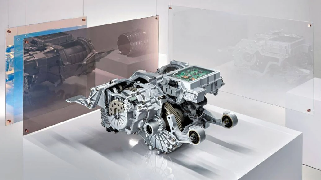

Compact: the front-axle drive of the Taycan is designed to be even more space-saving than the drive unit in the rear. The motor and gearbox are arranged coaxially; the rotor, gearbox, and axle shafts are in line.
This is the decisive advantage offered by hairpin technology: it allows the wires to be packed more densely, thereby adding more copper to the stator. While conventional winding methods have a copper fill factor – as it is known – of around 50 per cent, the technology used by Porsche has a fill factor of almost 70 per cent. This increases power and torque with the same installation space. The ends of the wire hairpins are welded together by laser, creating the coil. Another important advantage is that the homogeneous contact between adjacent copper wires improves heat transfer and a hairpin stator can be cooled much more efficiently. Electric motors convert more than 90 per cent of the energy into propulsion. But just as in an internal combustion engine, the losses are converted into heat that has to be dissipated. That is why the motors have a cooling water jacket.

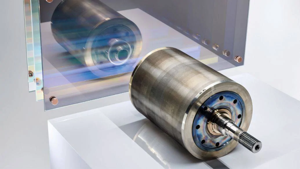

Flywheel mass: the rotor is filled with permanent magnets arranged in a V-shape.
Porsche was the first manufacturer to implement a voltage level of 800 volts. Originally developed for the Porsche 919 Hybrid race car, this voltage now reduces weight and installation space in series production thanks to leaner cables, enabling shorter charging times. The electric motors reach up to 16,000 revolutions per minute. To make optimum use of this speed range for Porsche’s signature spread between dynamics, efficiency and top speed, the front and rear drive units each have their own transmission. The Taycan is the first electric sports car ever to have a transmission with two shiftable gears on the rear axle, the first of which has a very short reduction ratio. On the front axle, an input planetary gearbox transmits power to the wheels.
These combine to give the Taycan Turbo S its mighty powers. At the front axle, the gear ratio translates the 440 Nm generated by the electric motor to around 3,000 Nm at the wheels. Some 610 Nm from the rear-axle motor are multiplied in first gear to about 9,000 Nm of axle torque. The task of the longer-ratio second gear is to ensure efficiency and power reserves at high speed. This is pioneering technology, applied to the smallest detail – and a continuation of Porsche’s tradition of innovation in the age of the electric drive.
