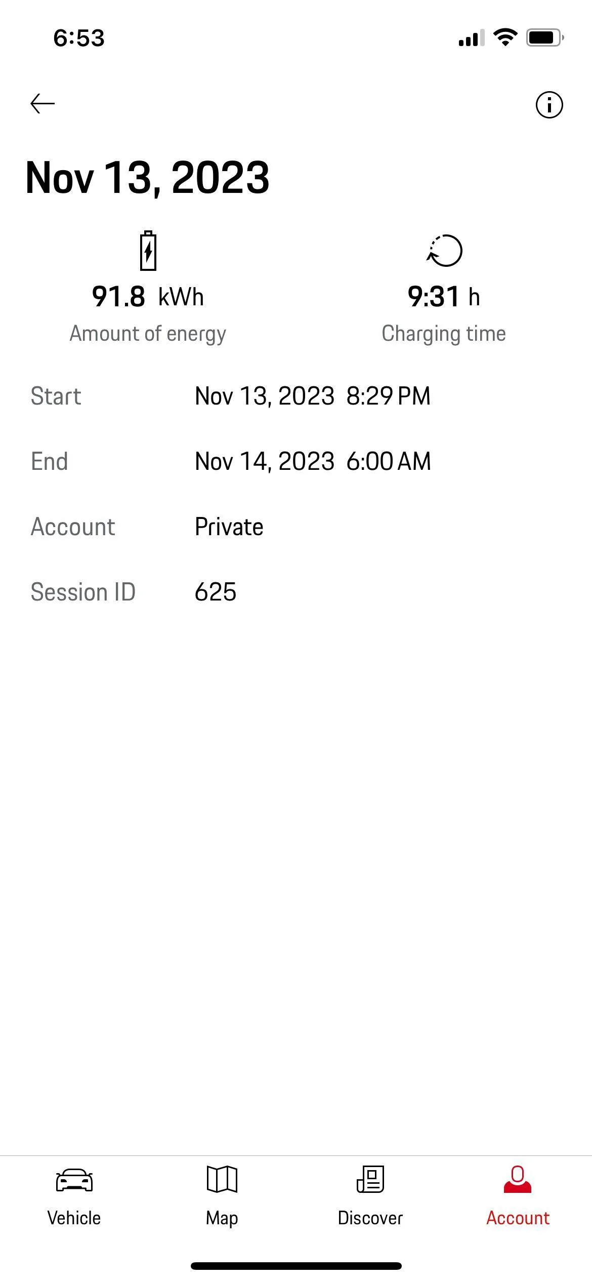

I had a very unique charging experience and I think it would be very interesting to see if others have some data that we can compare. I ran the car down to 2% (driving around my home for the last few %), let the car sit the next day, then charged at home to 100% using the Porsche charger. The data is shown below in the MyPorsche app. If the 91.8kWh delivered is correct, and represents 98% of the total battery capacity, this would mean 100% capacity would be 93.7kWh. A pretty high number for a 2020 car with 36,000 miles (and yes, 2/33 modules replaced).
Anyone else have this kind of data?

fast charging or slow charging - this makes sense from a point of view of kWh's delivered to the vehicile - with AC/DC conversion losses and other overhead - 91.8 kwh delivered to the vehicle's charging port could easily be only 82'ish kWh delivered as battery capacity due to losses in the charging process…
82.3-84.3 kWh "usable" is the target capacity according to porsche tech talks and general knowledge - with 10% overhead therefore a 0-100% charge coudl easily demand 92 kwh's from the EVSE to "land" that many kWh's of capacity into the battery for a given charging session.

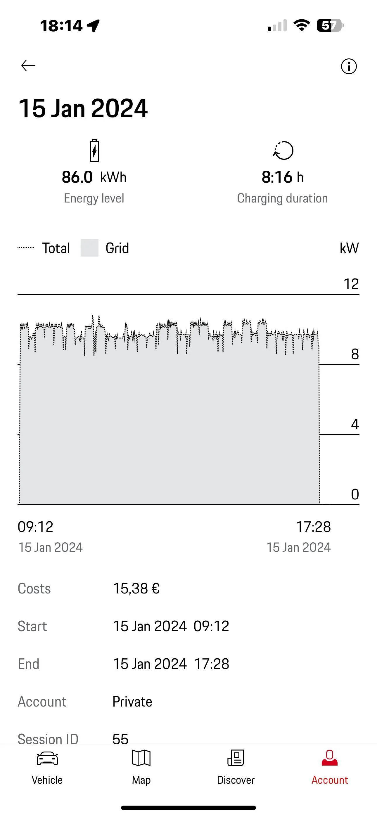

I agree with @daveo4EV above that the losses from the EVSE and into batter is about 10-12%.
I did a similar charging on my return home after a long Norwegian trip. On the cvice of you I ran it down to close to 10% and charged to 100%. I then got 86 kWh on the PMCC.
Very good point. I hadn't figured on the probably significant energy losses in the cable (lots of heat). Reviewing some of my other OBD readings, I'm seeing 79.35kWh at 99.72% SOC.
This^. It appears that the charging session data available in the app is measured at the charger/EVSE - not as received by the car. (We had sort of a debate on this on the recent app thread, won't repeat the arguments here.) And indeed losses are about 10% (8.7kW at the car from 9.6kW out of the EVSE in my case -> 90.6%).

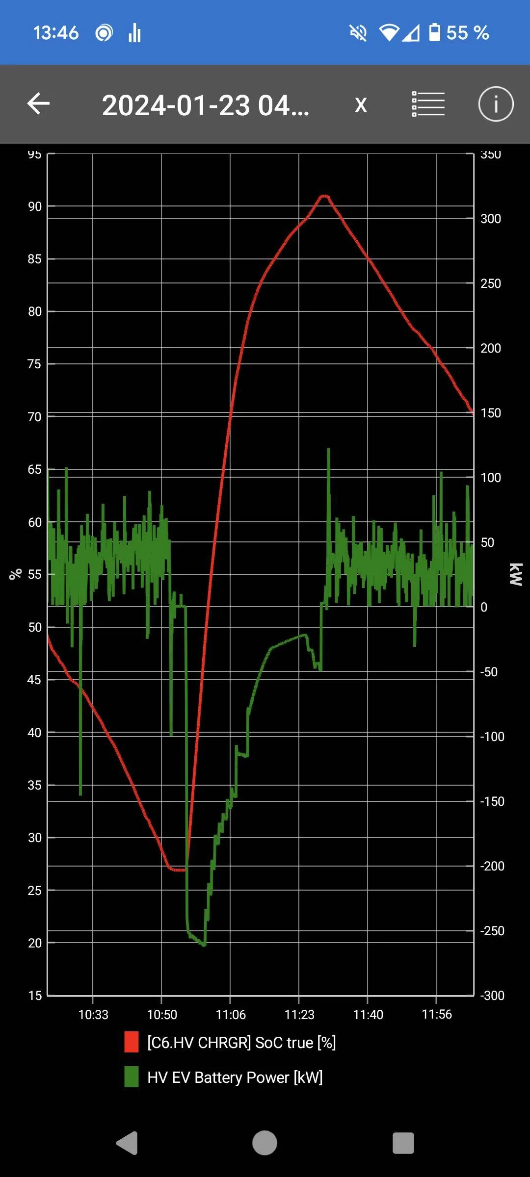

But when you use CarScanner, the car will need to be switched on.
That's what I also thought but it works when switched off.
I was able to get the full data set even when the car was switched off and locked while charging in a recent trip. Only one constraint : you have to leave your phone in the car....
