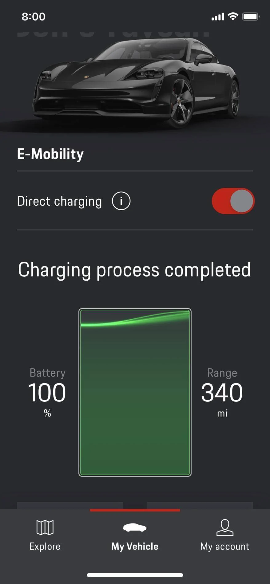

We arrived at our destination on Friday, found the charger, and used the Greenlots app to initiate the charging session. Even though I had loaded credits into my account, the session wouldn't start. I called Greenlots from the app and after about 2 minutes on hold, got an agent that initiated the session for me. He said something about the location not recognizing my phone/app but it kicked in so we were happy.
About 2 hours into the charge, I received an email saying the session disconnected so I walked out, unplugged from the car, and stuck it back in, hit the "charge now" on the app and it took it to 100% over the next few hours. The charge rate was $.15/kWh+ 6% of total, so we spent a whopping $6.13 to charge. I deliberately selected "direct charge" as we were heading out the next day for sightseeing. We arrived back on Saturday afternoon from the beach and decided not to charge again since we still had 280 miles left on the guess-o-meter and figured we could get home just fine.

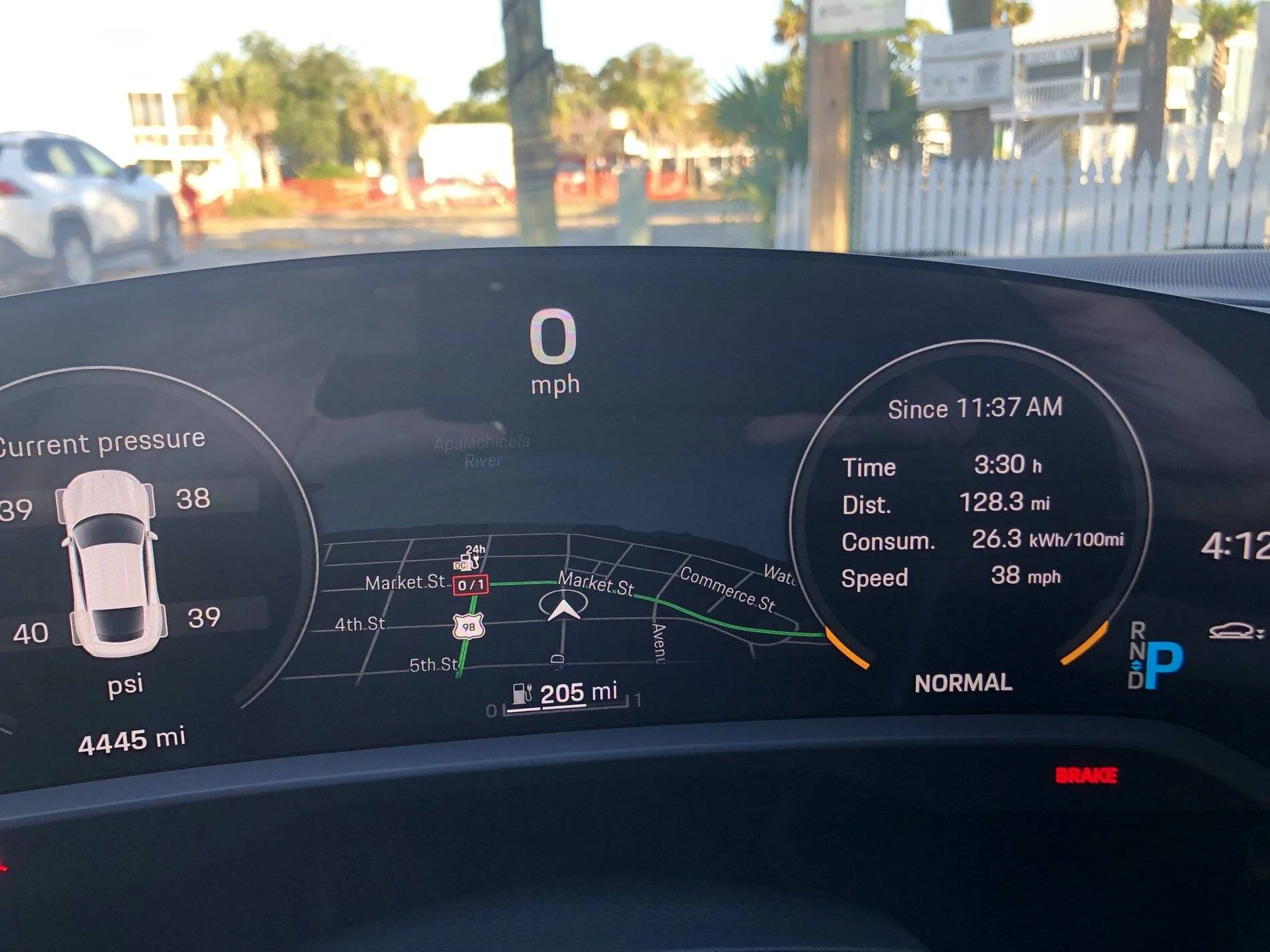

So at 100% charge with 340 miles, we did 128.3 averaging 3.8 mi/kWh or 26.3/kWh/100mi, showing a delta of 6.7 miles between actual mileage driven and fuel meter.

Attaching some photos of the trip.

I am very jealous of your range at 340 miles and that is on 21 inch tires. That is so much better than my range of no more than 220 miles. But I guess the difference is due to your driving at a much lower average speed, 38 mph.

Yep - it was not a high speed run but we did have 30 miles of the trip at 60+ mph. I'm going to make a drive over to the L3 charger at some point which will put in a position to open it up. Will report results back then to compare.
