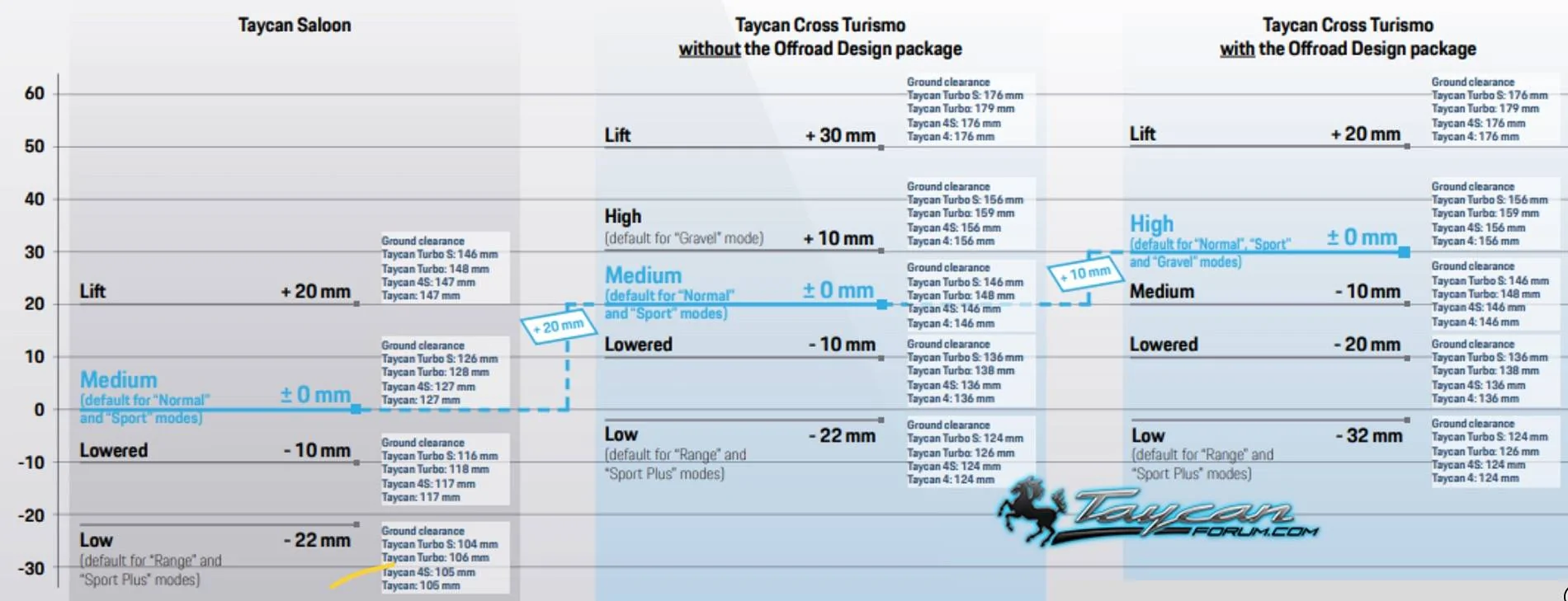

The image above shows ride heights by model and suspension setting.
Compare against the UK speed bump permitted height, which is 4”/101mm. Some seem to be higher. Some are longer than others, which may be significant for approach angle.
Other threads here have examples of dents a little above 3mm to critical areas of the ‘battery protection plate’ resulting in £40k battery replacement insurance claims.
Default CT settings are probably ok.
Given the purpose & location of speed bumps and the 20/30mph speed limits applicable, there’s nothing to be gained from using anything other than a normal suspension setting and drive mode in urban locations. Slowing to less than 20mph, sufficiently to store/operate Smart Lift, becomes a habit.

Yep, to put it in perspective your normal ride height is 156mm and a BMW 2 series convertible is 128 mm.
I had a 4S CT for 2 years so 10mm lower than years and never had any issues. I've now got a 4S ST so 127mm in normal mode and I haven't scraped any yet.

In the UK the legal max height of a speed bump in 100mm.
The loweest the taycan will go is 104mm.
I live in NW london where there are tons of speed bumps and I have never scrapped the bottom of the car even in the lowest setting.
The only danger is if you go too fast you will bump the front of the car on the way down.
