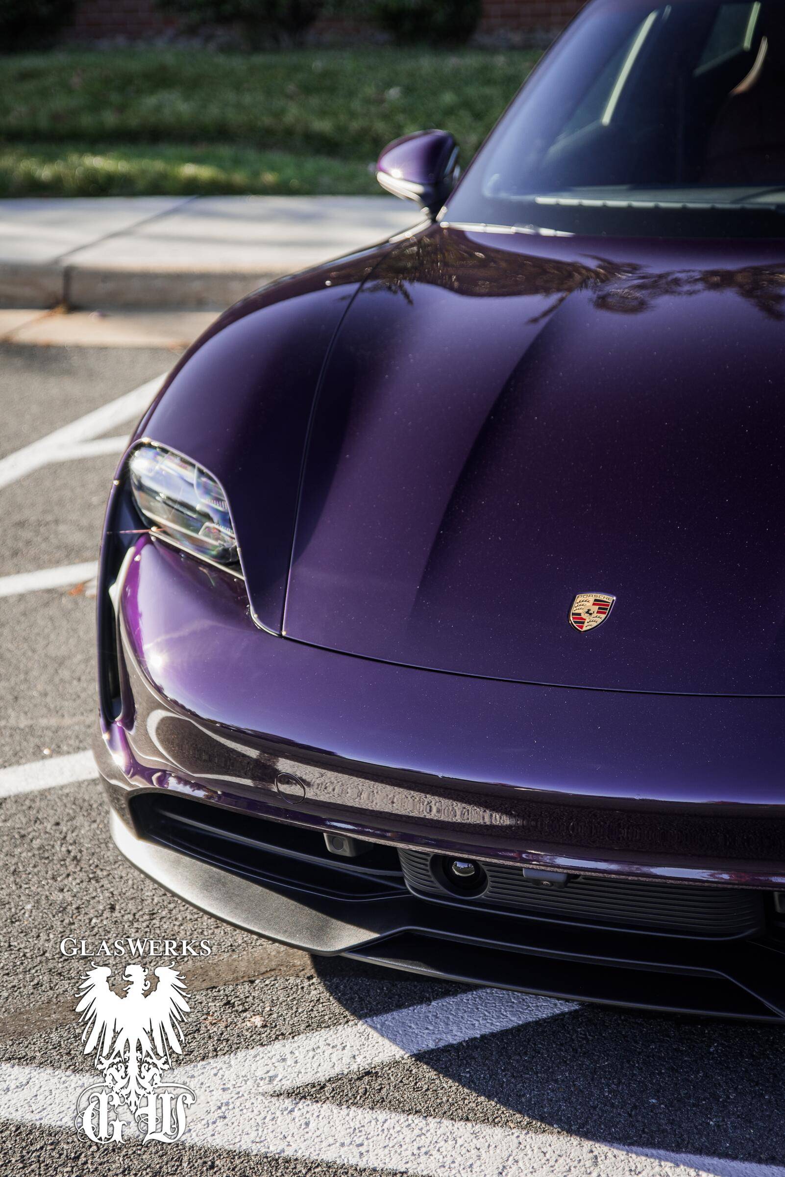

Careful: "wrap" is completely different than PPF.
Wrap is thin (typically ~2 mils) and much less expensive installed than PPF.
PPF is typically >8 mils thick, which lets it absorb common road hazards before they can damage the underlying paint. Some brands of PPF also incorporate the equivalent of a ceramic coat outer layer, which lets the car stay clean-looking longer, and makes it far easier to clean when it does get dirty.
Full clear or matte PPF of a Taycan typically costs $6-9,000 installed. Templated PPF such as Xpel that can be installed by less expert installers costs at the low end, but leaves more visible edges and seams. Some less expensive brands of PPF require a separate ceramic coat, which typically costs an additional $1-2,000.
Colored PPF is much more labor intensive to install than clear or matte, partly because the installer can't see through it during the stretching process. Colored PPF is also more expensive material, so expect to pay well over $10,000 installed. But the results are incredible — you end up with a Taycan that has amazing color, depth, and gloss, thick impact/scratch and hydrophobic coat protection, and near elimination of any orange peel texture of the original paint. Here's an example on a Panamera:
And here's the same PPF on an originally volcano grey Taycan:
Porsche Taycan Volcano Grey Taycan GTS Stealth Wrap Pics 1652049715264
Photo credit: Matt Rabassa
