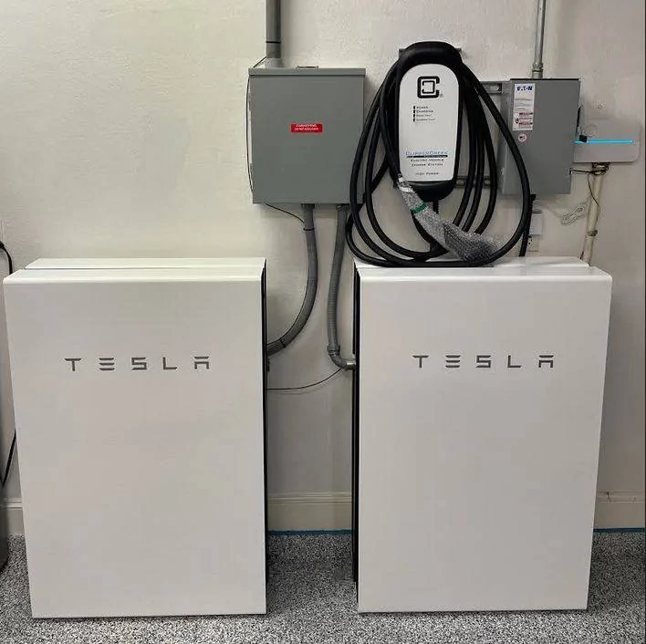

My system is effectively as shown in your graphic.
My setup includes a Clipper Creek HCS-60R charger installed and connected to my 28kW solar system with 4x Tesla Powerwall batteries which run my home and pool with enough power left over to charge my 4S and also sell enough power back to my electric company that I've spent less than $200 on electricity so far this calendar year.
I've only used power from my batteries so far to charge my 4S and hope to use that exclusively unless I eventually charge at a public charger. And I should note that to-date I've only manually charged my vehicle after checking the SOC of my batteries to ensure that they won't fully discharge while charging my 4S. I usually start charging sometime between noon & 3pm.
Porsche Taycan Photovoltaics + house battery + Porsche Home Energy Manager + Porsche Mobile Charger Connect Tesla Powerwalls and Clipper Creek HCS-60R charging station

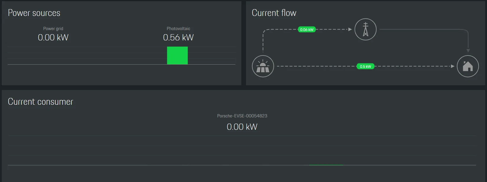

Yes, the HEM is installed and configured - but I'm getting inaccurate numbers reported.
Right now the HEM is saying this:
Porsche Taycan Photovoltaics + house battery + Porsche Home Energy Manager + Porsche Mobile Charger Connect 1636061185854
While the inverter is saying this:
Porsche Taycan Photovoltaics + house battery + Porsche Home Energy Manager + Porsche Mobile Charger Connect 1636061211327
HEM is reporting 0.56kW of solar vs the inverter reporting 0.33kW (its a rainy early morning hence low power generated).
The HEM is also saying the house is using 0.5kW, while inverter says 0.89kw.
There is clearly a calibration issue here I need to discuss with the installer.

The inverter and the Reposit dashboards agree exactly in terms of power usage - the HEM shows different numbers.
As you say, I suspect the HEM will not be able to integrate with a smart battery controller.
Did you notice that the HEMS PV value is identical to the battery discharge value? Looks like it is connected to the wrong power cables.
Did you check if the HEMS has an option to integrate battery charger power with additional measurement adapters?
You may be right - I'll check to see if it CT is on the wrong feed, or if an additional CT is required to accommodate PV -> house and Battery -> house.
