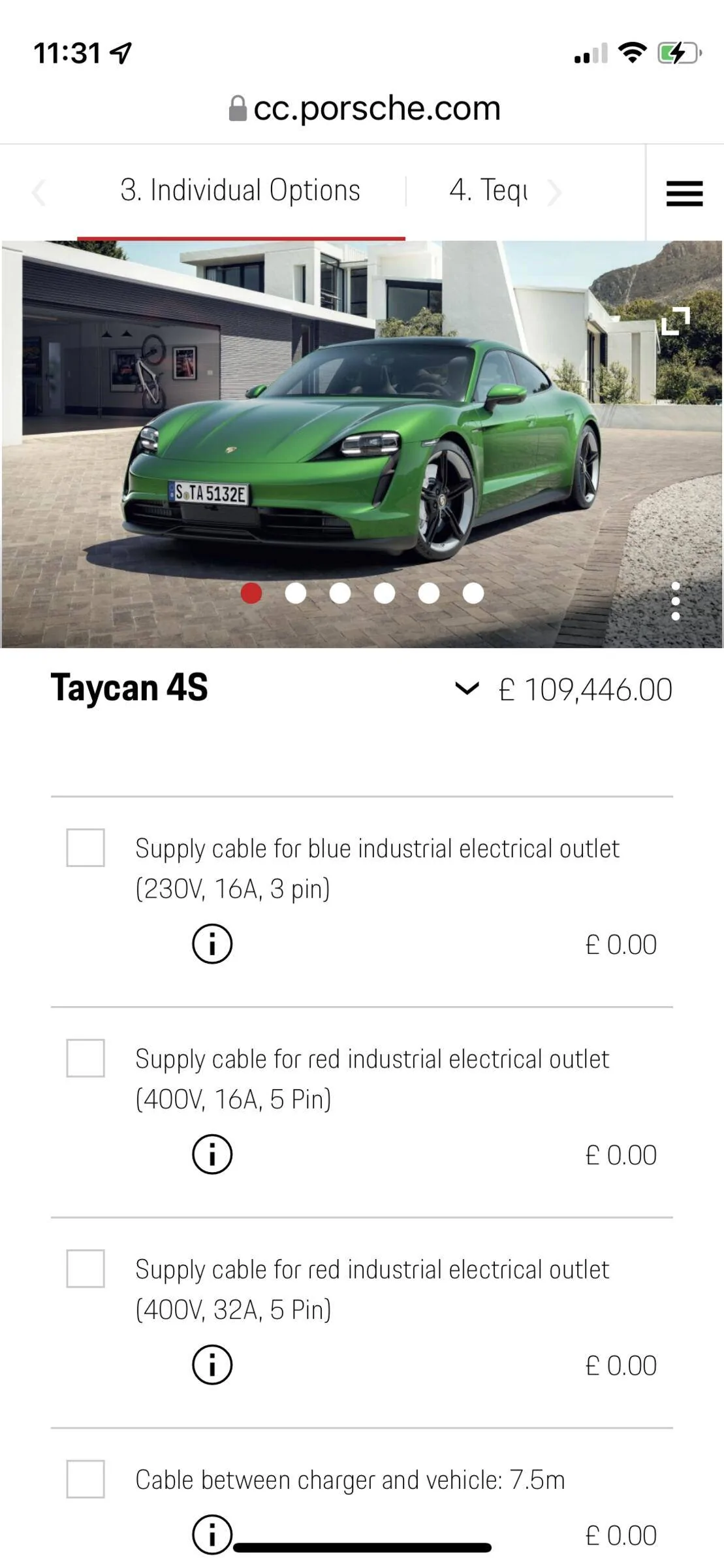

I'm in the UK and looking to install the mobile charger plus to charge my new taycan. My home power supply is single phase, not three phase.
Which of the following options should I choose, regarding cabling?
My electrician advised it would likely be the blue cable option, though he thought the current was a bit low to recharge fully overnight?
in theory 3.68kWh (don’t know if you’ll achieve that and whether the charger throttles back lack on the US circuit); so going to take at least 24 hours (depending on starting point and desired % charge)
93.4 / 3.68 will give you the theoretical 0-100 charge.

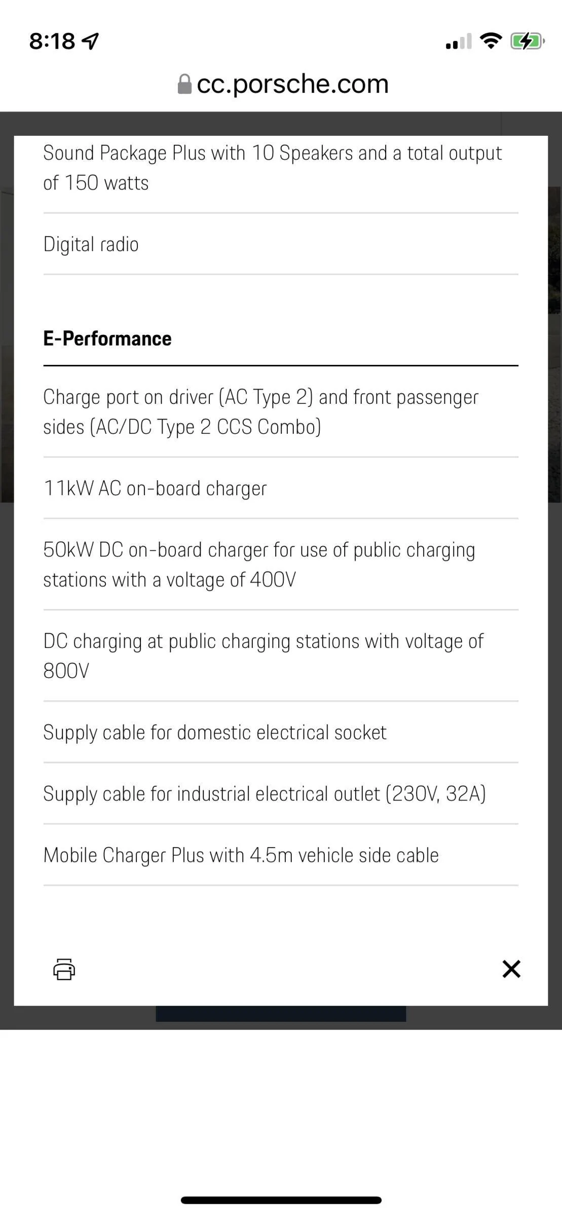

Isn’t there a 4th option that’s standard equipment, 230VAC @ 32A?
FYI, usable battery capacity is listed as 71kWh and 83.7kWh for the two batteries.
Yes, there is a standard option for 32A, I didn't notice this before! Thankyou.
