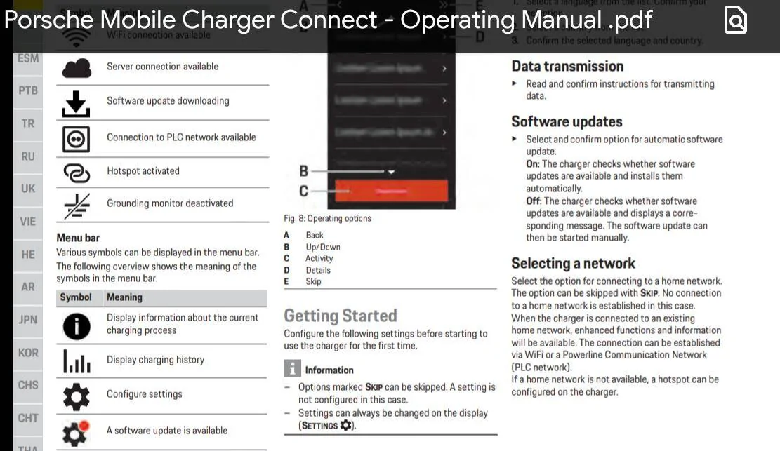

Page 10 of the manual explains the cloud icon and it appears that the software updates spoken of are for the charger but also the charger also offers a hotspot so you can configure the charger via your phone witout a local WiFi. This certainly is not your father's charger...
Page 10
Porsche Taycan Wifi in the charger? Screenshot_20200511-153535
Link to the manual
https://files.porsche.com/filestore...e-Mobile-Charger-Connect-Operating-Manual.pdf
The charger can be linked to a myPorsche account. This is one step in the system bring up, when you set it up first time. The config option however should also be somewhere in the settings menus. It presents a QR code that you can scan to get to the corresponding webpage.
from the manual how to scan the QR code
"- Using the Porsche Connect app (My Account > Charging cables & devices > Scan QR code).
– Using the camera on your device (iOS 11 or higher, different for Android)."
When it is connected to the Internet via Wifi or Powerline/PLC network it will look for software updates. Additionally when you linked it to your myPorsche ID it will also upload charging session information to the portal and by this the data should get available in your connect app. There is no extra app for the charger. Only the Webapp you can use for configuring the device or download charge session data locally to your PC.
You can also configure an additional PIN code that is only usable to unlock the charger for charging
When you bought an energy manager also you would need the Wifi/PLC connection too to integrate the charger and use the smart charging features together with the Taycan, like tariff driven charge profiles or simply a blackout protection when the overall power consumption in your house reaches a critical level.
Hope that helps.
