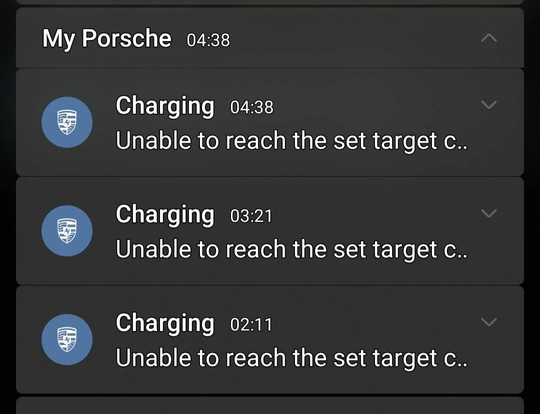

I always had issues with my car and Octopus IG.
I would get lots of error messages (see pic) and in the morning it would usually be short or over my set charge.
Or had not activated at all.
It was down to the poor connection with the car where we live. Vodafone signal is non existent here.
Sometimes I would get dozens of these messages - starting as soon as it plugged in.....even if it only needed say 10%, 10 hours later.
I had to work round it just using the EVSE timer instead.

Fish Fingers
Feb 20, 2021
50
2,548
3,308
Sold
Update: So I put in a timer for every day, which has an end time of 05.30am and plugged in last night.
Woke up this morning and it was not charged. The timer has disappeared and a new one has appeared. I asume Octopus has removed my one and added it's own.
So it seems that by adding my own timer doesn't help.
Looks like I don't have any other option but to plug in at 11.30pm if i want to only get charged the low rate. Quite inconvenient really.
That is how it works.
The Octopus one (called Enode) appears with a random time and replaces yours each time ypu plug in.
They actually advise not to use your own timers if using Octopus IG.
Then it will tend to stop and start a number of times overnight - usually in 30m slots reaching the set charge by 05.30.
It never worked properly in my Taycan.......the car would not pick up the instructions to start/stop and it usually ended up not charging, short charging or over charging.
It was a real PITA.
I had to work round it using the evse timer in the end.
