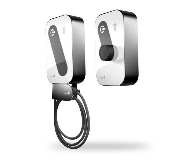

    I agree the EVA design is ruined with the fixed cable. The webasto look very interesting.
    If you want to go for a neat design I think the G5 from ETREL look really nice in both version, altough quite more expansive (I found a price aroud 1'750 €)
    http://etrel.com/products/g5charger/
