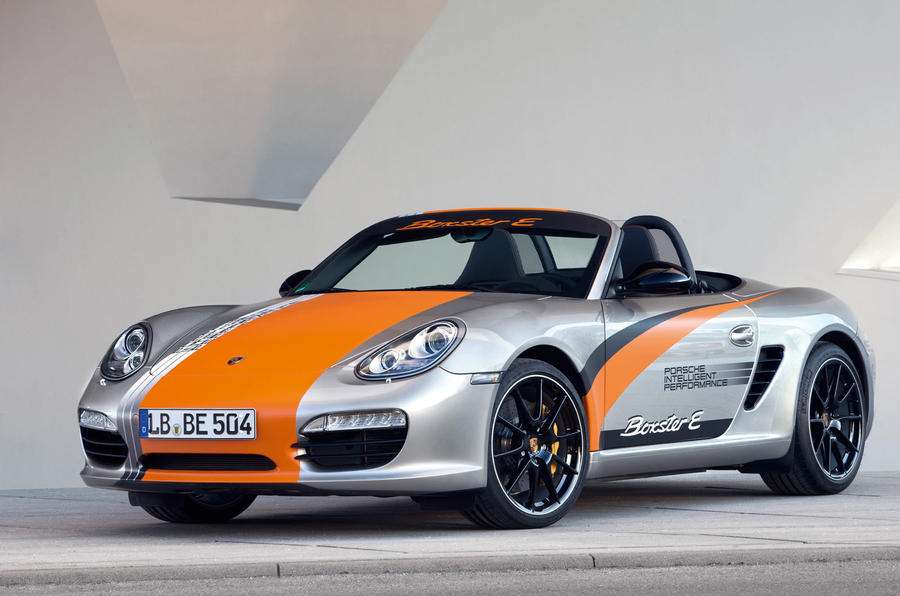

    From Cnet article on electrified Boxster and Cayman"
    "Porsche insiders citing studies carried out by parent company Volkswagen say they anticipate a rapid evolution of lithium ion cells for an improved energy-to-weight ratio in the next generation of batteries. Estimates are that cell energy density both by volume and weight will increase by 25% from 2019 to 2025.
    BBWbD6S.jpg© Provided by Haymarket Media Group
    By 2025 they also expect the adoption of solid-state batteries to bring a further increase of 25%. This would allow Porsche to pack more energy in the same space with no additional weight penalty.
    A £76 million investment by Volkswagen in QuantumSc"
