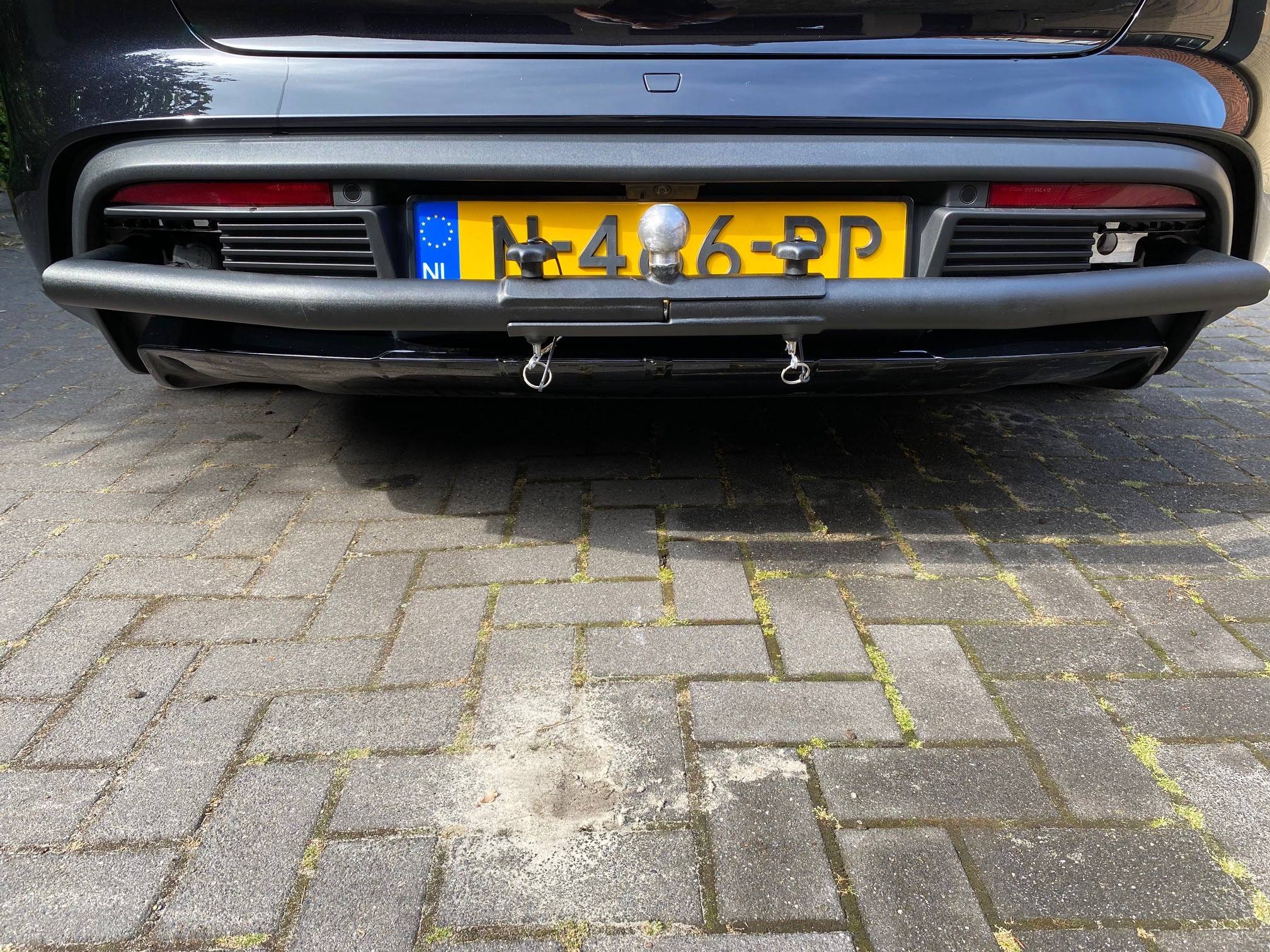

When I ordered mine in September 2021 (it was delivered in December 2021 due to a slot I could get because of a cancelled order two days before I made the deal with the dealer) I knew I needed a way to take our bikes with us. We have been doing trips to the Alps for 2 years with our previous Tesla Model 3 and when I bought that one it was still possible to get a hitch straight from the factory. Yes consumption is high with bikes on the back but we never had any problems with range.

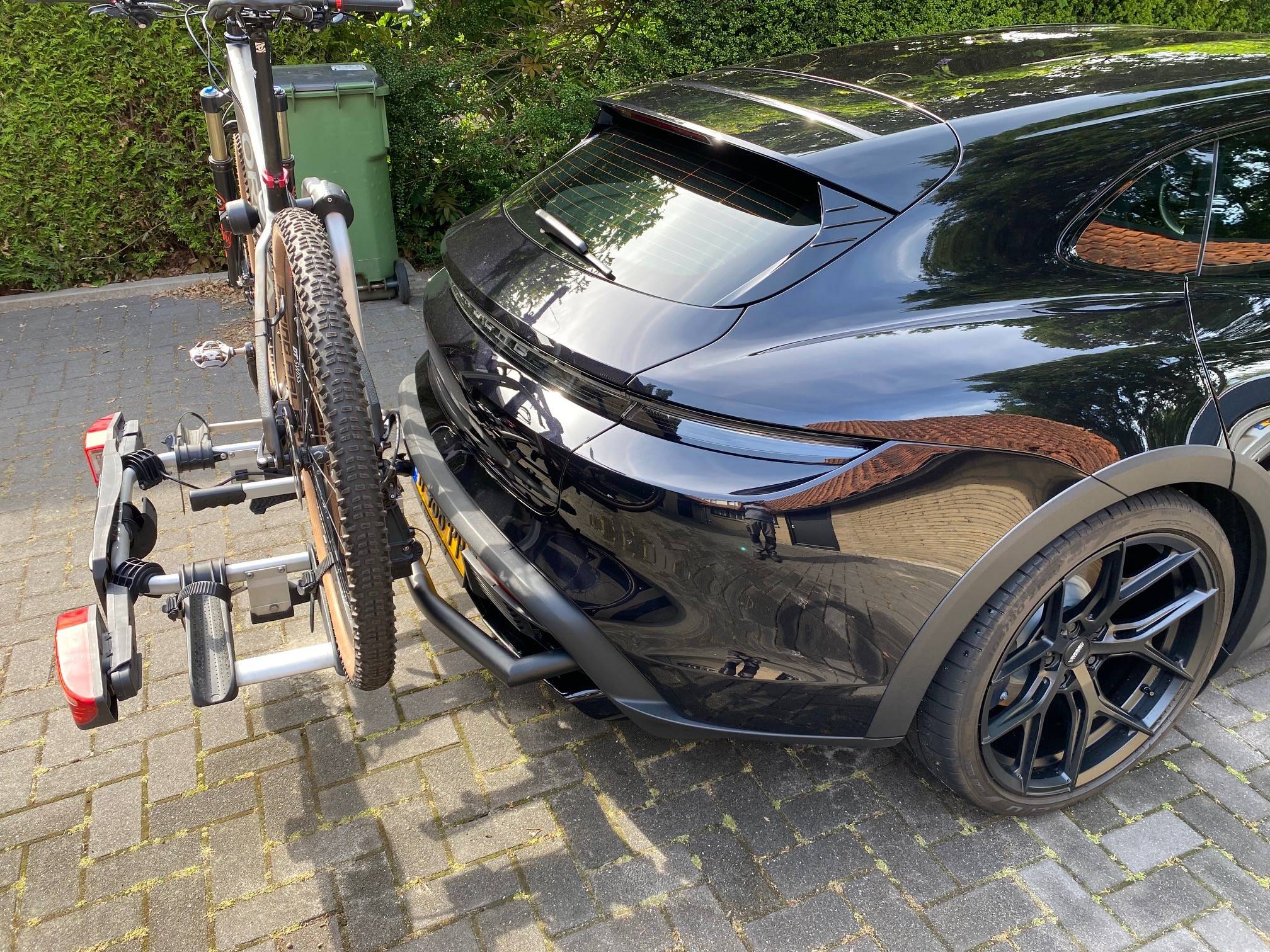

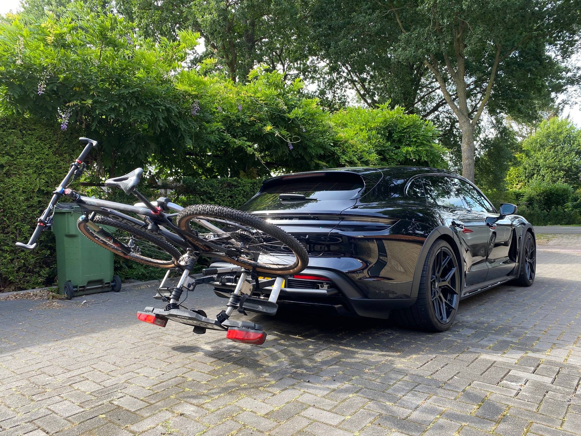

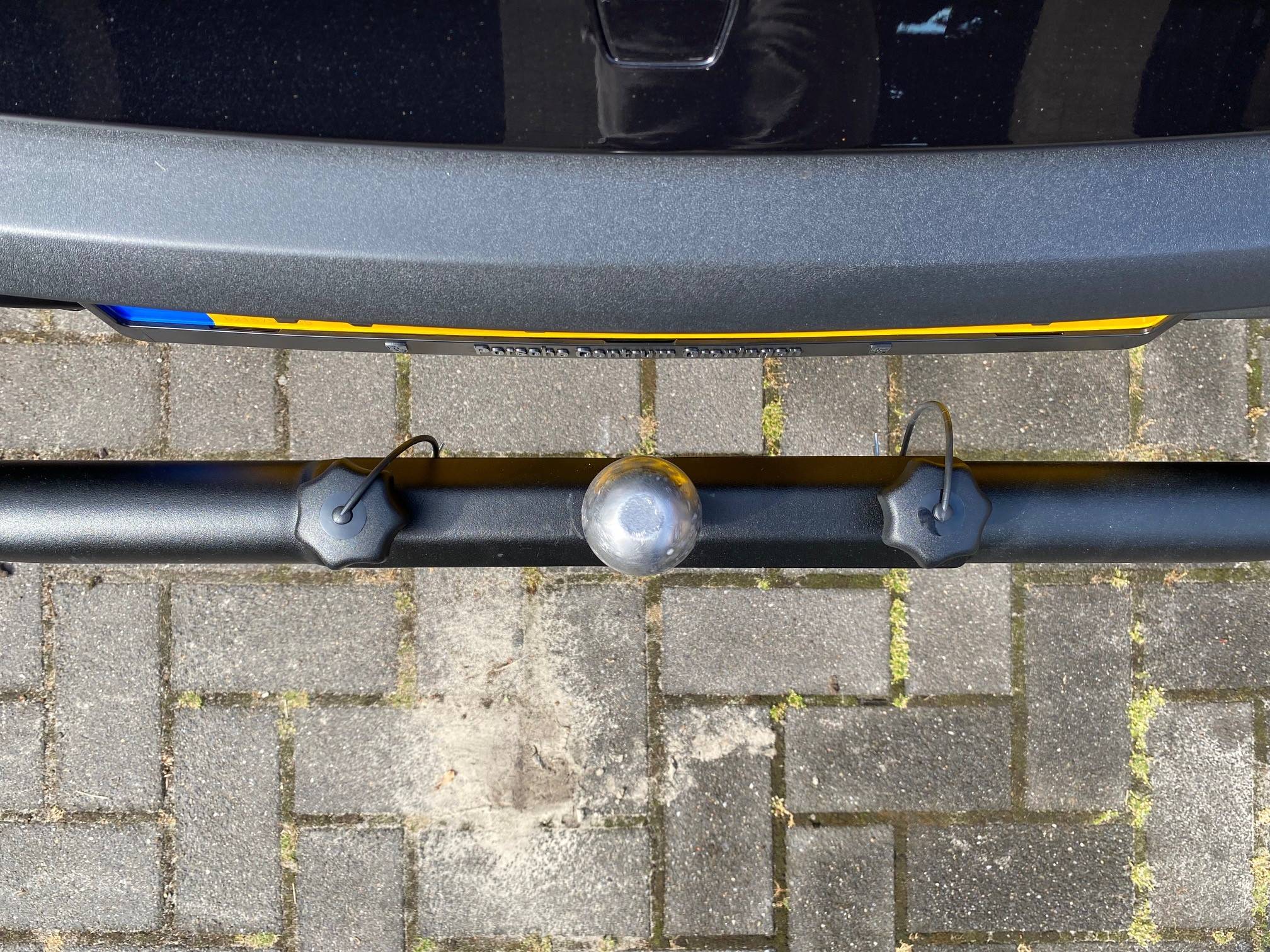

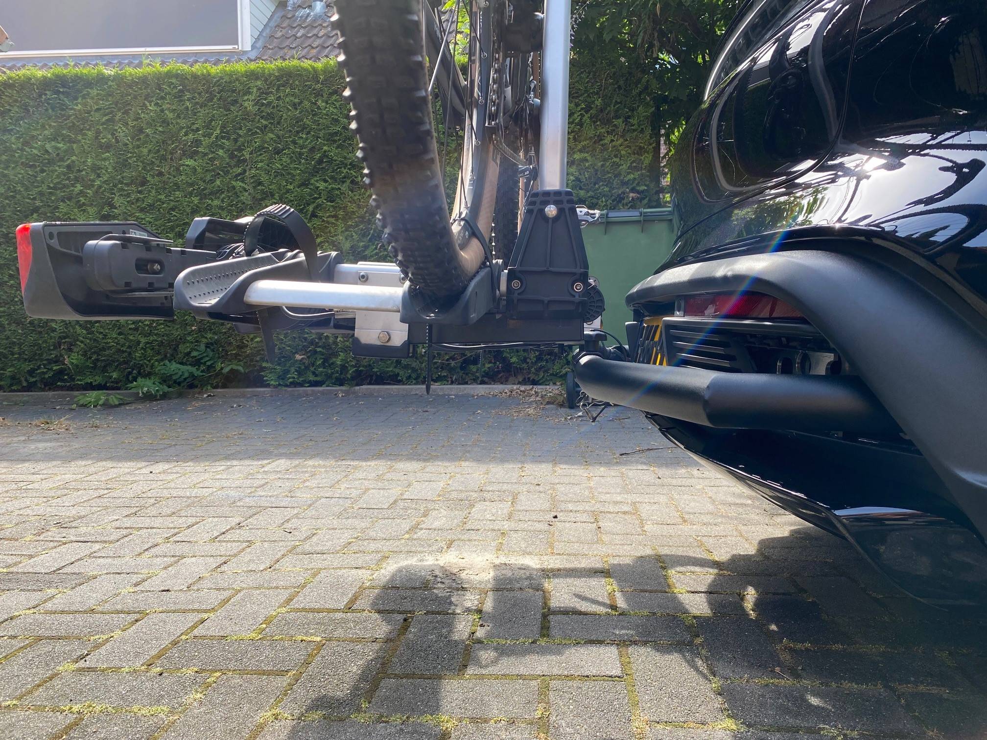

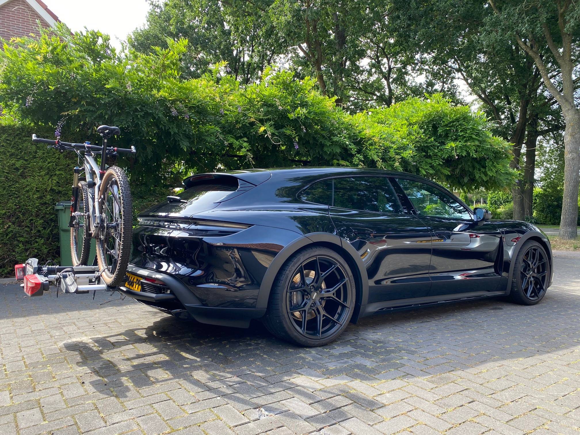

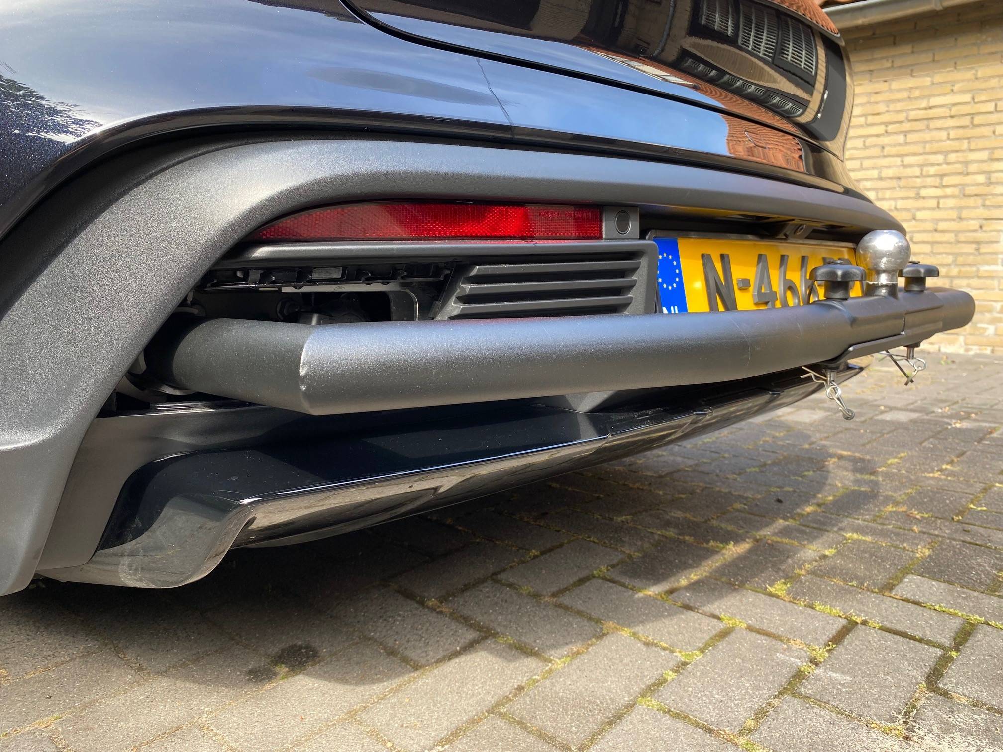

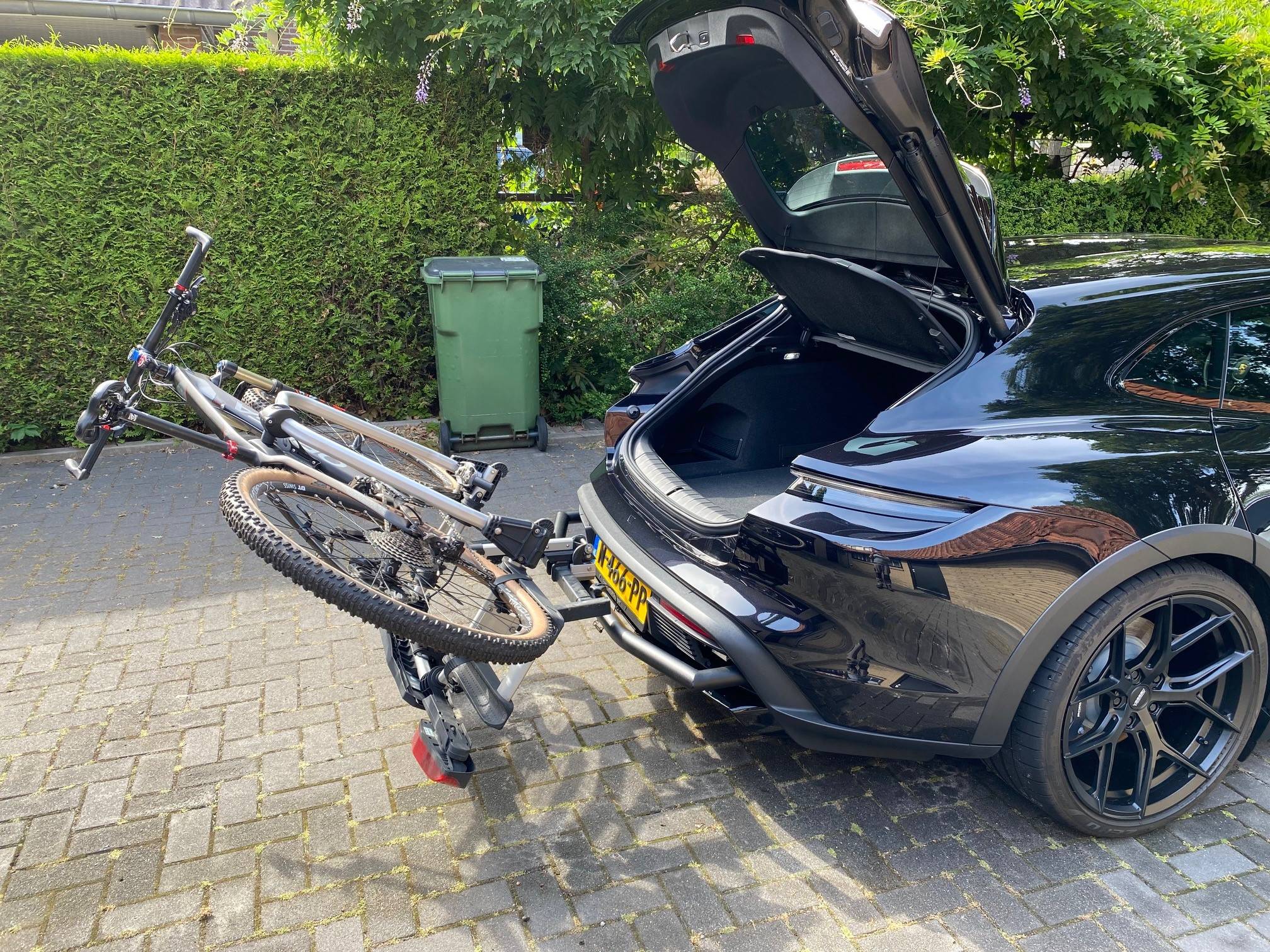

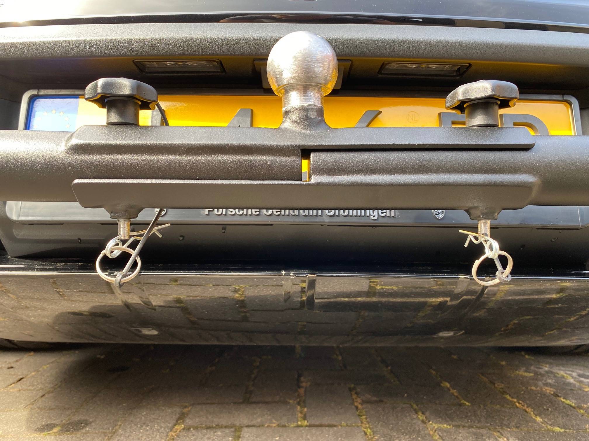

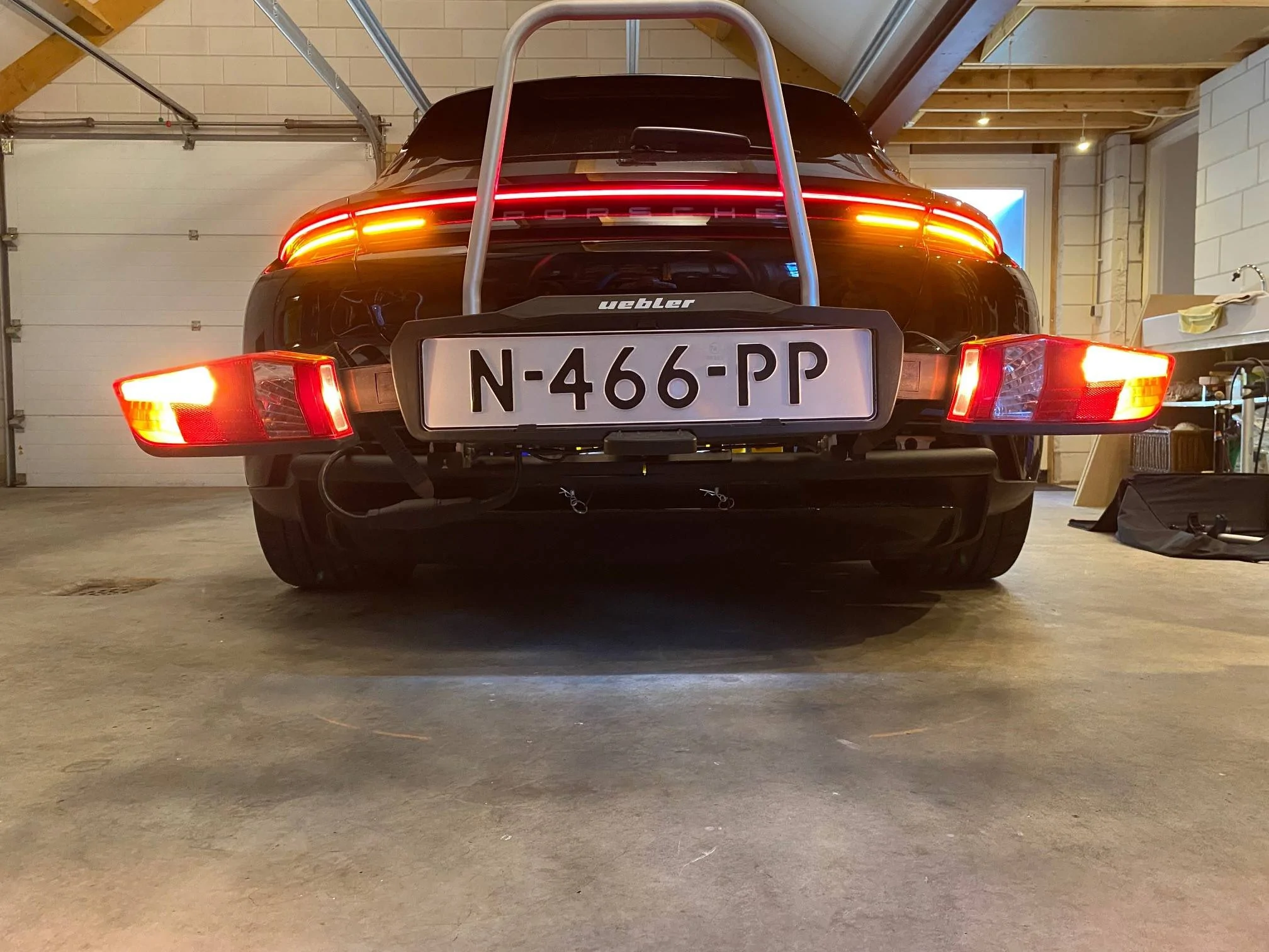

My dealer told me about the super nice bike rack but let’s be honest…. € 2700,- for a bike rack to replace my already great, foldable rack seemed a bit to much. I have been reading all the threads on this forum but up until now, most solutions are not what I had in mind. I was looking for something that looked completely OEM. I started out with a simple idea and brought that to a business associate who owns a metal factory. After a lot of test fitting etc. we came up with this design. It is double powder coated so it can take a beating. It's just as stable as an original hitch on a normal car and in my opinion looks great. It does everything the OEM Porsche rack does for way less money.

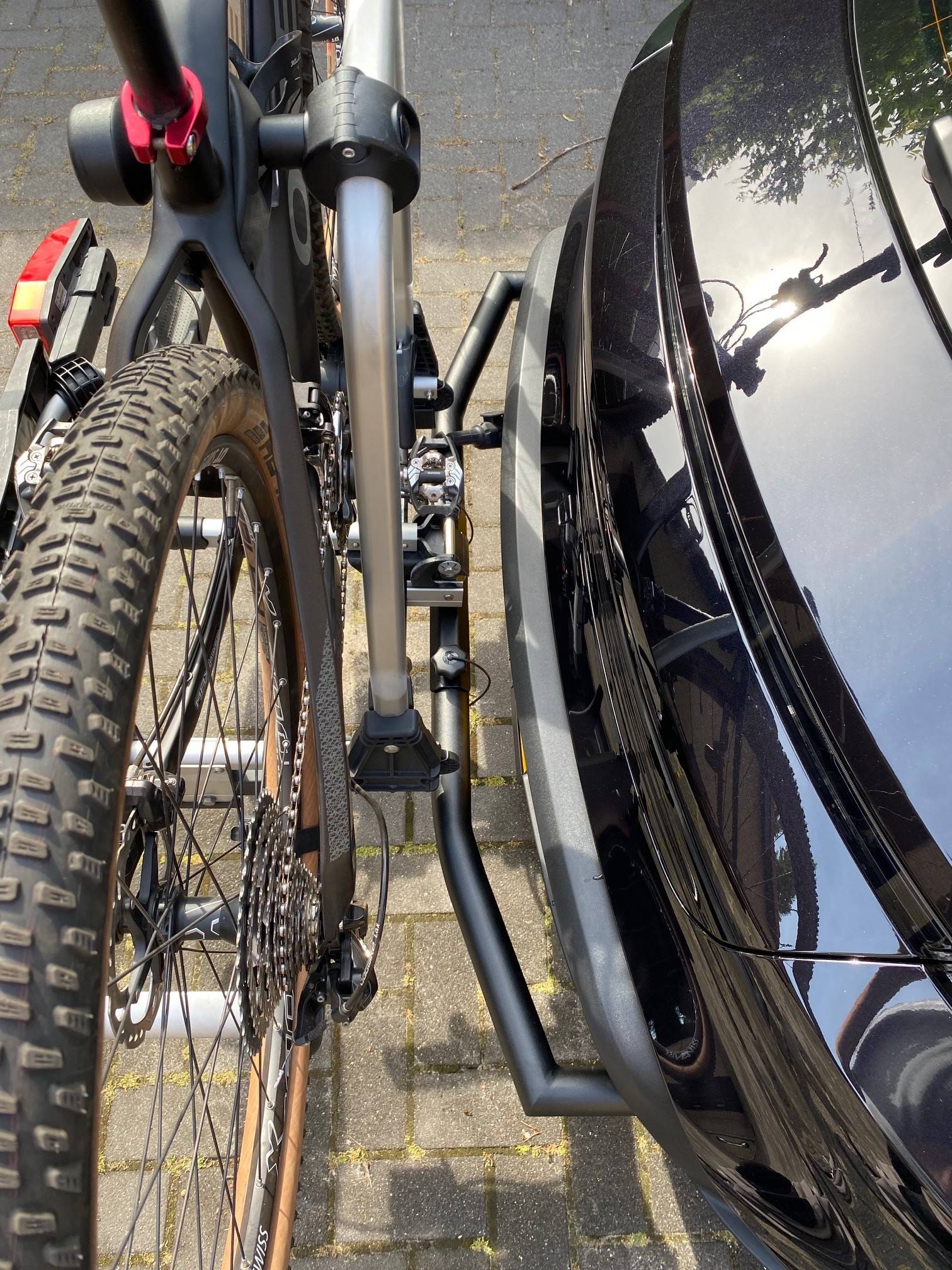

Nice job well done indeed - bar looks sharp.
Any side to side motion with the std hitch mount? - probably no more than usual I'd guess.
I do like one aspect of Will's (forum mbr) design that I purchased here in the US in that the 'boxed' rigidity of the 1Up trays on two poles does provide for the most stable platform on any car setup I've had to date - but this design is excellent too and would in fact be very easy to attach addl. stabilizers if needed.

This looks fantastic. Very clean. Any thoughts about a hitch receiver on this thing?

Hi,

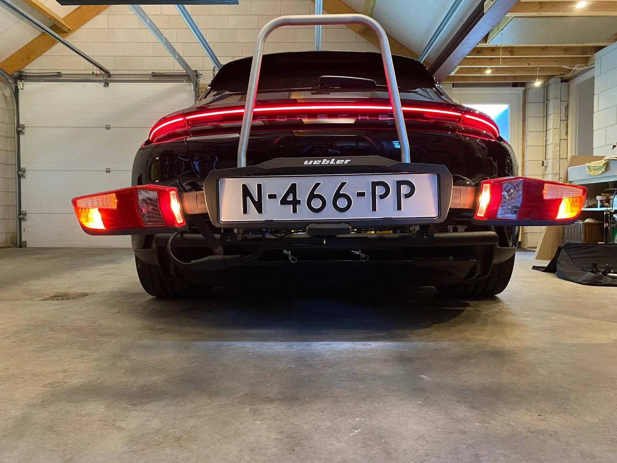

I Understand your concern but in europe this is the way to go with a bike rack. When this rack came out it was tested as one of the most stable racks out there. It performed best at high speed actions etc. It's the Uebler X21S made in Germany. Check this video to get a better idea on how it is mounted. It self levels when you put it in the hitch:

Could be possible but you have to redesign the bars. As you can see the hook is only a few inches away from the car. My understanding of the Hitch system you have in the US is that it needs some depth to insert it. So you would have to make the bars stand out more and weld the hitch reciever in the middle. But i'm sure it would work.

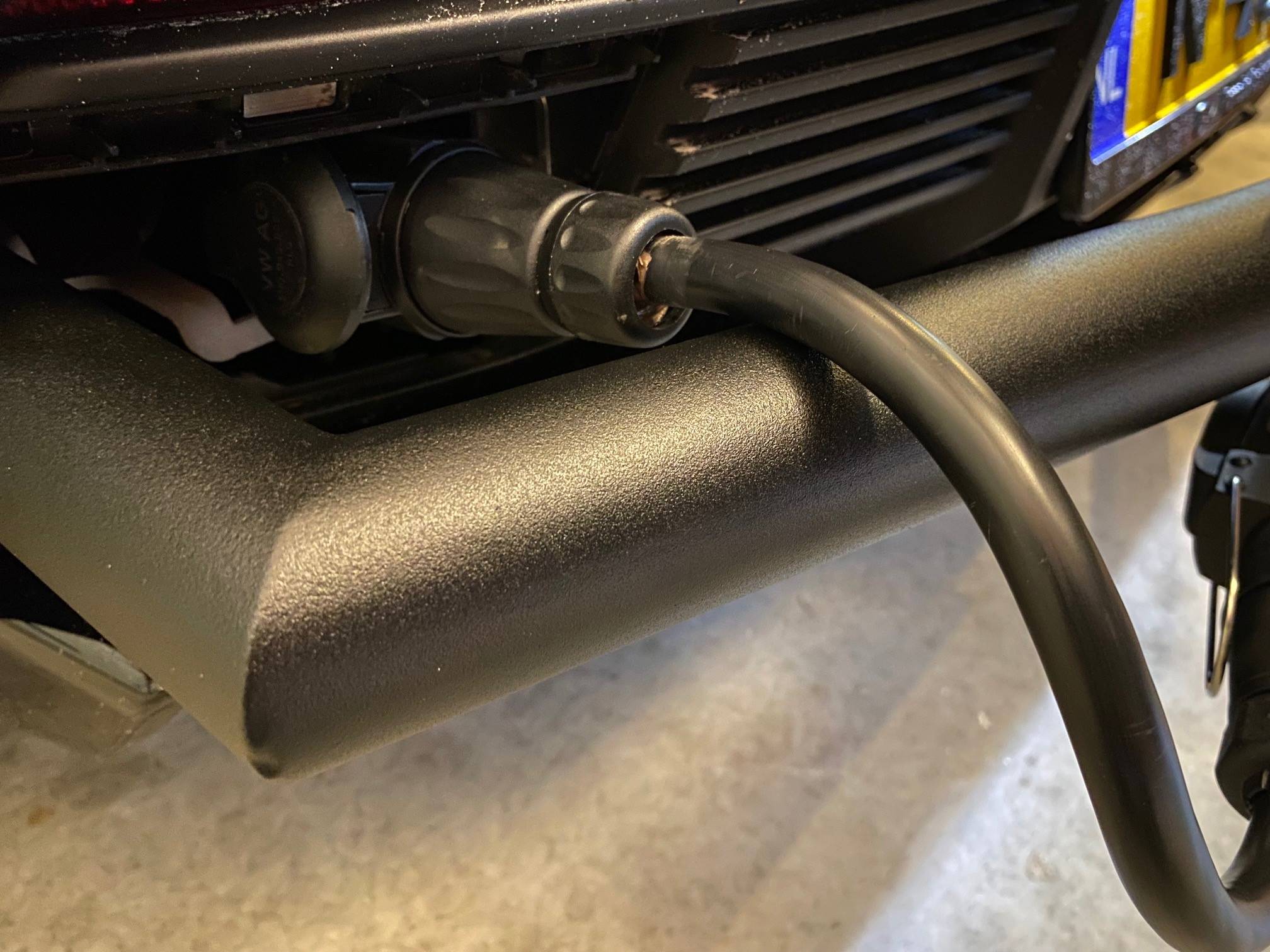

This looks fantastic and exactly the solution those of us with existing Thule towbar bike racks need. My one question would be about the electrical connection, can it reach to the side to be plugged in as they are generally next to the towbar so little reach required.

I have no plans on selling these but if you want info please feel free to ask. The factory is clossed at the moment because of the summer holidays. I will post the technical drawing ones I get it. In total this sollution has cost me € 883,- including vat. excluding the bike rack. So not cheap but much cheaper than the Porsche bike rack.

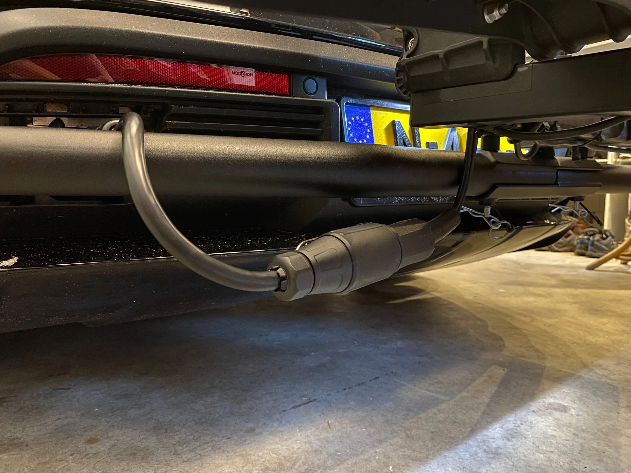

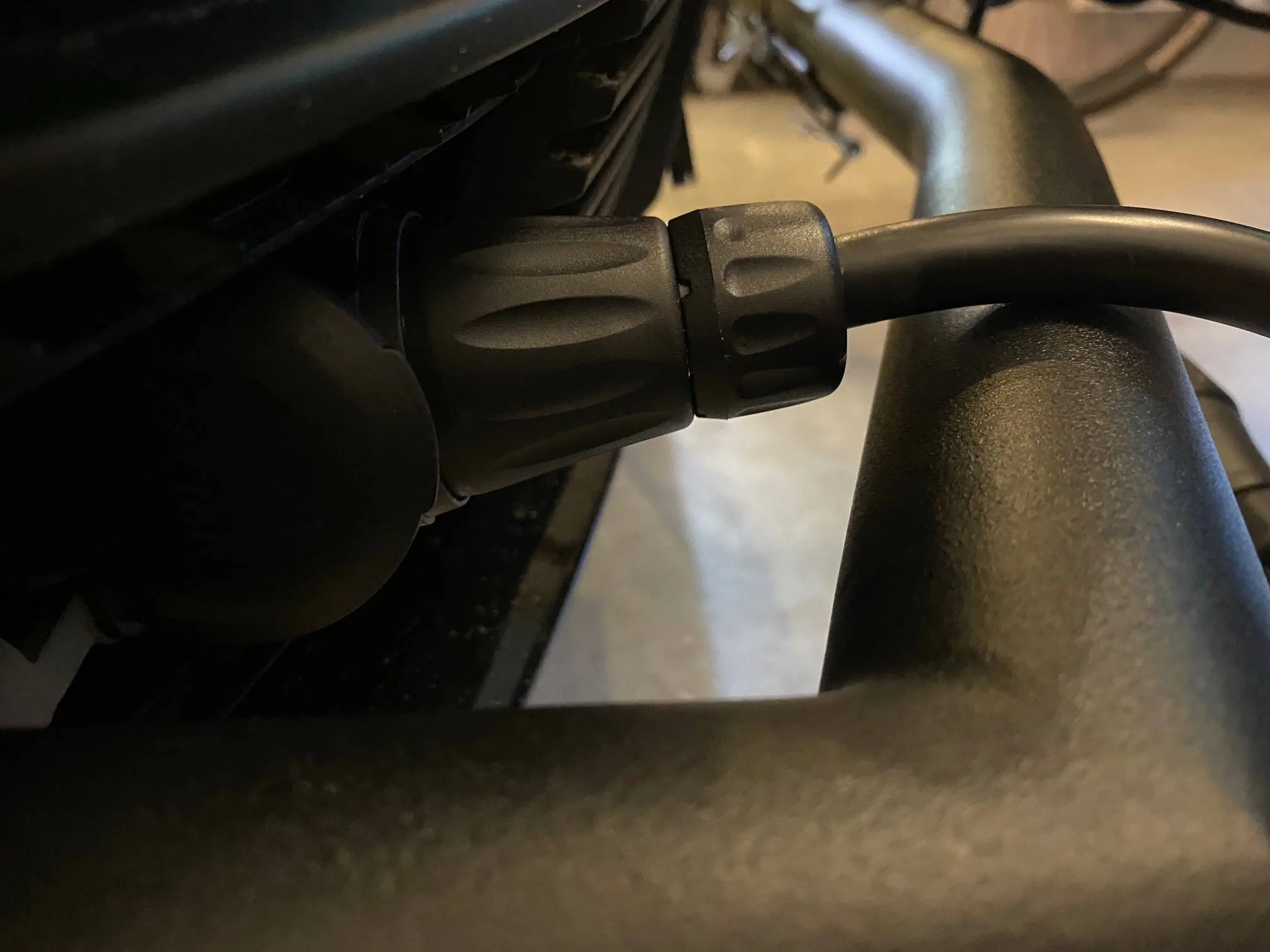

I had to make a small extension cord for the cable to reach the side. I have just finished it and will test it tomorrow. The plug for the extension is a bit bigger than I hoped so it is real tight. But it fits. I will post an update asap.

Luckily the extension cord works. That was no fun to make. In the picture you can see that the cable is resting on the frame for the rack but there is no stress on it. I sealed it with some silicone kit and will fill it up with some black kit to make it look better. Other then that everything is done and works perfectly.
