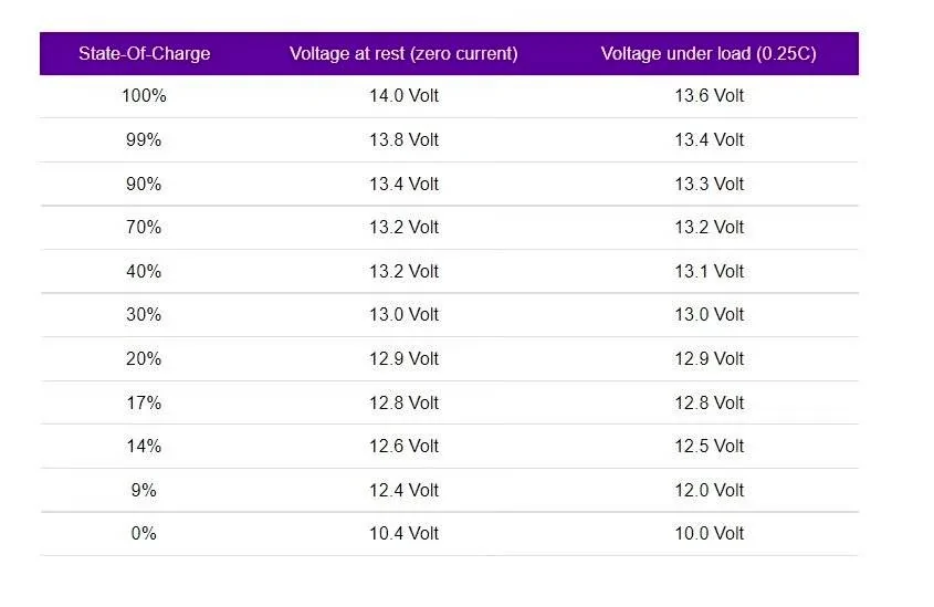

Nice table! Where did you get this from? Is this specific to the Taycan or for LiFePo4 In general?
If that table is accurate it means the car should trigger a charge whenever the battery hits 12.9V at rest (8A left)... 8 times before it gives up.
That also means that the voltage sensors in most dashcams (11.5V,12V,12.5V) are all useless. Battery will be long dead before it hits 12.5v
12.5V cutoff would not be too bad right, that would leave the battery at 10%... good for a few days more, maybe a week? (I don't know the draw of the car by itself)
You might be right. If I get the car before June and will be able to fit the dashcam/noco sense, I'll make sure to leave it standing as much as possible when I go on vacations in the summer to record what actually happens. By my math, it should last 7 days before the car harakiris. If it lasts longer, I'll be happy.
No idea at what level the battery "goes offline" though. I'm sure it has deep discharge protections.

I recently installed a bluetooth voltage meter and plan to measure this as well once I won't drive the car for awhile.. would be good to know how long it can last from 12.5v as the dropoff may be steep.
Ah, so silly the recharging is limited to 8 times :rolleyes: Please Porsche, make it 50 times or more with an OTA !!
