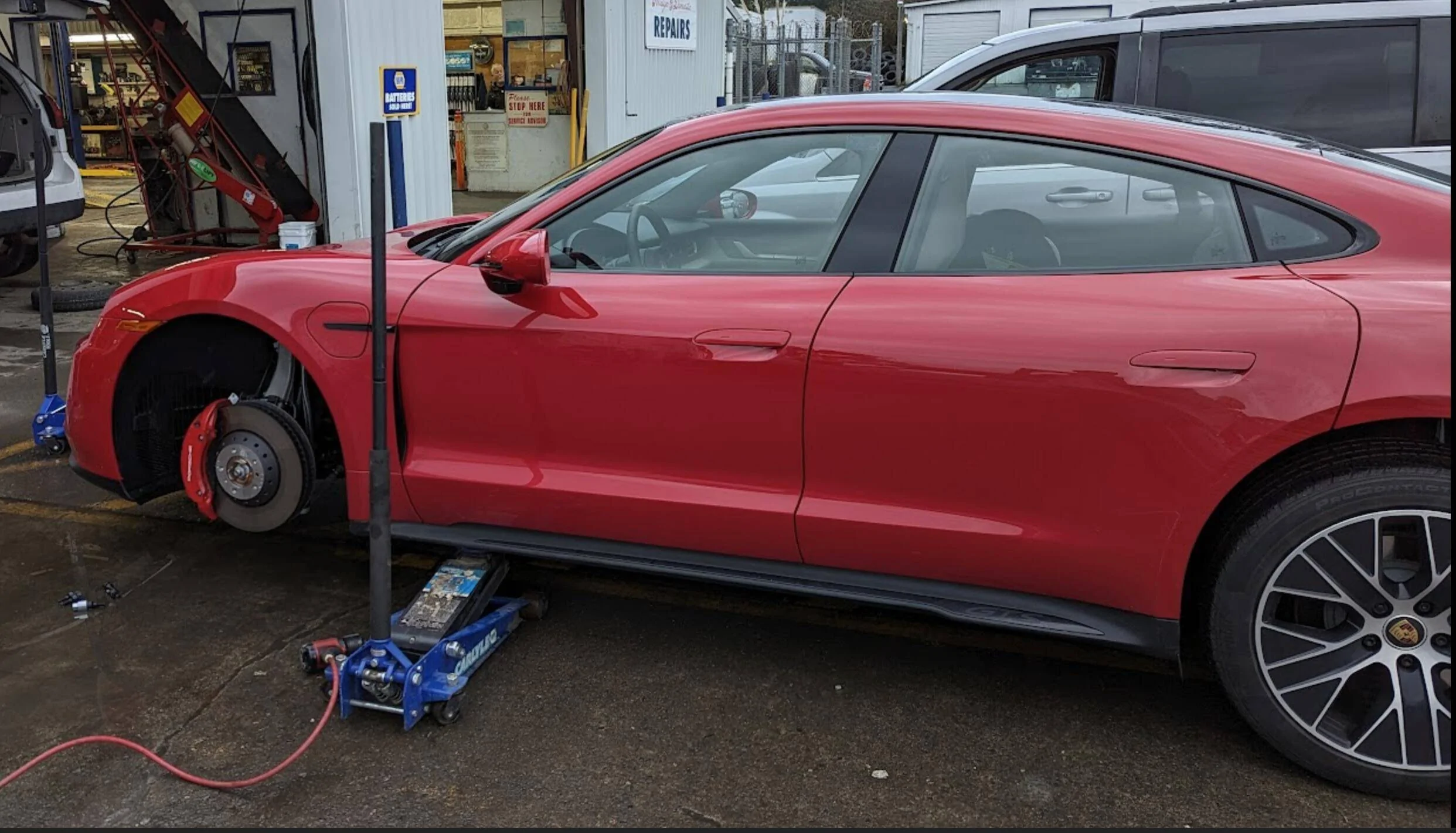

The Garberville, CA charger worked well -- we got ~100kW and charged within 30 minutes, but unfortunately picked up a screw in the front tire there. We discovered that leaving the charging station and pulled over. Luckily, the screw plugged the hole and I could use the compressor to get it up to ~30 PSI and it held (phew!). There was no signal there and the closest reasonable town was 70 miles away -- Eureka. We hoped the tire would hold up and were impressed that it did. I really didn't want to use the tire plug approach, but at least it was an option.
All the tire shops in Eureka were slammed and we had to wait a couple of hours, but they squeezed us in and patched the tire (we were lucky the puncture was right in the middle). We left for Crescent City at 4:30 pm -- much later than anticipated and hoped to make it to Bandon by 9 pm. Stopped at the Eureka Walmart charger and two of them were actually working (so don't necessarily trust the EA app!). We charged one more time in Crescent City just in case there was an issue at the hotel. Made it there by 9 pm and no one was using the only hotel EV charger (woot!). We had about 40% battery at that point, but it was nice to start the next day with a 90% charge.
Porsche Taycan PEC LA to Seattle, WA over 4 days/3 nights - Taycan GTS delivery trip 1672090258987
Here is the car at the tire shop. Still feel lucky it wasn't worse!

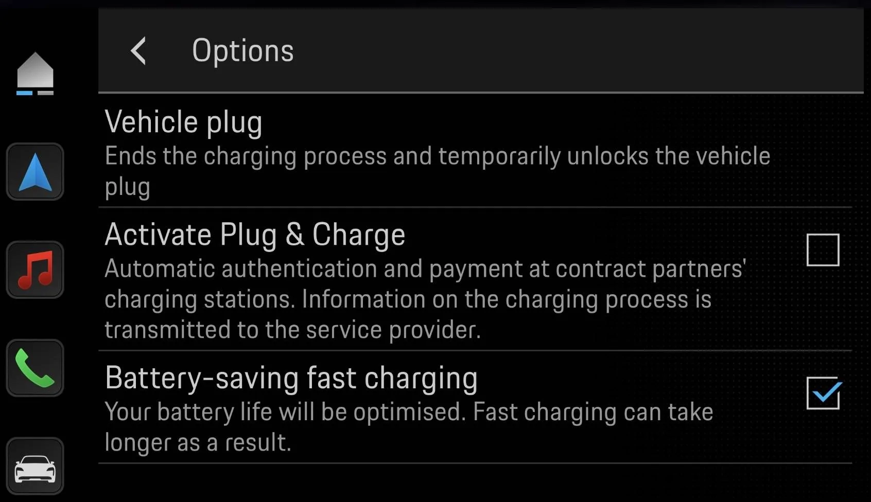

Thanks -- it's always interesting to read about long distance Taycan adventures. Regarding the limited charging rate, was battery saving enabled in your PCM?

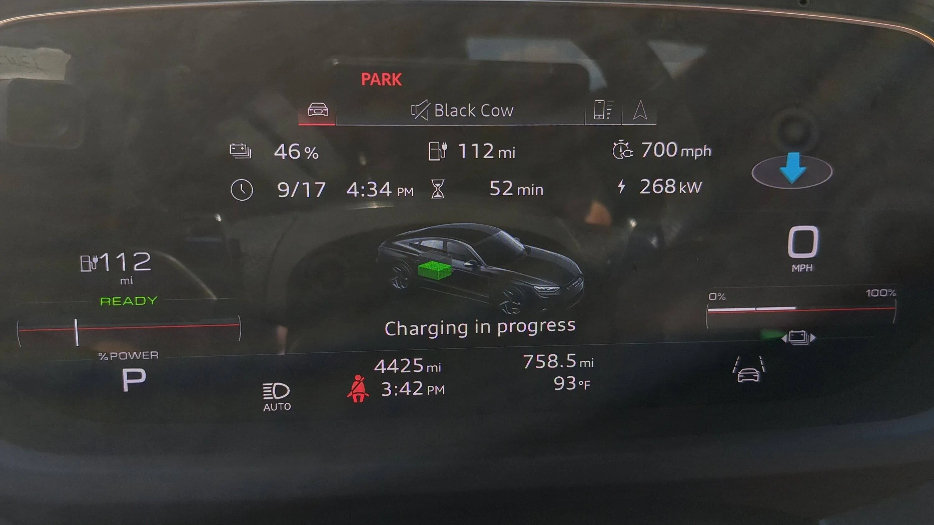

First, @foofighter -- congrats on the Taycan purchase. Congrats again on the long-distance delivery. We just did a 5,500mi round trip from SC to MD to AZ to SC.
*NOTE* I don't have a Taycan, I have an e-tron GT. But, still.
Now, in regards to charging speeds, did you use Carplay/Android Auto for navigation vs the Porsche built-in Navi/route planner? I see that you used ABRP to plan stops. I do the same in my GT, but I actually plug the charging stops recommended by ABRP into the built-in Navi as waypoints/stop-overs (because the built-in route planner isn't the best at choosing only EA stations).
The car won't precondition the battery when we use CarPlay/Android Auto vs the built-in route planner, at least that's been my experience. Once I started using the built-in Navi, I almost always get 268kw+ all the way to 50% depending on the SoC when I arrive at the charger.
Porsche Taycan PEC LA to Seattle, WA over 4 days/3 nights - Taycan GTS delivery trip PXL_20220917_194234715 (1)
So, again, congrats on the purchase!
Let us know if you used the built-in Navi or CarPlay/Android Auto. This will also make the difference in your charging speeds. Even on a 150kw stall, if you use the built-in Navi you're likely to get 170kw out of that stall provided it's working as advertised.
--Nick
Good point! We do have this turned on, which probably explains why we only got ~200kW at most.

Also, I had deselected, "Battery-saving fast charging" to get the fastest speed.
Thanks for this. I had that ticked on during a 5000 Km (3106 Mi) road trip from Collingwood to Treasure Island Florida in November. Going to Florida again in February will make certain this box is left Un-Ticked.
