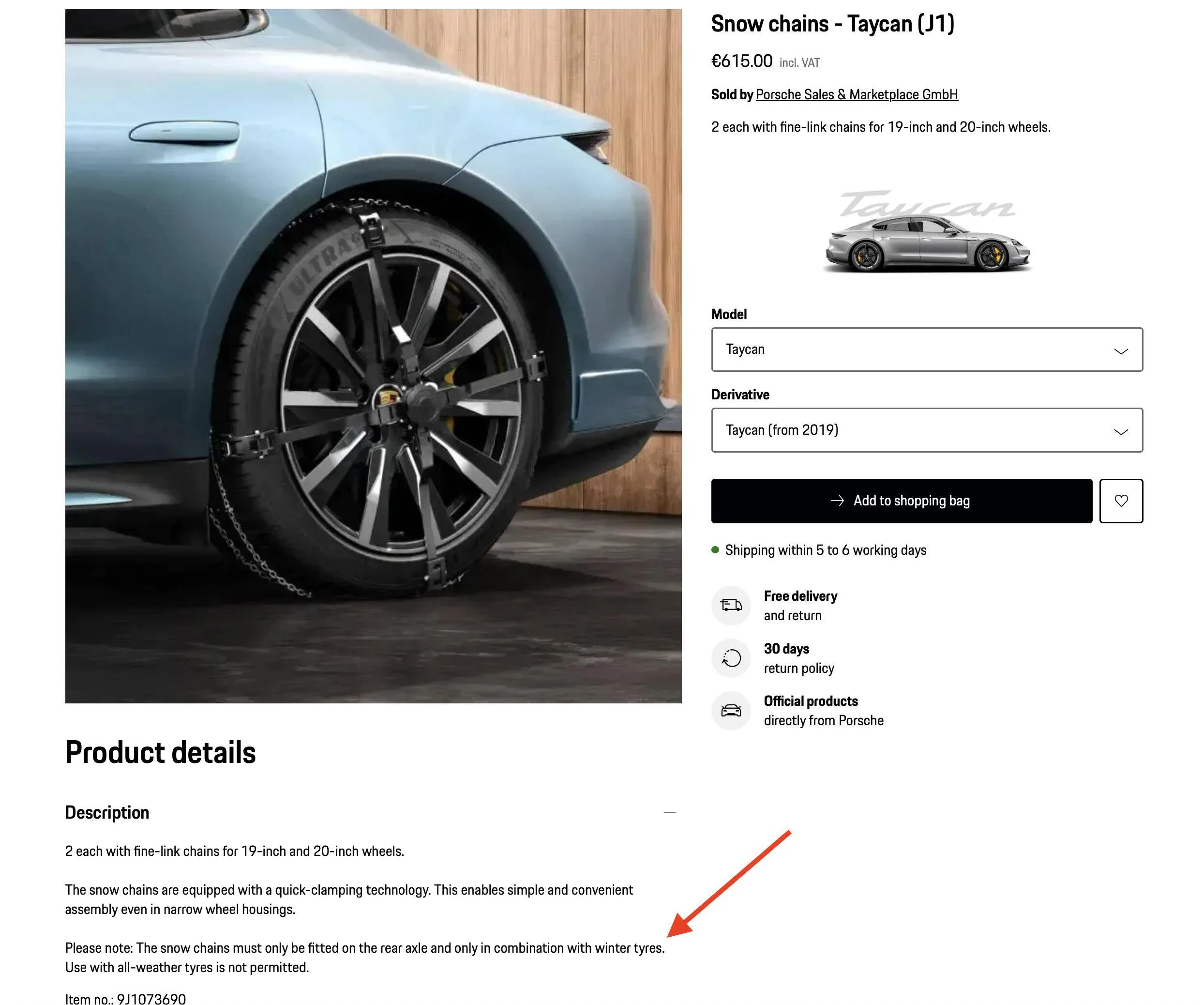

Wondering if I can get away with my summer tyres and just carry snow chains…hmm food for thought.
None of the NF0 summer tyres are rated for use of snow chains – only the winters.

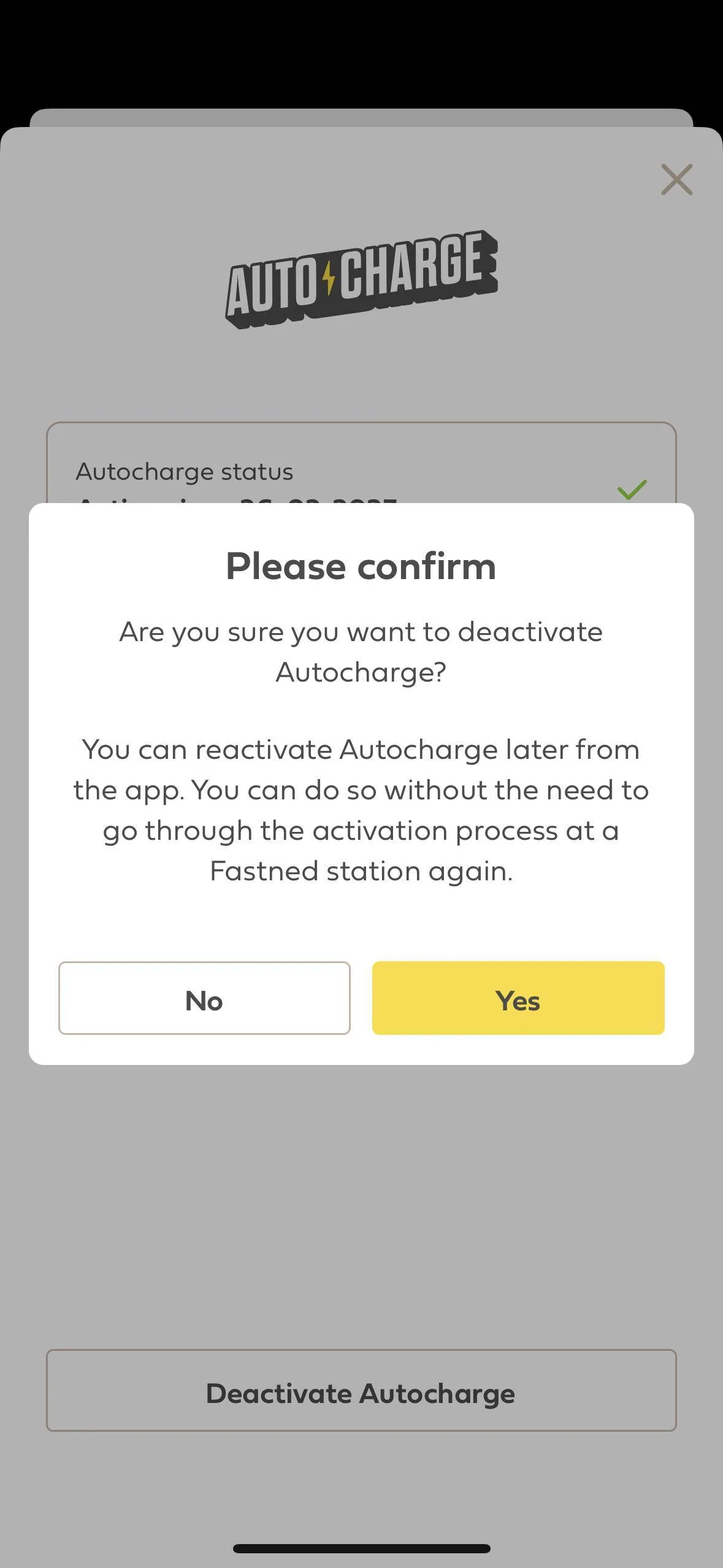

It does when you activate plug and charge for Fastned. Then you pay the Fastned price. With the Porsche card at Fastned you pay less. Fastned plug and charge is really fast and easy to use. Faster than Ionity

You can activate plug and charge in the Fastned app. But you pay Fastned price.

Very interesting info, have just booked a hotel in Gstaad, Switzerland for a few days in the week before Xmas, will be travelling down from West Lancashire via Eurotunnel. Thinking might travel down and stop ver in a hotel near the Eurotunnel and set off early am on to the train.
Winter tires are not legally required in Switzerland, like in some French alpine regions. However if you are in an accident you need to prove your car was road worthy. And with summer tires in the winter you are not. Plus what @tigerbalm mentioned about chains. And I would never drive without winter tires in snow and cold wheater.
And I have the Fastned mac based plug & charge activated. I never did the maths and didn't appreciate that Porsche Charging Service prices actually won out in that case. I think based on this, I'll de-activate Fastned plug & charge in the app and tap the Porsche card next time I'm there.

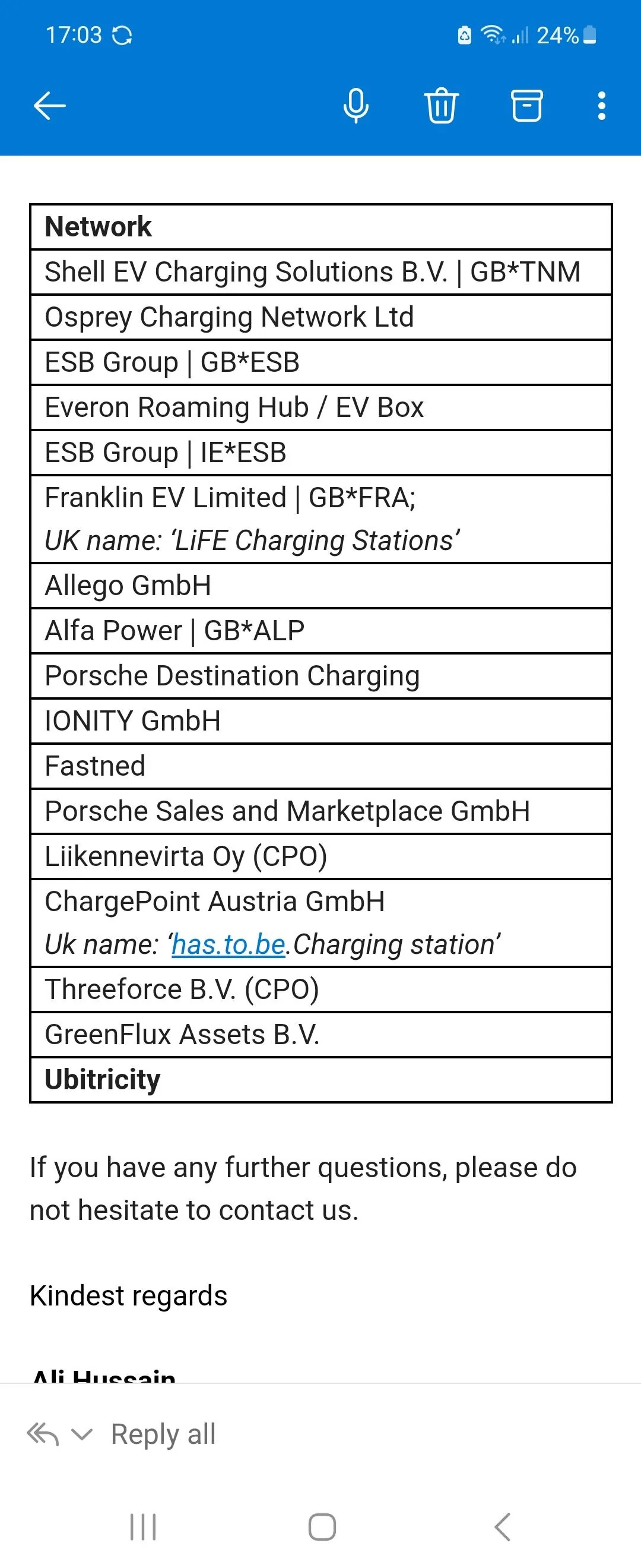

It's a little annoying that Porsche Charging Service doesn't have a clear list of the networks they support.
I agree, it should be freely available. However, when I asked the question, Porsche UK helpfully sent me this list of networks compatible with the Porsche Charge card. View attachment 58920
Porsche Taycan Road trip to France (Taycan GTS Sport Turismo) Screenshot_20230725_170350_Outlook
