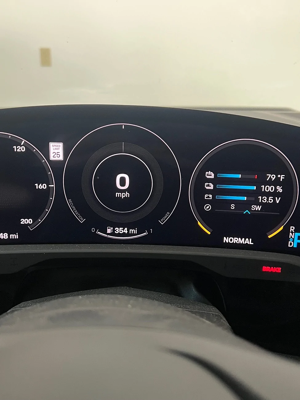

I normally charge to 85%, but went to 100% for a recent trip to the airport ~2 hours away. Got my best range number yet on my 2021 Taycan RWD - 354 miles!
I’m so jealous! I have the original battery so I get 225 miles max. I wish I had the bigger battery but since I only use it local, around town I really don’t need more than 200 miles. My next Porsche EV will need to have at least 400 miles so I can use it on longer trips reserved for my other ICE vehicles.

My car's range is not even remotely accurate. On this charge, to 80%, the car showed 220 mile range.
It's now down to 25% showing 63 miles range (suggesting 252 mile range) but the car has only traveled 105 miles. If I had 63 miles left then my range was only 168 miles vs the indicated 220 miles.
I'm showing 2.6 miles/kWh on this charge.
Burning 55% of the charge to cover 105 miles suggests a range of 190 miles.
Big battery, 10K miles, 21 4S with 21" wheels. Drive like grandpa in range or normal mode 99% of the time.
I see a lot of threads about amazing range; I don't get it...
This is why it's best to stop obsession about range guesstimates. Just look at %, the way you do with a phone (which doesn't try to guess battery life in hours, because that would be dumb).
Percent is always completely accurate. And if on a long road trip do a plan first then stop as planned or when it gets empty.

I always thought this estimate reflects recent efficiency.
I typically don't look at overall range but more at the mi/kwh figure. For a j1.1 PB+ car, anything above 2.9 mi/kwh is materially above published estimates. On recent road trips, I was able to consistently achieve 2.8 - 3.2 mi/kwh (243 - 268 implied miles).
