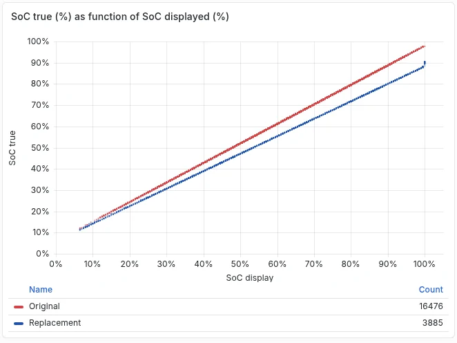

Looking at the correlation between SoC Display and SoC "true"* for both batteries:
Porsche Taycan 🔋Analysis of J1.1 with original battery and with .2 replacement 1781696251869-co
[C6. CHRGR] SoC True in Car Scanner or BMS_SOC_HiRes in Porsche telemetry. SoC HR in Car Scanner is low-res of SoC true.
Original: SoC_true = 92%*SoC_display + 6%
Replacement: SoC_true = 82%*SoC_display + 6%)

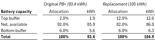

This tells us that the battery capacity is allocated this way:
Porsche Taycan 🔋Analysis of J1.1 with original battery and with .2 replacement 1781700429023-zh
I believe the % allocated and energy available is slightly higher (~86.6-87.0 kWh) than shown here due to %-rounding and such.

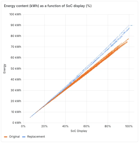

Energy content
Reported Energy content (kWh) vs SoC:
Porsche Taycan 🔋Analysis of J1.1 with original battery and with .2 replacement 1781696494800-o8
Spread for each battery and between the two batteries due to difference in SoH.

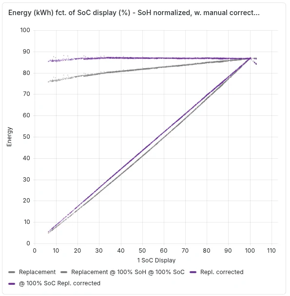

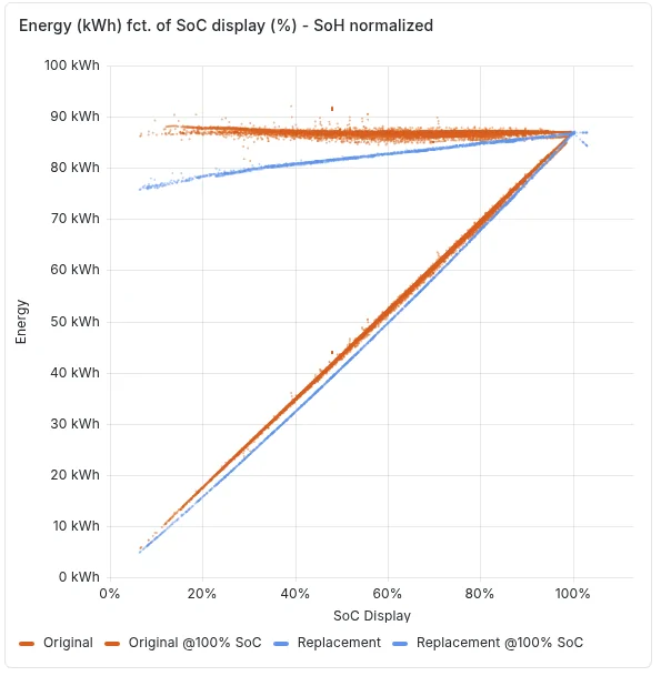

Normalizing Energy to 100% SoH cleans it up:
Porsche Taycan 🔋Analysis of J1.1 with original battery and with .2 replacement 1781696509058-b3
- Energy normalized back to 100% SoH (Made a separate post on SoH readings for J1.2 BMS)
- Numbers converge on 86.5-87.0 kWh at 100% for both batteries.
- Normalizing to 100% SoC shows a mostly flat curve for the original battery, but not for the replacement?
Non-linear energy/SoC curve for the replacement battery:
Porsche Taycan 🔋Analysis of J1.1 with original battery and with .2 replacement 1781696499863-
- Appears as if new battery reports only 88% of energy at ~0% SoC but converges to 100% at 100% SoC
- Divide by 88%+12%*SoC gives a perfectly linear function
I believe the Energy (kWh) is used by the GOM (range indicator) so it has driver implications. See two options:
  1. Intentional to add some buffer at the low end of the charge (do we see it on J1.2?)
  2. Mistake in adaptation for J1.1
I'm leaning towards 2. as I doubt Porsche would make the GOM less accurate and because the numbers fit perfectly with max Energy content in the J1.1 implementation (88%).

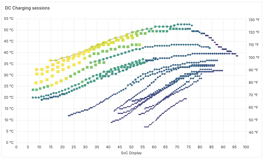

Fast charging statistics
Below chart shows individual charging sessions as a function of SoC and Battery temperature. Color indicates max charging power indicated by the BMS. Yellow color (and largest point sizes) indicates max (335A). New battery sessions are square, old battery round.
Porsche Taycan 🔋Analysis of J1.1 with original battery and with .2 replacement 1781702922356-0q
It can be a bit difficult to interpret, but there does not appear to be any difference in fast charging performance.
  • Max charging power remains ~270 kW (335 A)
  • Lowest temperature for max continous power I have achieved with the new battery 32C@8% SoC
Mostly as expected? As I understand it, most of the temp/SoC charging improvements are from the new heater. No improvements in peak from beefier bus-bars, but there are probably more constraints?
I don't have data for more than one proper fast charging session with the old battery so I'm not sure exactly where the temperature cutoffs are on the J1.1.
Will add more details around charging later, for now here is link to two sessions with charging limits, temps, etc.:
DC session (new batt.)
DC Session (old batt.)

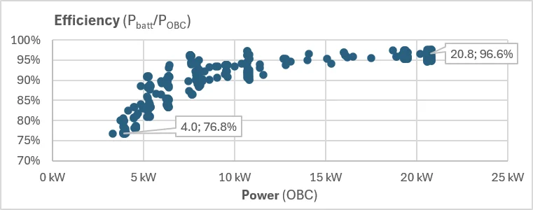

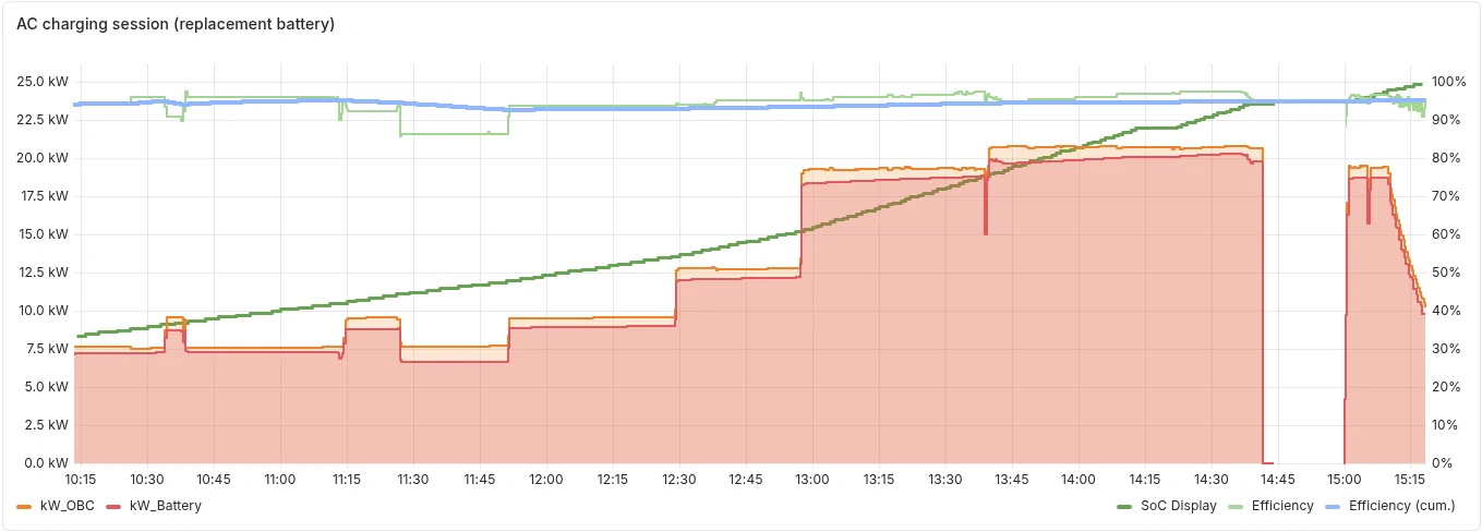

AC Charging
Maybe not the most interesting, but here is a typical AC charging session.
  • 22kW on-board charger (OBC)
  • EU: so 3 phase 230V/400V @ 32A
Charger is in a parking garage with 25-50 public chargers that are power limited in the morning when all are in use. Limit is then increased during the day as demand drops off.
Shown is power into OBC and into the battery - and their ratio (efficiency):
Mapping efficiency as function of the power draw of the OBC (4 dates):
For the 22kW OBC ~95% efficiency @ >10-11 kW, but drops quickly at low power levels
(It's typical that efficiency drops below nominal power, so may be different for the 11kW)

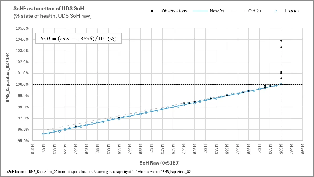

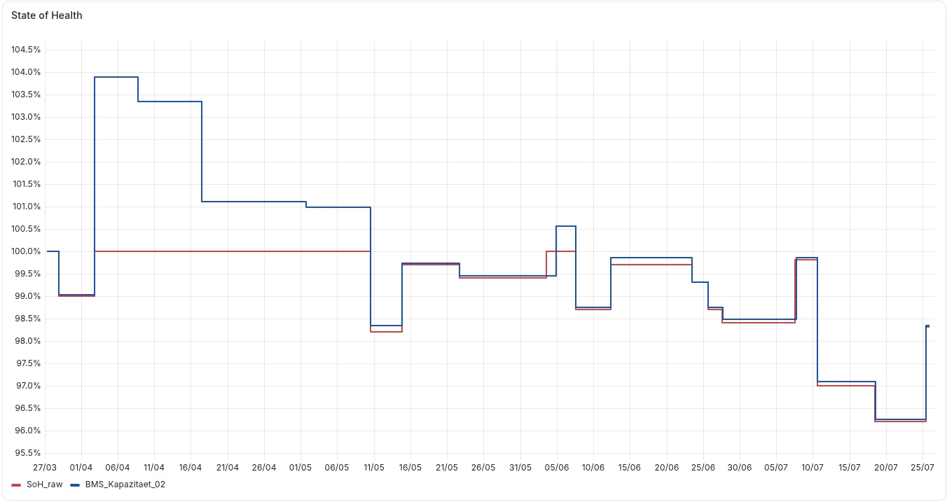

Reading SoH with Car Scanner on J1.2
Short update on the SoH J1.2 reading
With some more data points I believe I have found the correct formula for Car Scanner to use.
Mainly because it's very simple:
SoH (%) = (raw - 13695)/10
Let me know if you have any questions. Will add more, just need time to process and collect.
Porsche Taycan 🔋Analysis of J1.1 with original battery and with .2 replacement 1781898996441-6
Porsche Taycan 🔋Analysis of J1.1 with original battery and with .2 replacement 1781899066702-mr
