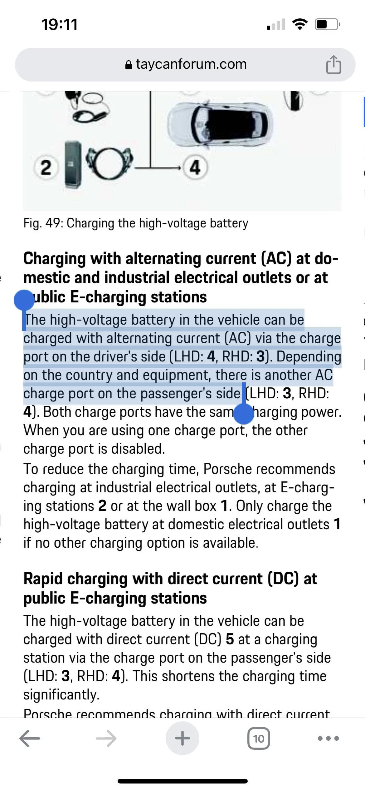

The manual says that AC charging is on the driver's side, but could also be on the passenger side and is country specific. Can you charge using a 32a AC charger on the passenger side for a UK car?
Porsche Taycan AC charging ports IMG_1764
Tia
Yes - either side, 32A, up to11kW on 3 phase or 7.4kW on single phase (standard AC onboard charger)
