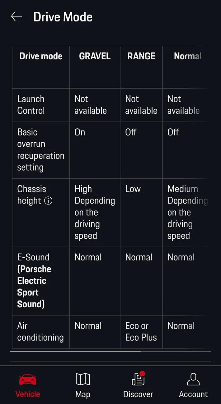

As far as I'm aware, the automatic lowering at speed goes low (1 step down), not the lowest (2 steps down). Range mode is also 2 steps down and can incur the same camber + tire wear issues over long distances
Sport Plus and Range drive mode set the ride height to the lowest settin "Low" (2 down). Height is fixed in Range but can be manually adjusted in Sport Plus. Normal and Sport drive mode have the default height setting of medium.
Auto height is 'Lowered ' (1 step down).
None of the drive modes alter the camber of the wheels. The only thing that changes is the ride height and PASM setting (comfort to hard).
I use range mode extensively and does not in my experience lead to undue tyre wear. 20K miles on my 4S and currently 8.5K on my 1 year old GTS .
11,027
6,809
It’s not so much that it “messes up the alignment” - there is a perfectly valid reason to increase negative camber (handling in corners). I think what you are trying to say is that sport plus puts the car in its lowest possible configuration, which, of course, will result in more negative camber and wear the inner edges of the tires faster.
Regarding “at which speeds”, this isn't accurate - the car (at least in the US) automatically defaults to the lowest ride-height (eg, Sport Plust ride height) when you exceed [75mph] (someone keep me honest here) to optimize aerodynamics. So really nothing you can do about it when you are driving fast. Further, I am not aware of any other reason that speed, in and of itself, would independently impact wear at a given camber angle.
Auto height is 'Lowered' and not 'Low' when in Normal drive mode.
Depending on country the chassis height is at medium regardless of selected drive mode - Australia being an example I think.
The i icon on chassis height states this.

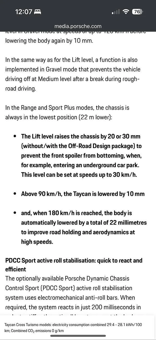

I will have to confirm next time I am in the car but my GTS definitely defaults to “Low” setting (the same as Sport Plus) at certain highway speeds…
I found this in the literature (but it is specifically in reference to Cross Turismo…
Porsche Taycan Acceleration - 2021 4S Cross vs 2024 GTS IMG_4206
… I am fairly certain the GTS does it at something closer to 140km/h as I don’t often travel at 180km/h, but as I said, I will confirm next time I have the opportunity
11,027
6,809
At excessive (non-legal) speeds all Taycans will lower to the low setting if air suspension is installed. Can't comment on the new Adaptive Ride - it may behave differently. Depending on region (local regulations) this height adjustment may be limited.
I believe NA / USA/ EU all behave the same.
I don't drive beyond the limits and so my GTS ST when in Normal or Sport will adjust to lowered only unless manually adjusted. The GTS already rides at a lower height by default.
I have a new loaner Gen 2 4S ST this morning and it behaves the same.
