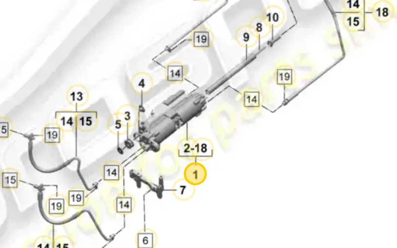

Except it does not seem to be the pneumatic suspension strut, but the servo motor driving the hydraulic pump. PN PAD411881 SERVOMOTOR ACTIVE ELECTR. DAMPING CONTROL (COMPLETE) priced 2911 GBP on Eurospares.
Porsche Taycan Active Ride failure 1760142869242-cv
Will confirm once i know what they ordered. By now, i am still in a war of attrition to get a replacement car. Three days and counting.

So three and half pedibus cum jambis days and one Oak Green Neo Macan 4 Electric later, theory confirmed, and part "should be" available within a week from Germany, once ordered after the importer's technical team give their consent.

So the fun begins.
They still haven't ordered the replacement servo motor, though recognized defective.
Because they want to ensure that it does not happen again.
How, go figure, and they will need a new servo anyway since the original one is fried. It is a very disarming approach.
Good thing that i had informed them in writing and early in my ownership of the wiggly traits of my rear axle, but i am not sure that it is going to sway their logic.
