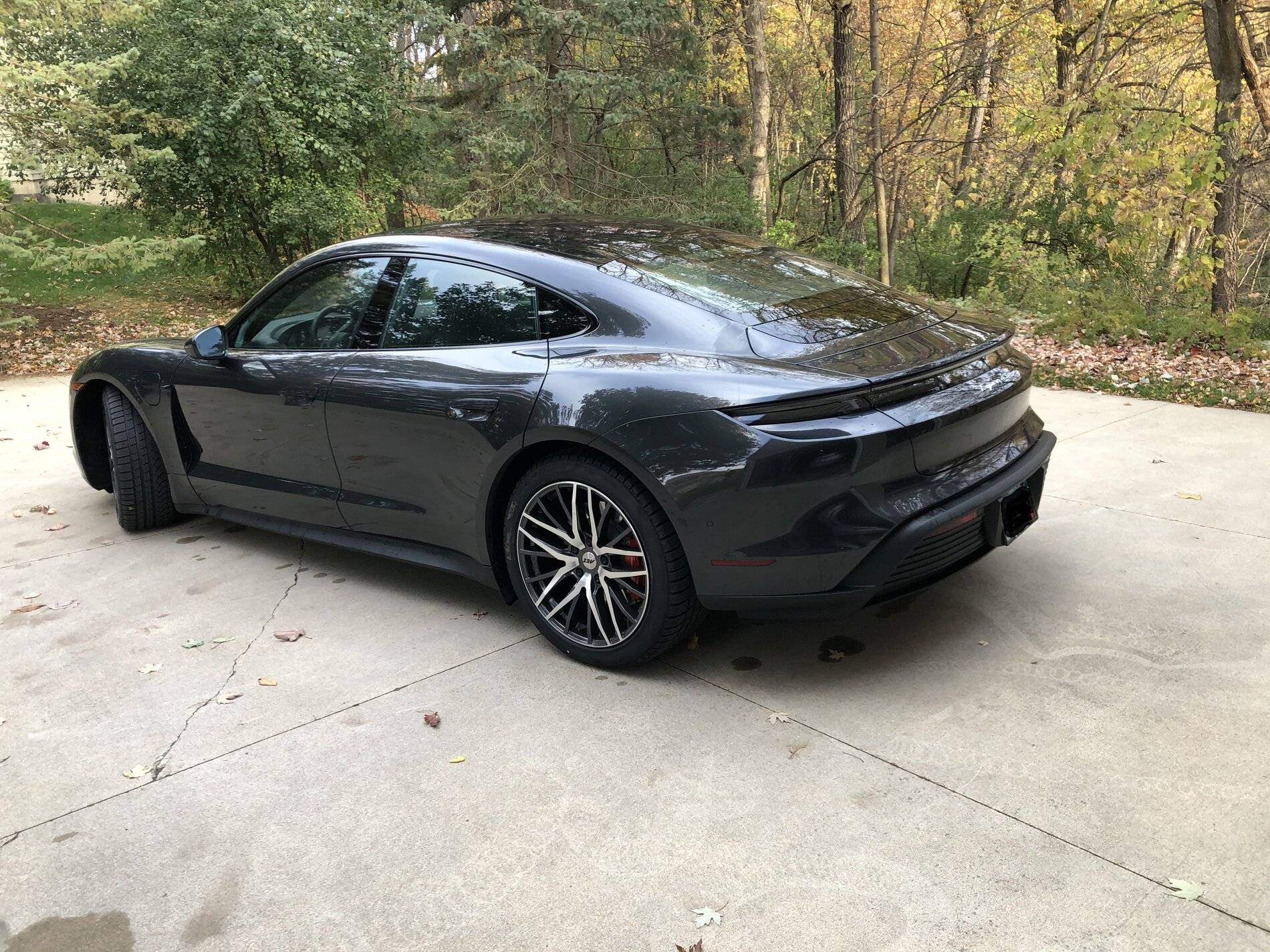

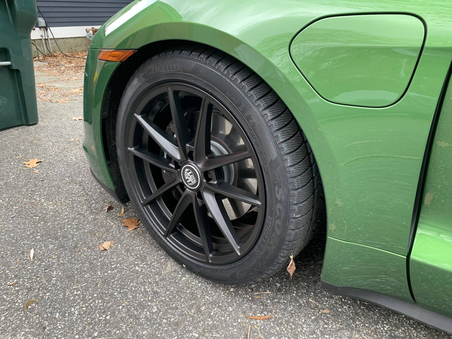

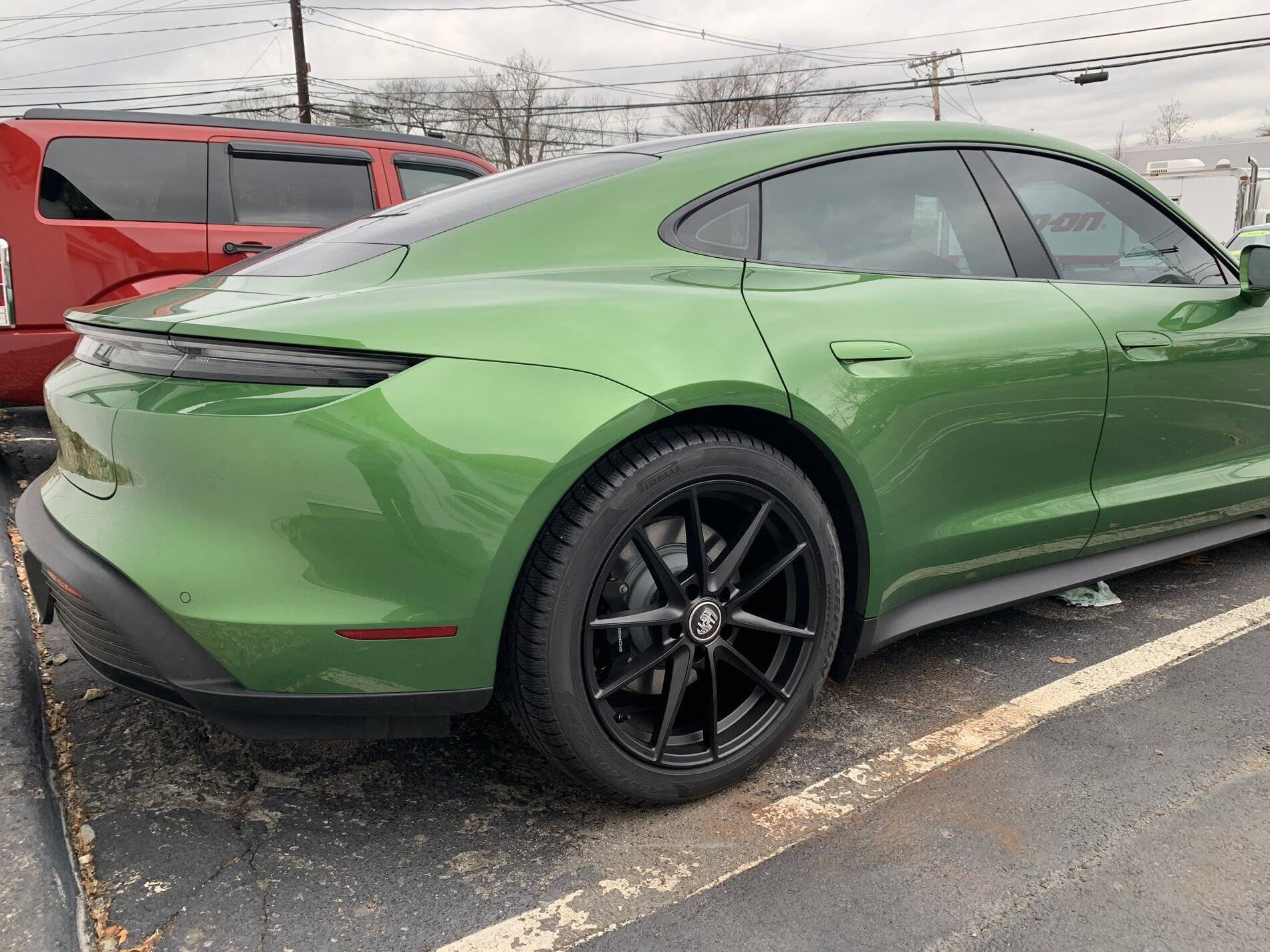

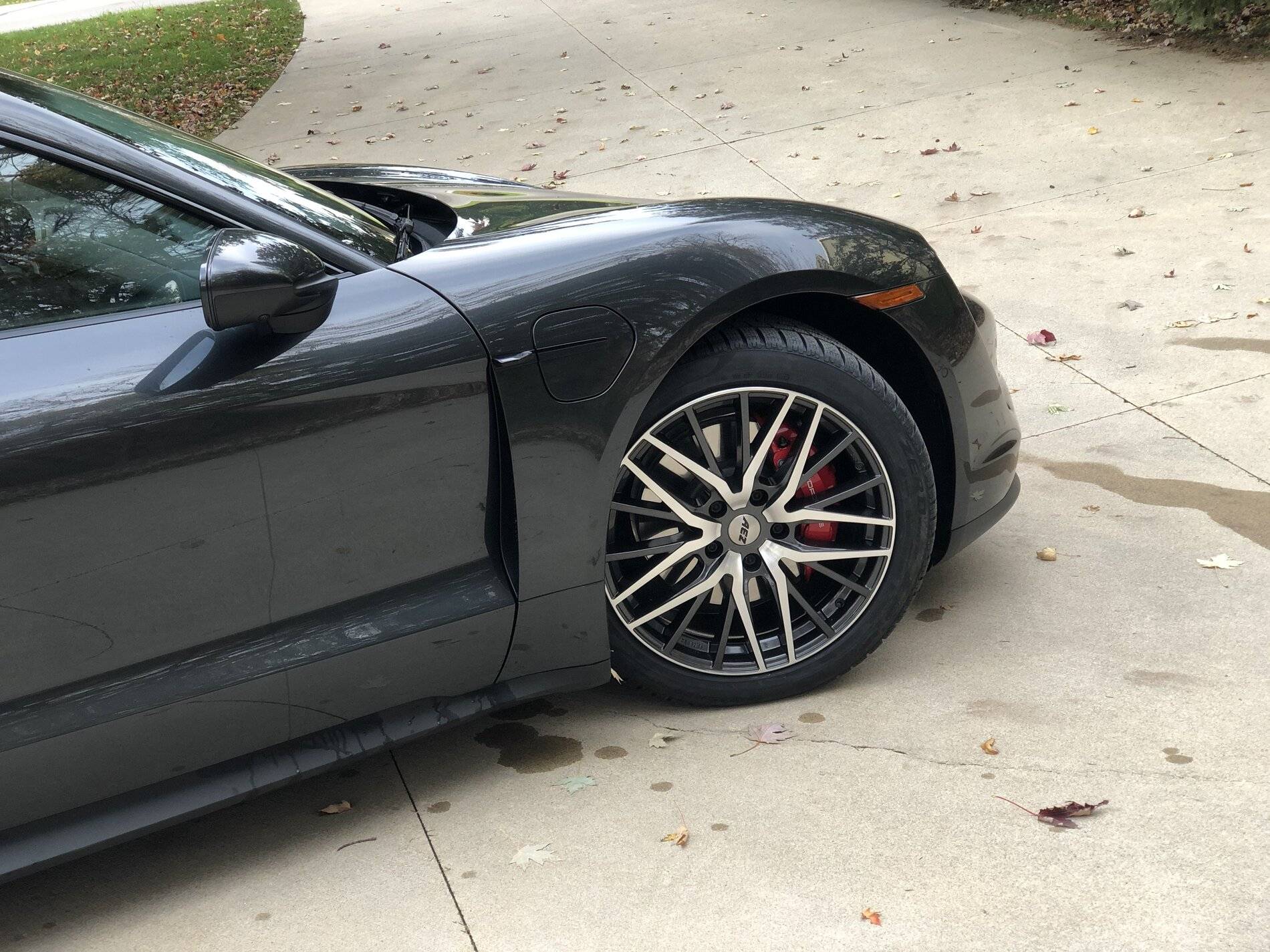

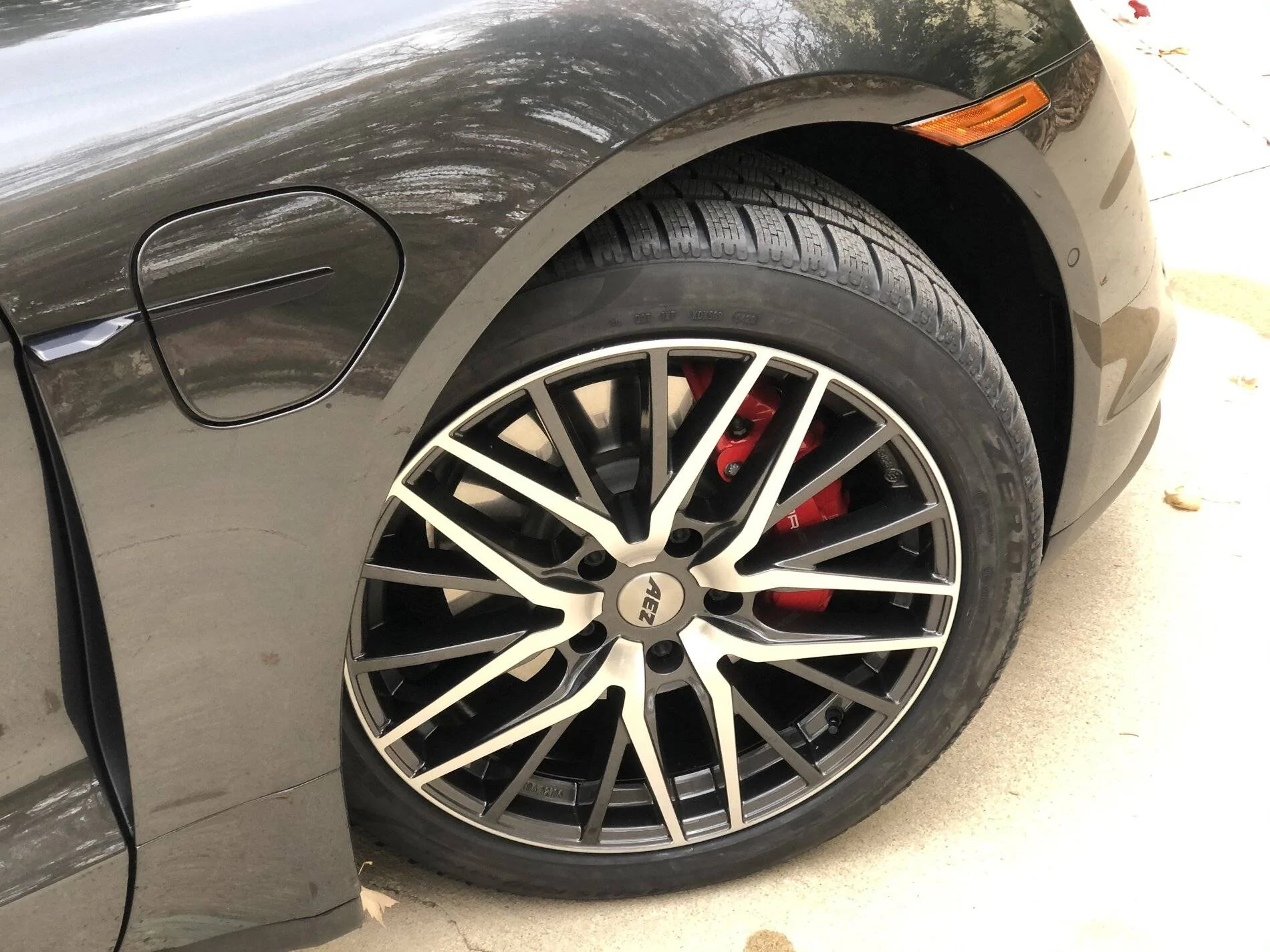

And here is what I did for the winter wheel-tire set. Got 20" AEZ wheels (Panama dark). These are exactly the same center bore and bolt seating (no need for additional hardware). Put P Zero on them. Price was lower than what I would need to pay for the 19" Porsche set - which I really don't like the look.
Perhaps less exotic than other examples here, but I think very good for winter. Once I get a little time with them I will report the range.

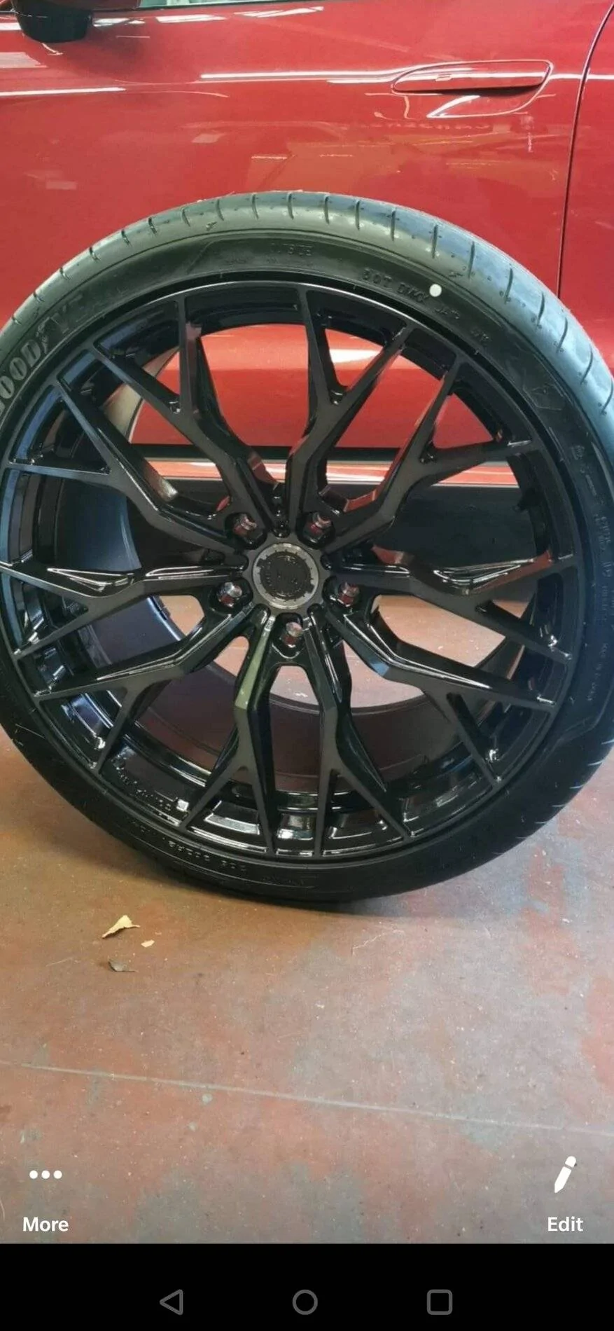

So far, these are what we have listed in the thread:
Champion Motorsport
HRE
Anrky
Techart
Rohana
Momo is listed too but interestingly the picture posted isn’t available and what they do have doesn’t look to fit… would have to look closer at the shift in width and offset to know for sure.
What else are people seeing out there in the wild? Any thoughts on the manufacturing process?

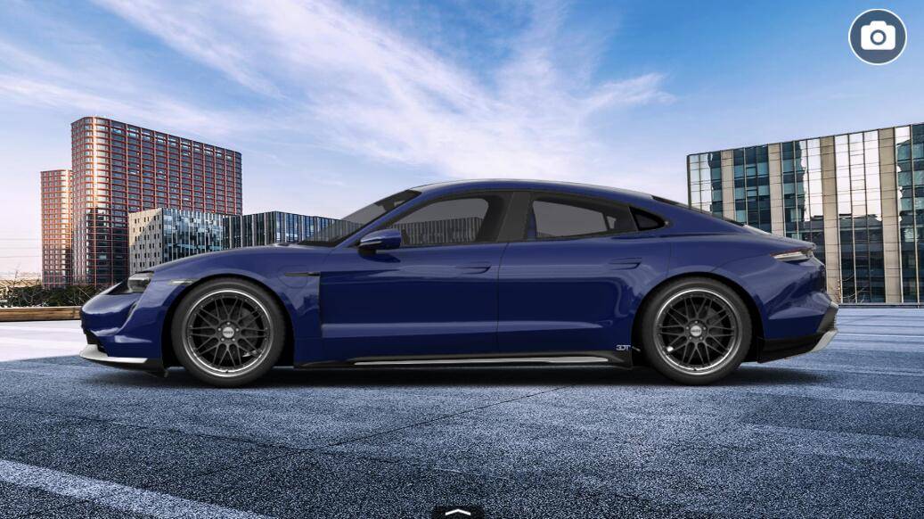

O.Z. (see TireRack info below)
Porsche Taycan Aftermarket wheels for Taycan Screenshot_20201019-210518
Availability: 12/15/20
Cancel
O.Z.
HYPER XT HLT
  • Front: 20x9
  • Finish: Star Graphite w/Machined Lip
Qty
Price Each
Item(s) Total
For 2020 Porsche Taycan 4S
0 1 2 3 4 5 6 7 8
$607.75
$1,215.50
Free Shipping
Availability: Special Order
O.Z.
HYPER XT HLT
  • Rear: 20x11
Qty
Price Each
Item(s) Total
0 1 2 3 4 5 6 7 8
$649.29
$1,298.58
Included Hardware
No wheel installation hardware is included with this wheel.
The wheels you chose are engineered to use Original Equipment lug hardware and therefore lug hardware is not included with your order.
Important Notes: TPMS sensors are not currently available from Tire Rack. Reuse OE bolts.
Free Shipping

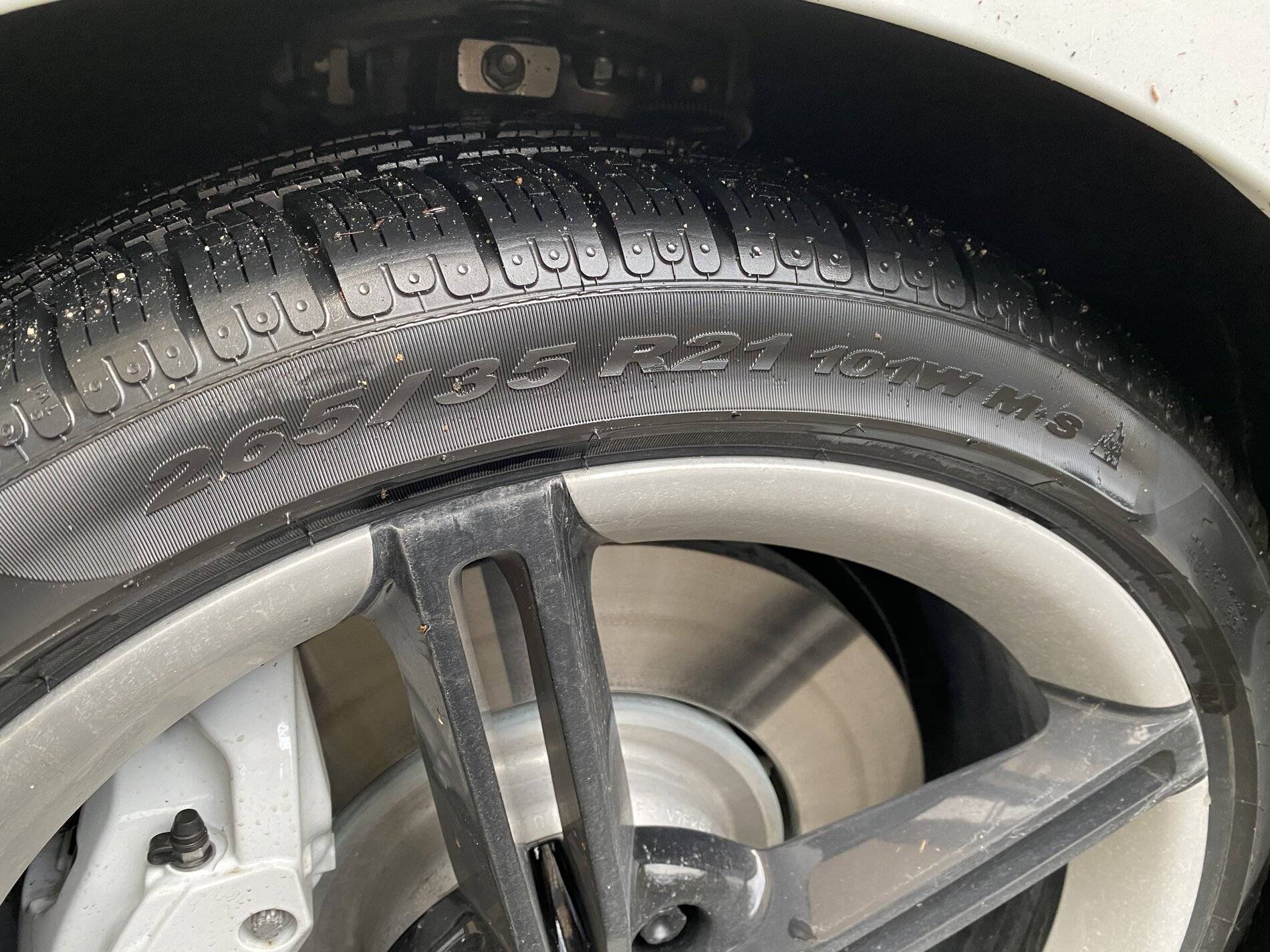

I have the 21” aero blades and they are amazing! But I need winter tires for all the snow we get here. Any recommendations on 21” snow tires to put on these wheels?
BlueShoes
Apr 22, 2020
168
125
Missouri, USA
I don't know that you're going to find 21" winters... Blizzaks for example I believe stop at 20" so if you need winters for sure then you may be looking at a winter wheel set. I usually run a smaller wheel and tire setup in the winters. Part of the reason I went with the 20" default on the Taycan so I can repurpose them for winters once I decide on a better set of 21" wheels for the rest of the year. Granted, I generally just run all'season in the winter. For the few decent dumps of snow we get the all seasons have always done well.

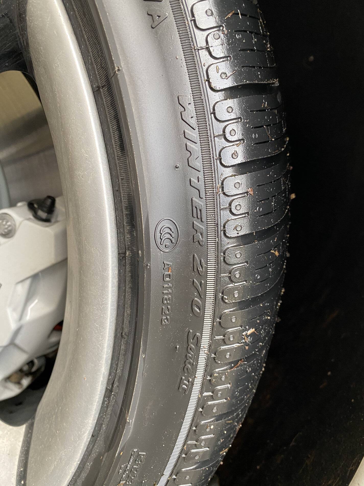

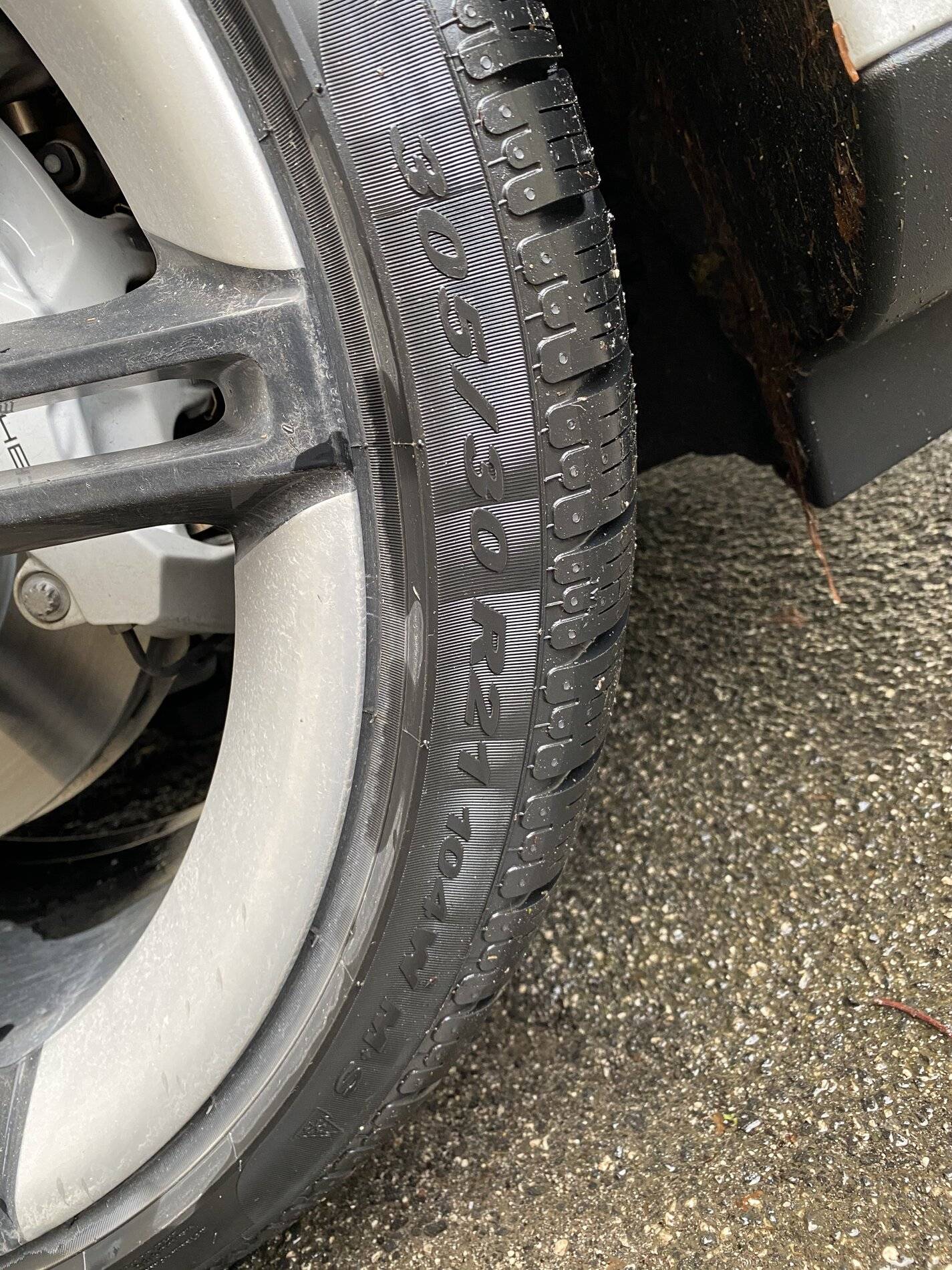

I put Pirelli w270 sottozero series 2.... these tires are the unique winter tyres whit speed limit of 270 km/hr, all the others are <240km/kr
Tomorrow i post some picture.
Interesting. 21’s? I did a configuration for my Turbo with 21’s and the Pirelli didn’t come up as an option.
MrJack
Gianni
Feb 13, 2019
121
100
Rome, Italy
Taycan 4S MY2021, Panamera 4S
Is not on the porsche tyre list but is legal (here in italy) because respect all the indication of the car manufacturer.
