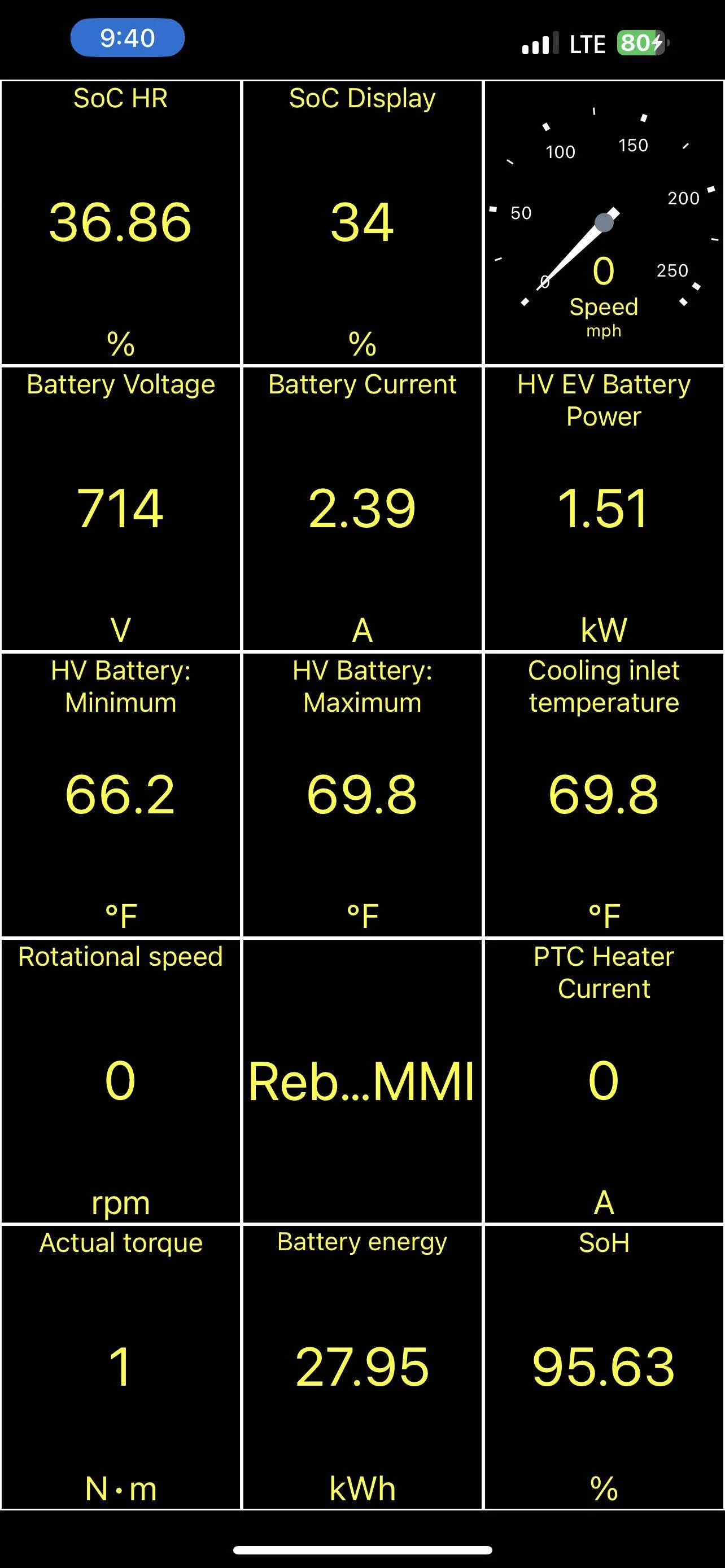

I bought a OBDLinkMX+ and happy to contribute !
22’ GTS ST in the cold Midwest !
1) Delivery Soh - unknown
2) Current SoH - 95.63
3) Current mileage - 1031
4) kWh DC charging - probably 300kW
5) Build date - July 2022

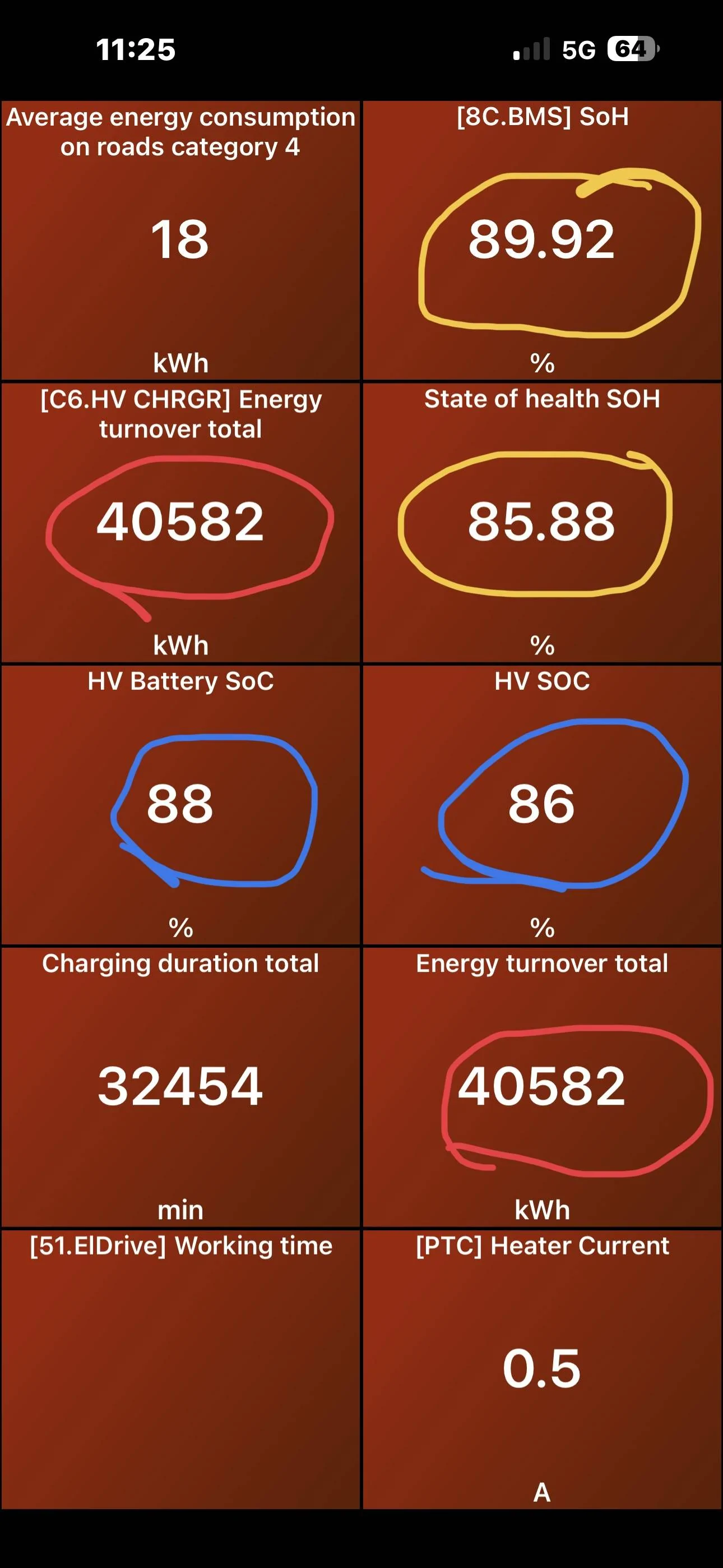

Has anybody found any good description on what the different data mean?? I tried today to check my SoH again but found this page
Porsche Taycan Baseline for HV Battery SoH Performance 9B25AF3A-0089-4C3C-AC1D-1CF7AB608924
The two yellow markers show 2 different SoH. I guess the one with the 8C. BMS is the one to check?
And what are the two red ones, Energy Turnover total? If that shows the total in the car it would mean my car should have rolled nearly 200k km’s??
I also do not understand the 2 values about HV SoC.
I am aware of that you easily can configure the values you would like to see on the screen, but this was one that came up as standard for me.
If anybody has a screenshot of useful inf, it would be helpful to set it up . Thanks

@Scandinavian
Quick response is the HV SoH and HV Soc are for your main battery state of health and state of charge - the BMS value/SoH usually refers to your small 12v battery - doing this on the fly but will try to confirm later- I’m not sure TBH what the other SoH (yellow circle) is but I’d have to look into it.

@Scandinavian
@Scandinavian
Peter - could you share if you sit in the ‘hot’ climate zone I.e. south of L35 N - the very south of France ca. Po/Pyrenees/Marseilles etc (map in post #1)? Also your mileage for this latest update reading of 88% and I can add to the chart?
Would like to anchor your car in the chart more accurately - thx, C.

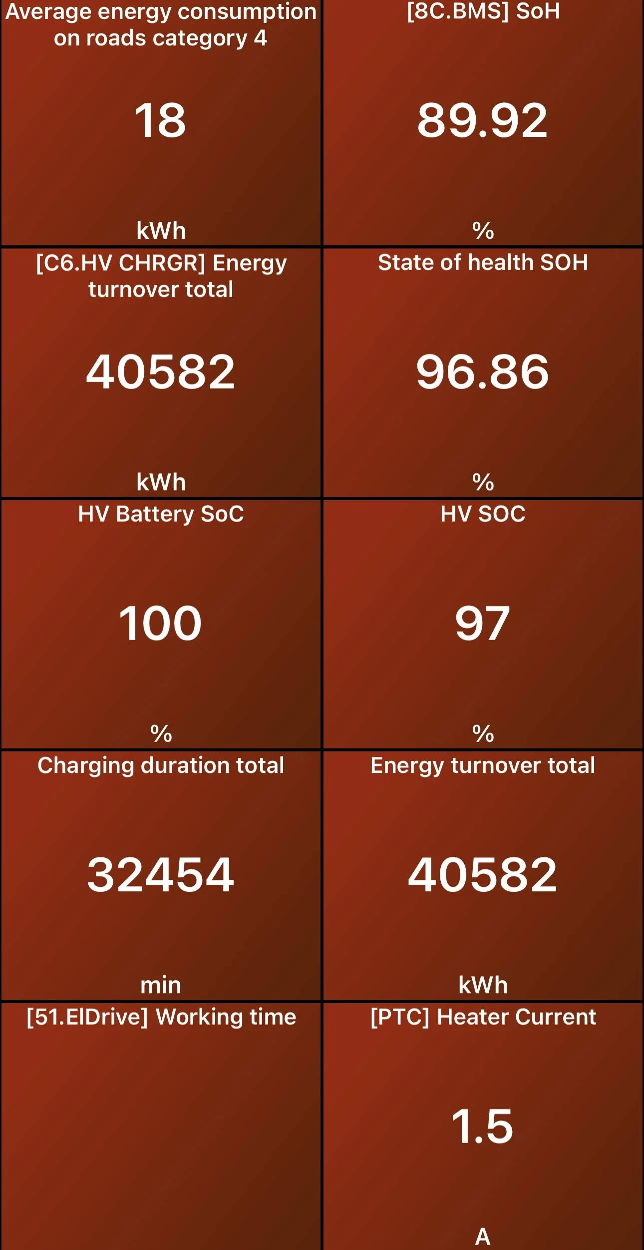

I am still a bit puzzled by the different SoH values. I charged the car for a longer trip later on and recoded as follows.
Porsche Taycan Baseline for HV Battery SoH Performance 337CDEC8-42C2-4B8D-B0C3-55EC9B8E4FEB
I think the top right figure of 89.92, would be the SoH of the main battery and the State of Health SoH is incorrectly labelled. It looks to me that it shows the SoC but with decimals.
Car reported battery at 100% so again not sure how it also shows 97%??
Once I get a clear understanding of this we can add the data. But this is why I wondered if there is more information about the different values and a description available? I am not near the car at the moment so I can not see anything further. It has to be connected to the OBD to see anything.
And I would be at the same level as Marseille normally.
Ah - wait a minute - my apologies - please ignore my last response as I misread your first image in respect HV Soh vs Soc.
Yes I read this as your HV battery Soh = 89.92% - it stayed constant between you changing the SoC.
I am also not sure what the fields 'State of Health SOH' (vs the known HV SoH field) and the 'HV SOC' (all caps again) are referring to - could they be in some way referencing the 12V battery - sorry not sure.
The CarScanner site does not have more specific info but most of the PIDs in here are industry std related to Can Bus codes etc. - I am not an engineer but others may be better able to explain some of these variances.
