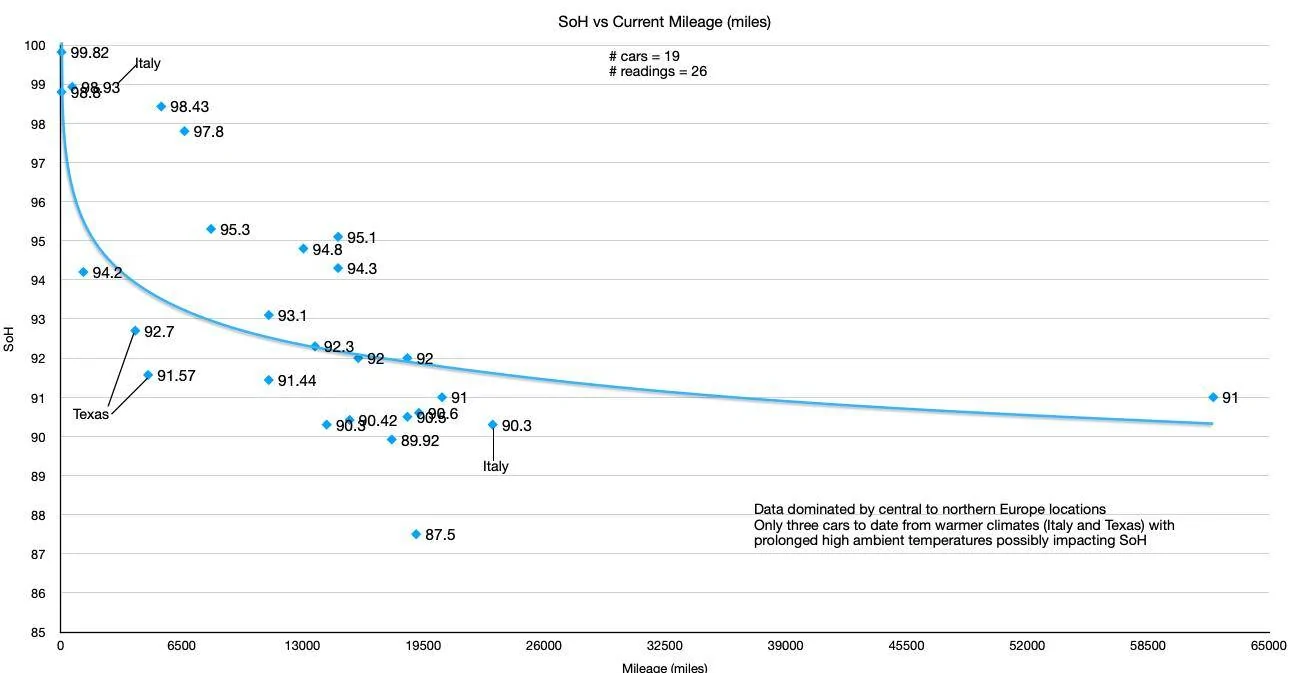

Hey all - we currently have SoH data on 19 cars with 26 readouts of which almost ALL are from northern Europe! TaycanCook and I are literally the only US based Forum users who have contributed to date.
So if you have an OBDII tool such as VGate's vLinker MC+ or similar we'd love to have the following info to add to our spreadsheet here #1
Mileage
Soh
Model
Model Year
Build date
Location (State)
Quick repost of the SoH chart as is - continuously updated in this thread #1

Especially interested in getting more readouts from southern states (i.e. cars in higher temp environments) - the OBDII tool is a great way to check your SoH and a ton more parameters in your car.
