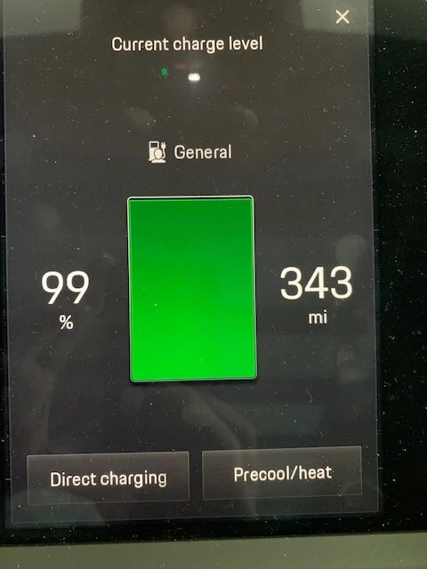

2020 4S with 19" Aero wheels, Performance Plus battery and about 2200 miles on the counter. Recently my best projected range (markedly more than when I first got it):
This is in line with what TeslaBjørn got when he test drove one with those exact same specification (he drove 579km/359 miles).
Mine shows about 450 with 20", 20 - 25c. I live up a steep hill though and mostly do short drives so my average consumption is quite high so I don't except it to show a high number until I've taken it on a long road trip.
I have switched my individual over to be based on Sports+ for the increased volume of the electric sports sound, though. No point in driving in range mode unless I'm going far. :p

Porsche Taycan Indicated range with Performance Battery / Performance Battery Plus 1622875010781
Ideal conditions, 3 bar pumped up tires, flat terrain, mostly city and city highway.
Your range might still go up. I got this after 8 month. and 10k km driven...
