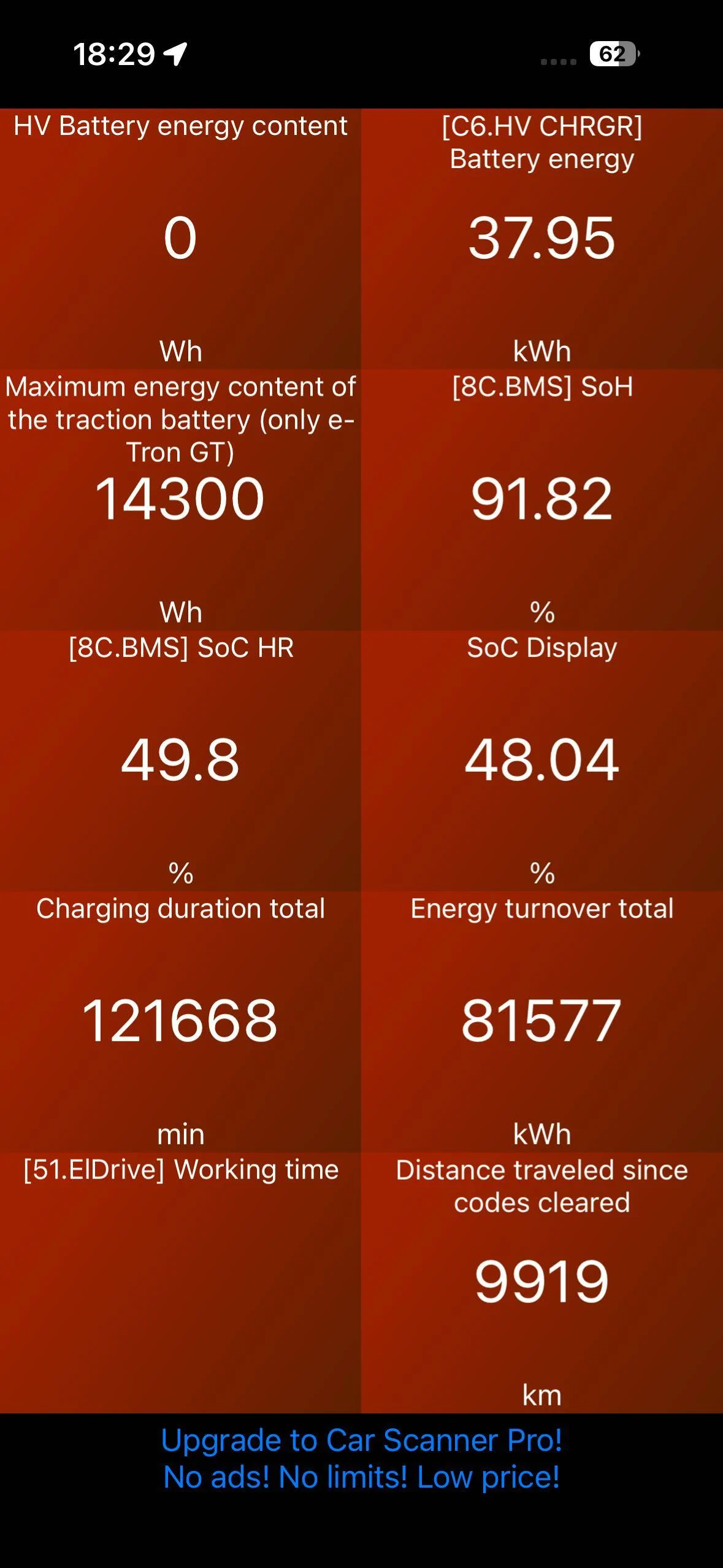

Update on me at 30k km just before the 30k km service and software update as reported by the service advisor.
delivery: 07.16.2022
prod.: 06.26.2022
km: 29,941
mi: 18,713
SOH:91,82. Down ca. 1% in the last 3k km.

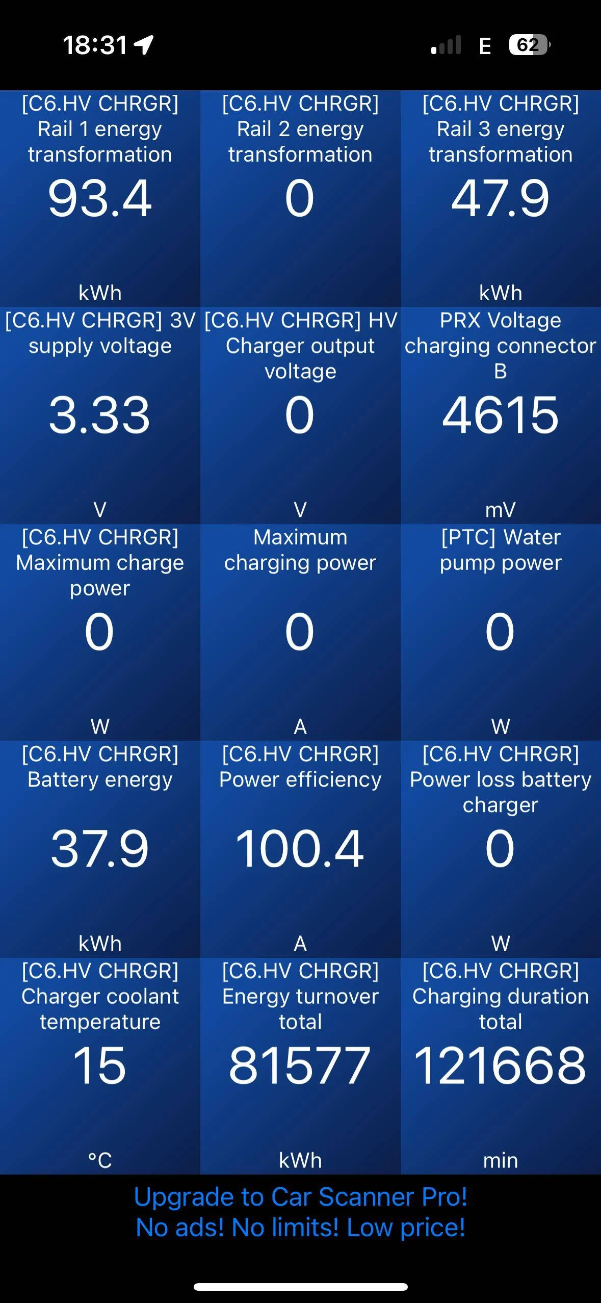

I got some more data from a factory new (not really, was waiting 2 month for the 12V) Taycan with 50km:
99,82% SoH and showing "battery energy"* of 86,5 kWh.
one(!) day later without any further driven miles SoH dropped already to 98,8%.
This is not the first indicator, that SoH is not referring to 93,7 kWh net capacity but to 86,7 kWh, which means Porsche left another 3 kWh safety margin for possible customer claims in 6 years.
would be interesting to see your readings of *[C6.HV CHRGR] Battery energy in realtion to actual Display SoC and SoH.
there is another strange reading of [19.Gate] max energy content of the traction battery
but I cannot guess what this should mean, showing 14,85 kWh in my car.
Means ca. 77kWh actual capacity. Matching numbers as I see.

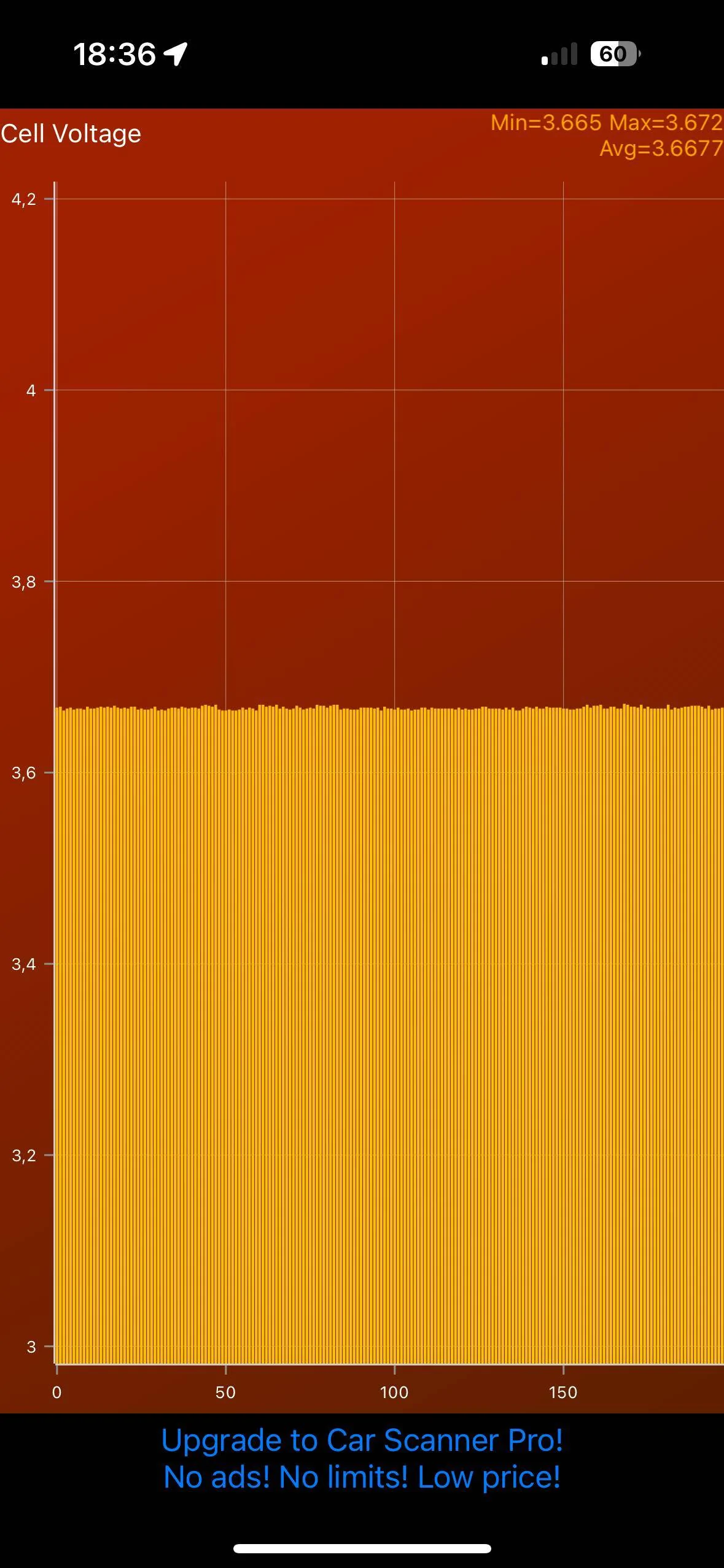

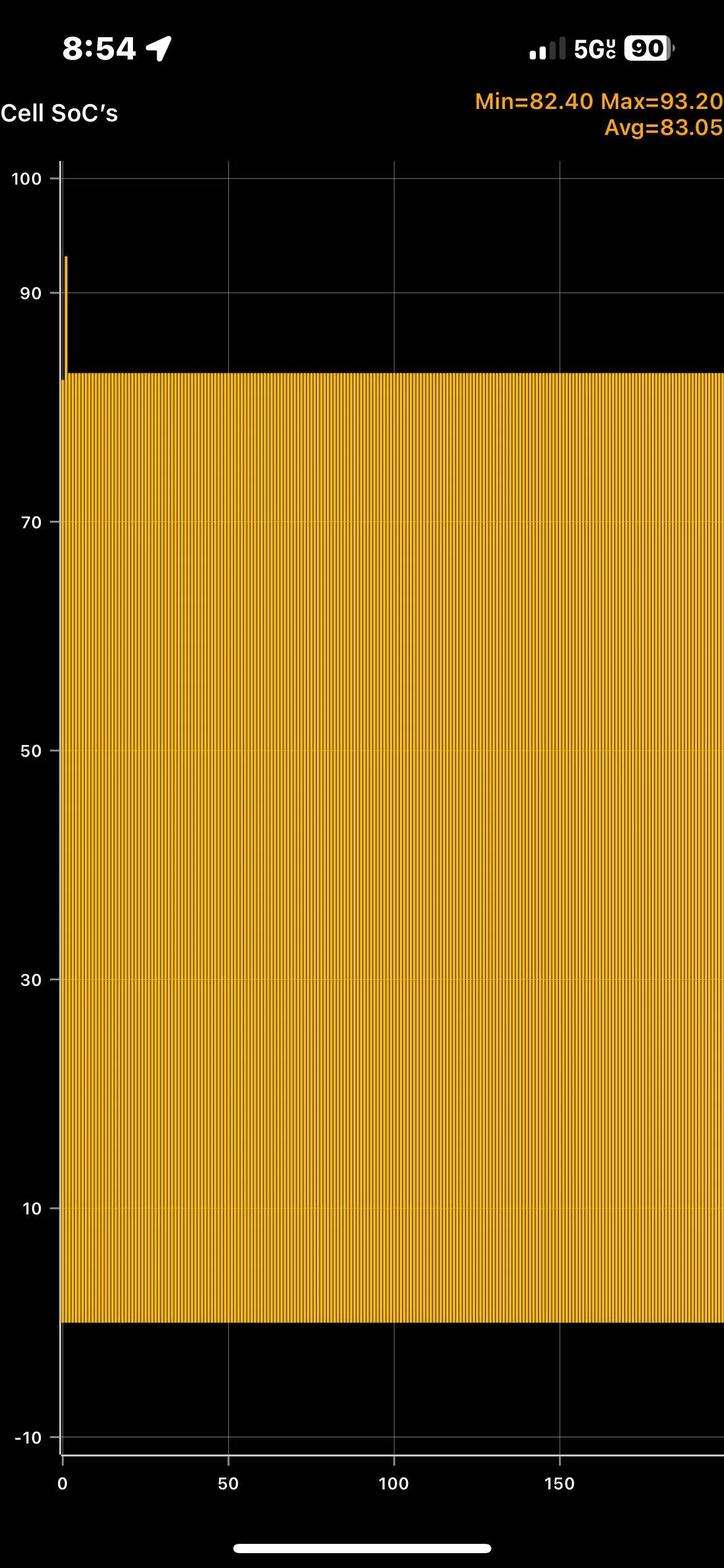

Was mucking about with different values to plot in the CarScanner histogram and changed from cell voltage to SoC for grins - this after a 85% at home charge session - noticed I seem to have a couple of 'rogue' cells in module 1 charging to higher (93.2)/lower (82.4) values than all others (all of which seem constant at 85). Checked settings in case I was selected some other value but no, def SoC - curious! The lower value I was thinking might just be use of car as I was operating the OBDII but the higher value harder to explain - might need to look at other values and keep track of any consistent observations (for slow days :)!)
Porsche Taycan 🔋 Baseline for HV Battery SoH Performance (Battery Degradation Data by Taycan Owners) IMG_3926
ciaranob
ciaranob
Jul 3, 2021
3,547
2,639
that does not look healthy...glitch from the app?
Yes a little odd, an hopefully so - will drive some and let it 'settle" and take another look in a day or so. Will be interesting - worst case scenario perhaps a harbinger maybe of the weird sequence of minor events Scandinavian started to experience before his troubles - but getting ahead of myself :)
How do you see this chart in the odb scanner app? Thanks in advance
ciaranob
ciaranob
Jul 3, 2021
3,547
2,639
Just a custom one - you can either change values of an existing chart or build your own on a new page - bit laborious but a one time setup.

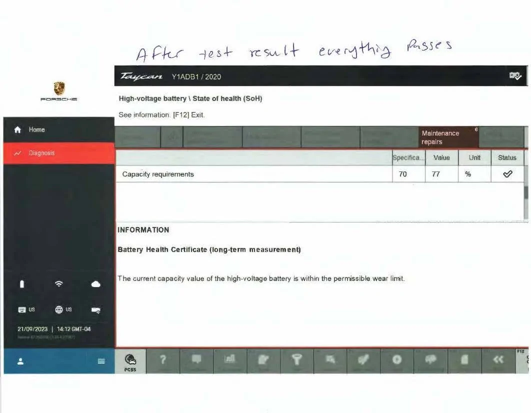

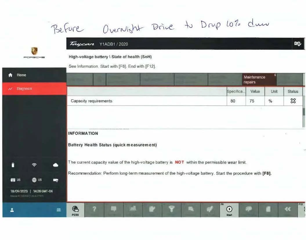

The service tech provided the below screenshots from the PIWIS State of Health diagnosis function.
  • The "before overnight drive" report on Sep 18 2023 shows "quick measurement" test failure due to SoH of 75% when specification is 80%. (I believe spec = 80% was based on them not realizing the warranty specified minimum SoH is only 70% after 37,750 miles).
  • The "after test result" on Sep 21 2023 shows "long term measurement" test pass at 77% SoH when specification is 70% (matching warranty specified minimum SoH after 37,750 miles).
Here's how the service tech wrote up the SoH measurement on the invoice, in two separate operations:

Porsche Taycan 🔋 Baseline for HV Battery SoH Performance (Battery Degradation Data by Taycan Owners) PIWIS screenshot befor
Porsche Taycan 🔋 Baseline for HV Battery SoH Performance (Battery Degradation Data by Taycan Owners) PIWIS screenshot after
