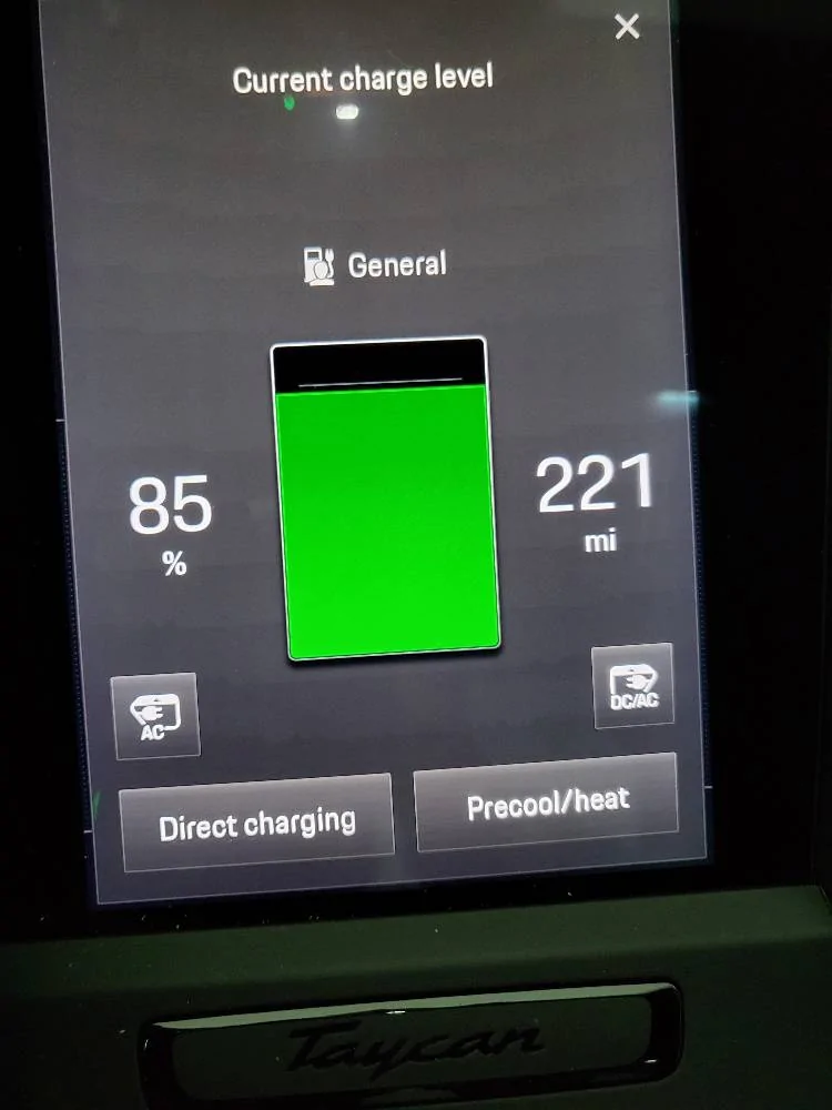

On the topic of battery degradation and DC fast charging, I'm wondering to what extent everyone here avoids DC fast charging to minimize battery degradation. I have a PMCC installed in the garage, but we also have an EA station with multiple 150kW stalls less than a mile from the house. Since we get 3 years of free 30 min. charges, I've gotten in the habit of using the EA station once or twice a week. In the time it takes me to walk to the Starbucks down the street and back, I've taken the car from 40% to 85% for free, but if this is coming at the expense of increased degradation to the battery I'll rely more on charging at home at night. FWIW - I have "battery friendly" fast charging enabled. How worried should I be about DC fast-charging if I'm only charging to 85%?
I have a 2020 4S (the first one delivered in the US on this forum). I used EA DC fast charging quite a bit when the car was new because I didn't have the NEMA 14-50 outlet at my house. I then got the outlet installed and went through a period of time when I charged mostly at home to 85% every night. In the past I have also stored the Taycan for up to 6 weeks, plugged in at 85%. Last Oct, I drove the car back up to CT and exclusively used EA DC fast chargers until July. The car is back at my house in GA, so I mostly use home charging again to 85%. Over the course of ownership, I have done eight 1000 mile road trips all using EA DC fast chargers.
As one of the oldest Taycans in the US I have not noticed any negative impact on range due to my extensive use of EA DC fast chargers, charging and storing the vehicle at 85%, and charging to 100% for my road trips. Here is a screen shot at the end of yesterday's home charging session.
85% - 221 miles (100% - 260 miles) which is in line with what I have seen during the summer months during the course of my ownership. Fyi, I have an air conditioned garage that maintains an ambient air temp of 75F. I have 21 inch Mission E rims and drive the car as it should be driven as a Porsche. The car is going into the dealership tomorrow for the software update. It will be interesting to see if the range increases post update.
How accurate is this though? If you just happened to drive hard on the freeway/run the AC just before getting home, the guesstimate probably won't be that high. I charge to 80% and it ranges from 190-205mi.
So for anyone who is comparing your range to others on this board, don't feel degraded (haaa) if you're not getting the same lol.
I'm also curious to know which options you have and how much they play a role in range? RAS, coils vs air suspension, sport sound, hell even Bose vs Burmester.
