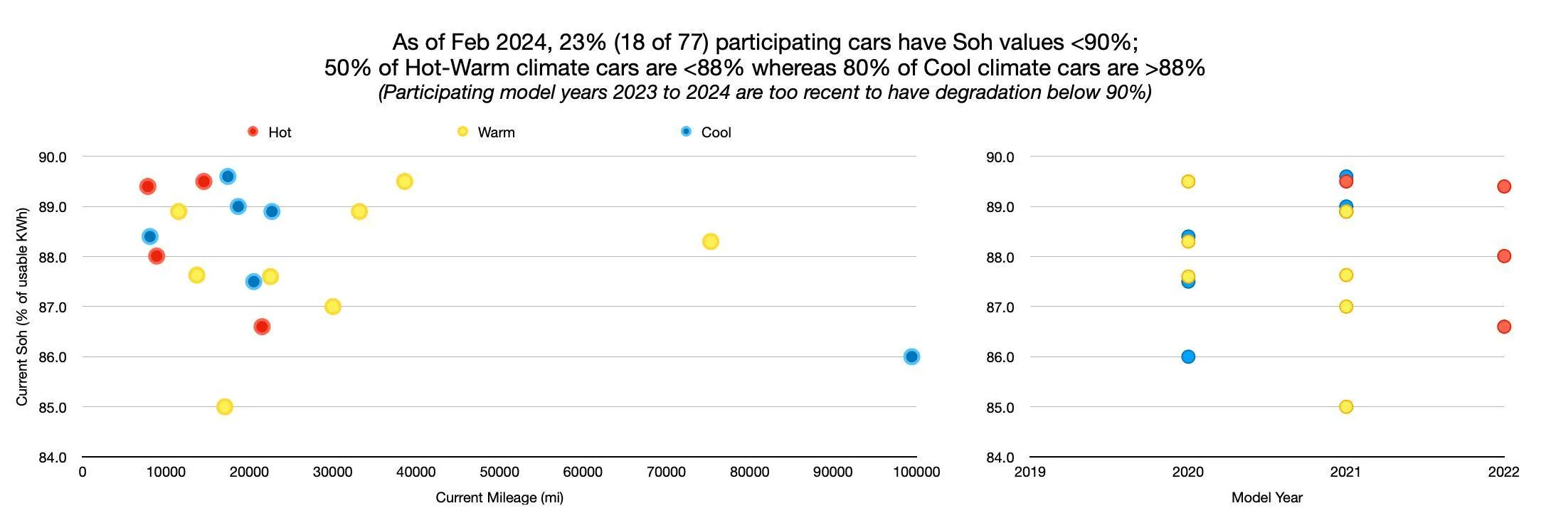

Here is an interesting graphic - have other metrics I need to post e.g. rates of degradation per mile driven etc. but need to organize before sharing.
The good thing (unless you're in my group! :)) is that the majority of participating vehicles (close to 80%) are still above 90% Soh regardless of model year (2020-2024).
Not surprisingly the worst performers are again dominantly in Hot-Warm climate zones but a small measure of difference.

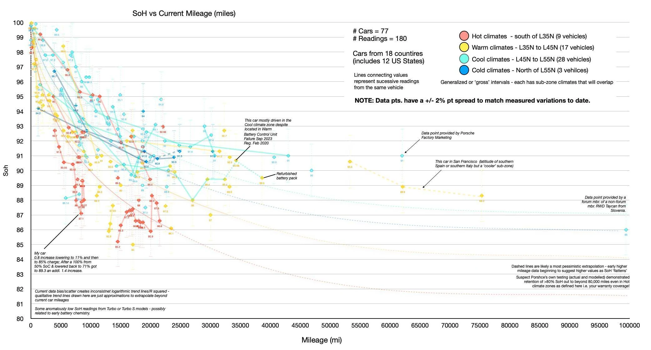

And the full dataset as maintained in Post #1:
Porsche Taycan 🔋 Baseline for HV Battery SoH Performance (Battery Degradation Data by Taycan Owners) Screenshot 2024-02-06 at 5.06.26 PM

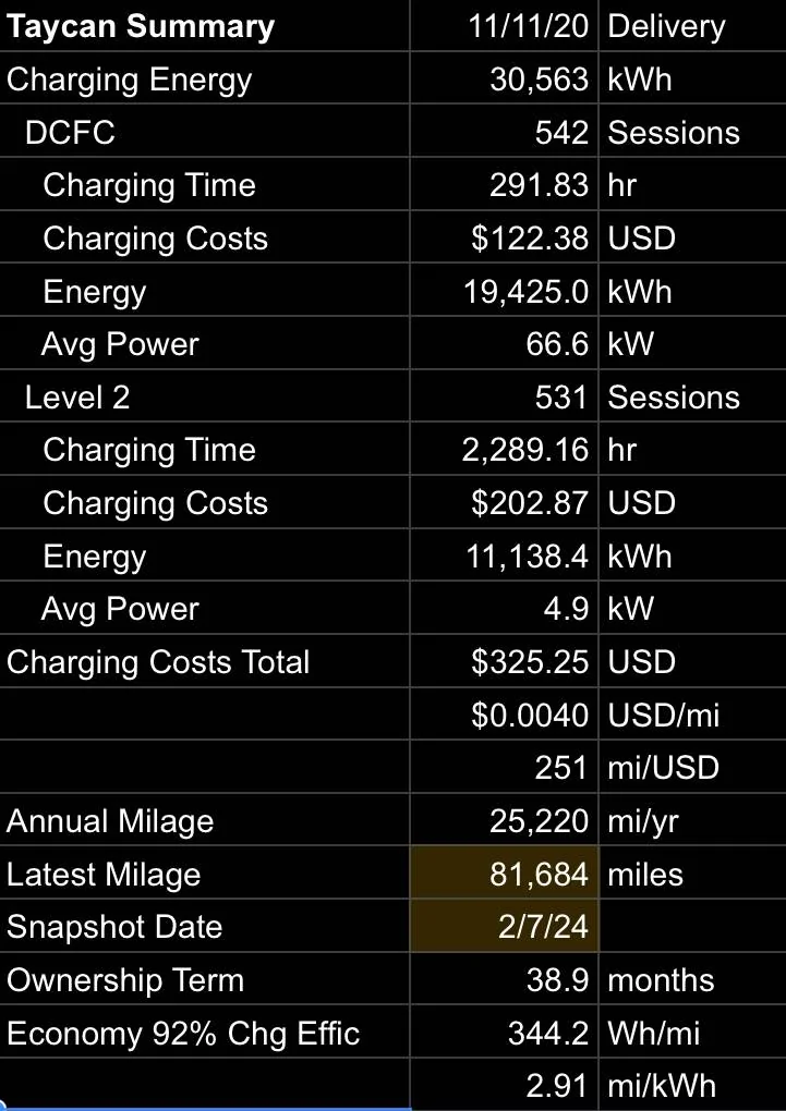

Updated checkin
1) Delivery Soh - unknown
2) Current SoH 88.27 as reported by Car Scanner
3) Current mileage 88,600
4) kWh DC charging 19,425
kWh L2 11,138
5) Build date Aug 2020
Still has no problem going to 267 kW when charging at a fully functional Electrify America and it preconditioned.
Longest Road-Trip 7,300miles
See posting at https://www.taycanforum.com/forum/threads/please-welcome-stealth.3531/post-263654
