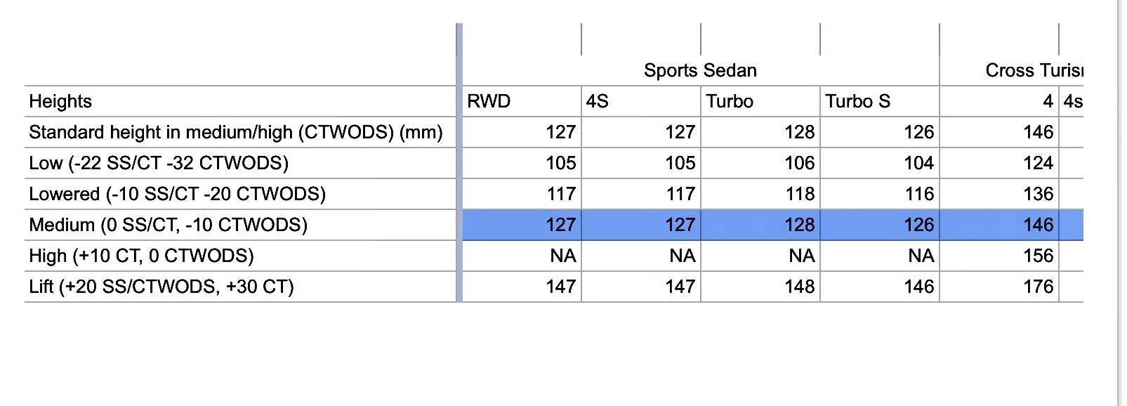

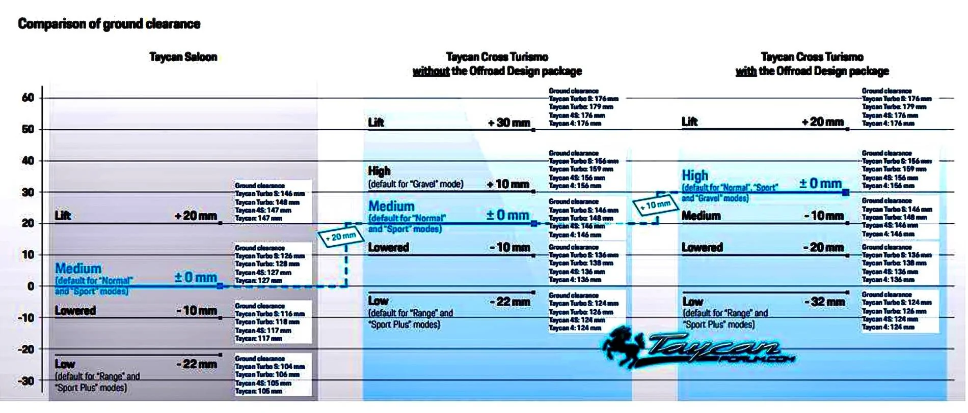

Learning more here in this thread…. As to my most likely change of mind from my OP, my wife who has arthritis saw the below linked video short and said, “I am liking that option for my getting in and out.” She then read this entire thread. [LOL, what’s another $7,140 for we were already planning on getting PTSV+…]
THANKS to “oalsaker”for his/her summary larger-print spreadsheet below which comes from the “ET34” initially posted Porsche chart (thanks ET34), and thanks also to all who posted above.
newsroom.Porsche.com said:
Easy entry: when this function is activated, as soon as a door is opened, the body raises automatically by 55 millimetres. This makes it easier to get in and out. When the door closes, the Taycan lowers back down to the previous level.
https://newsroom.porsche.com/en/press-kits/taycan/Porsche-Active-Ride.html
As we know, the regular Taycan Saloon 4S normal ground clearance is 127 mm/5”. But with PAR/Comfort Entry (CE), what does the CE ground clearance become when a door is opened? Does the extra 55 mm/2 1/8” pop-up vehicle height listed in Porsche’s press release add to the initial 5” “normal” ground clearance, i.e.., does it become 7 1/8” total ground clearance when a door is opened??? Or is that 55mm increase come from its lowest clearance position of 105 mm and become a max of 160 mm/6.3”? Thanks. Might those who have PAR now, please do some confirming measurements on yours?
