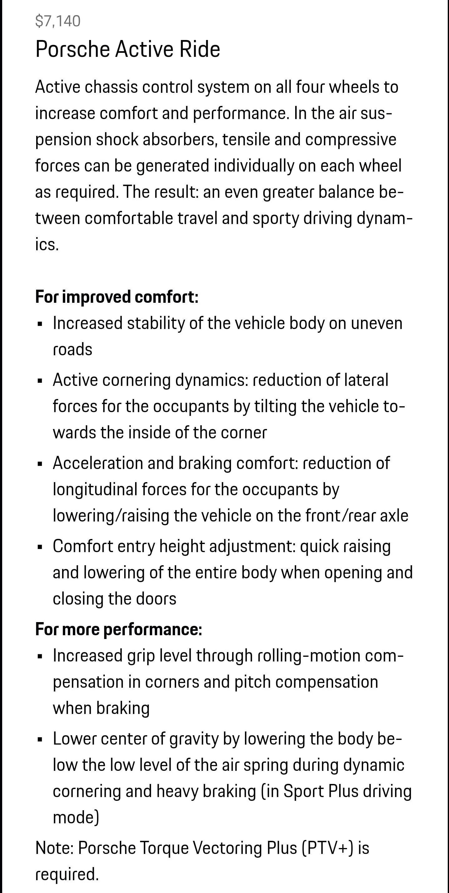

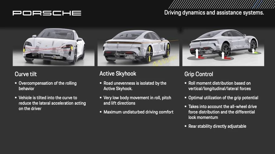

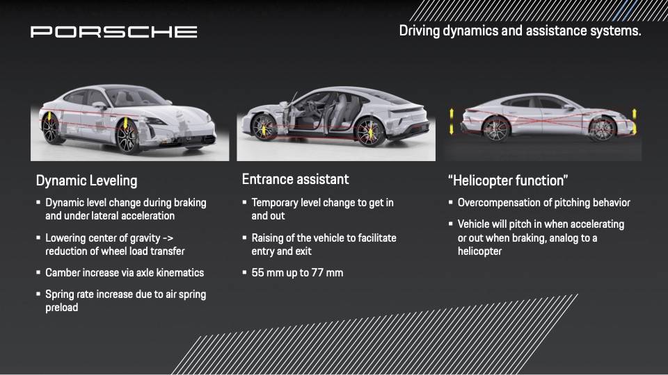

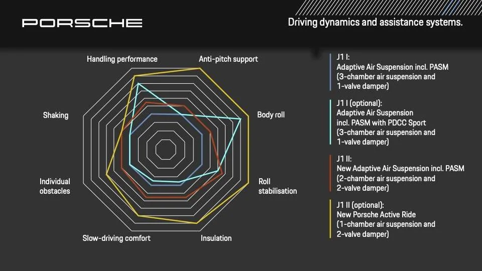

The main USP of Active Ride over PDCC is not actually track performance, but increased comfort. It goes so far that most of the new features are only active in Normal mode and not Sport or Sport Plus.
Here's the section about Active Ride from the PDF that was posted earlier:
Thanks for sharing!
I can see the folks at Porsche Marketing had a field day when they dreamt this up!
Pay your money and make your choice but Taycan Gen 1 has a fantastic chassis and ride as it is IMHO and highly unlikely that much of the above will be noticeable / discernable on a daily commute. Still does not justify the cost.
Worthy of a blind test drive - with, without to see what gives particularly on real roads - potholes etc.

The J1 suspension is an offspring of the Panamera 3 chamber air suspension, PDCC a more mature technology with a weight penalty.
I would be curious to know if this new suspension is specific to the J1 II
As an FYI the J1 chassis is also a modified Panamera chassis
