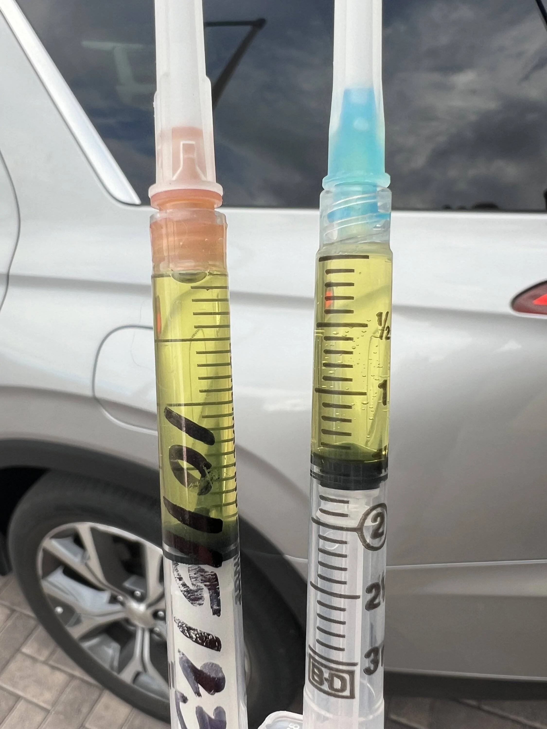

Got the car back from the 20,000 miles services. It said brake fluid had been replaced.
I took a sample before the service because I had some doubt about the dealer.
The left one is before service. The right one is after. I’m used to see transparent color when the fluid is brand new.
I doubt they replaced it.
What do you think?

The proper way to tell is checking with a tester which checks for water through resistance, before and after. Color is a bit iffy.

Get a sample of brand new fluid and you’ll have your answer. To allieviate any doubt, use Porsche fluid. You can also check the bleeder screw for witness marks from a wrench, and the inside of the bleeder will be wet with brake fluid. Pop a dust cap and take a look.

The stock brake fluid is a pale yellow like your pics. Hard to tell based on the fluid in the reservoir unless you test conductivity. Even then, if you’re in a dry climate you probably won’t see much difference in 2 years. I’ve had 6 year old fluid that was still in spec for water <3%. The fluid in the calipers that gets bled out first will usually be darker since it’s seen heat.
You can ask the shop next time to provide you the empty bottles if you’re worried. I had a friend who worked at a BMW dealership (decades ago) and the mechanics would collect bottles of brake fluid on their benches since it was the most common thing to skip in a service.

Brake fluid is hygroscopic -- regardless of brake use, the fluid is always absorbing moisture which will eventually lead to various problems. Here are a few prior posts on this topic.
