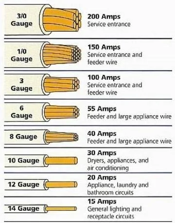

ummm not normally - see table below
6 gauge is not rated for a full 60 amps
and 50 amps can pass inspection with 8 gauge - so that won’t handle 60 amps
in the 10 years i’ve been doing EV’s 4 gauge is normal for 60 amp loads
but i’m not an electrician - id consult with a 2nd licensed/bonded source

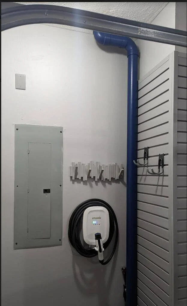

My EVSE is installed with 60Amp in with 48Amp out, but I cannot test it since the car is still a month away. Is the general consensus, that the max is 9.6kW that the car can accept, or it can reach beyond that on the 48Amp output to the max of 11kW rating of the charger?
The reason I am asking is because, Standard Equipment states the following that On-board AC-charger with 9.6kW (AC), did not option the 19.2kW as I do not have 100Amp ability nor that I need to charge that fast.
I decided to go with next to the panel location (after installers starting bending long and thick metal tubes to reach to the front of the garage), so I have no wires running from the panel to the charger, not ideal location but reaches to the car ports fine, since will be charging at night, but tucks away nicely when not in use, and can be covered by hanging coats and such.
