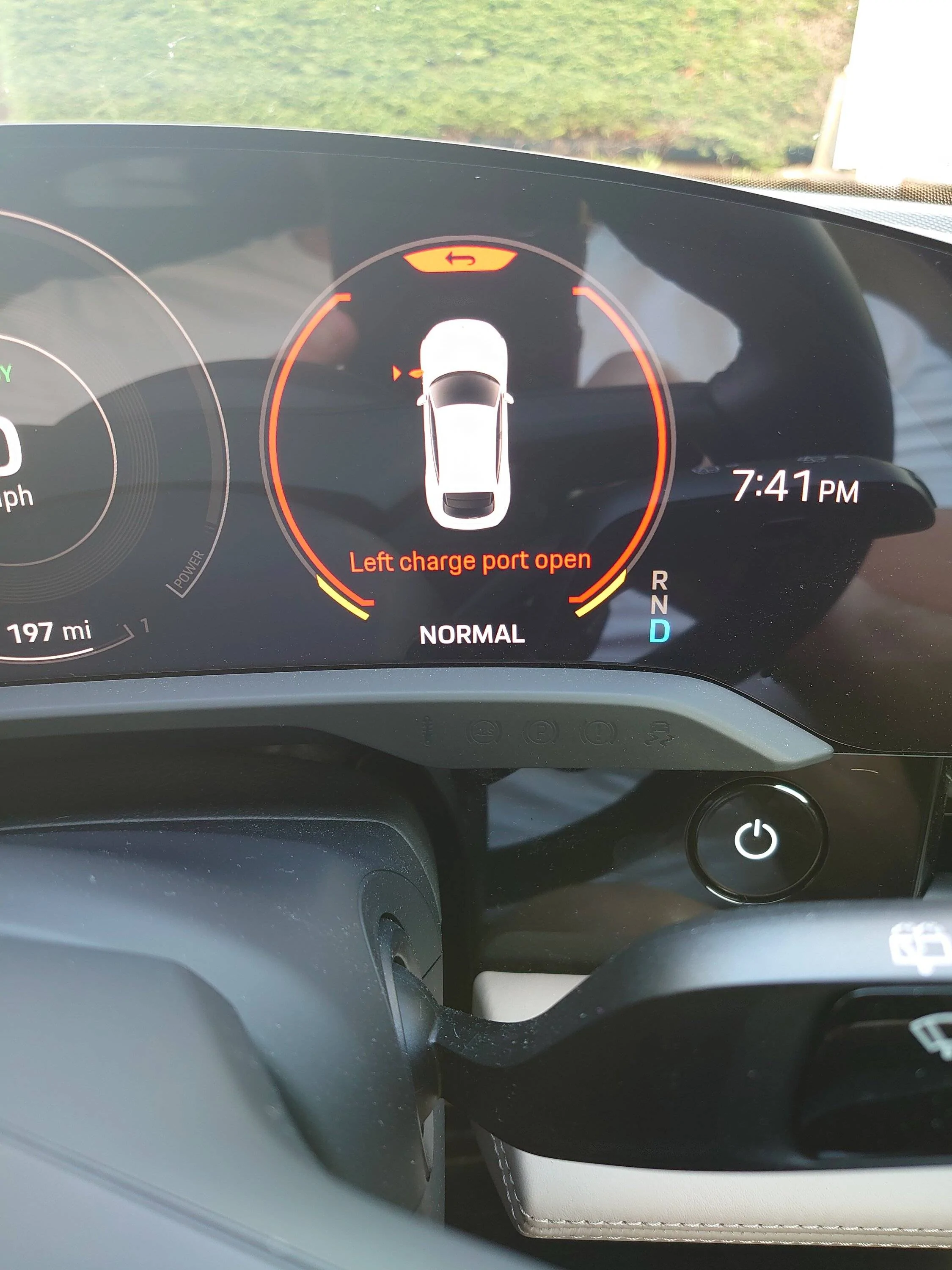

Has anyone else had this fault? Nothing wrong with the cover as far as I can see and annoyingly because the car thinks it's open, it locks up the other port cover and it won't open. Annoying !

Nope. I've had the impaired message normally when DC charging and I forget to check the bottom flap has sprung back before the port door closes (if not the door auto opens when it hits the obstruction) Error clears.

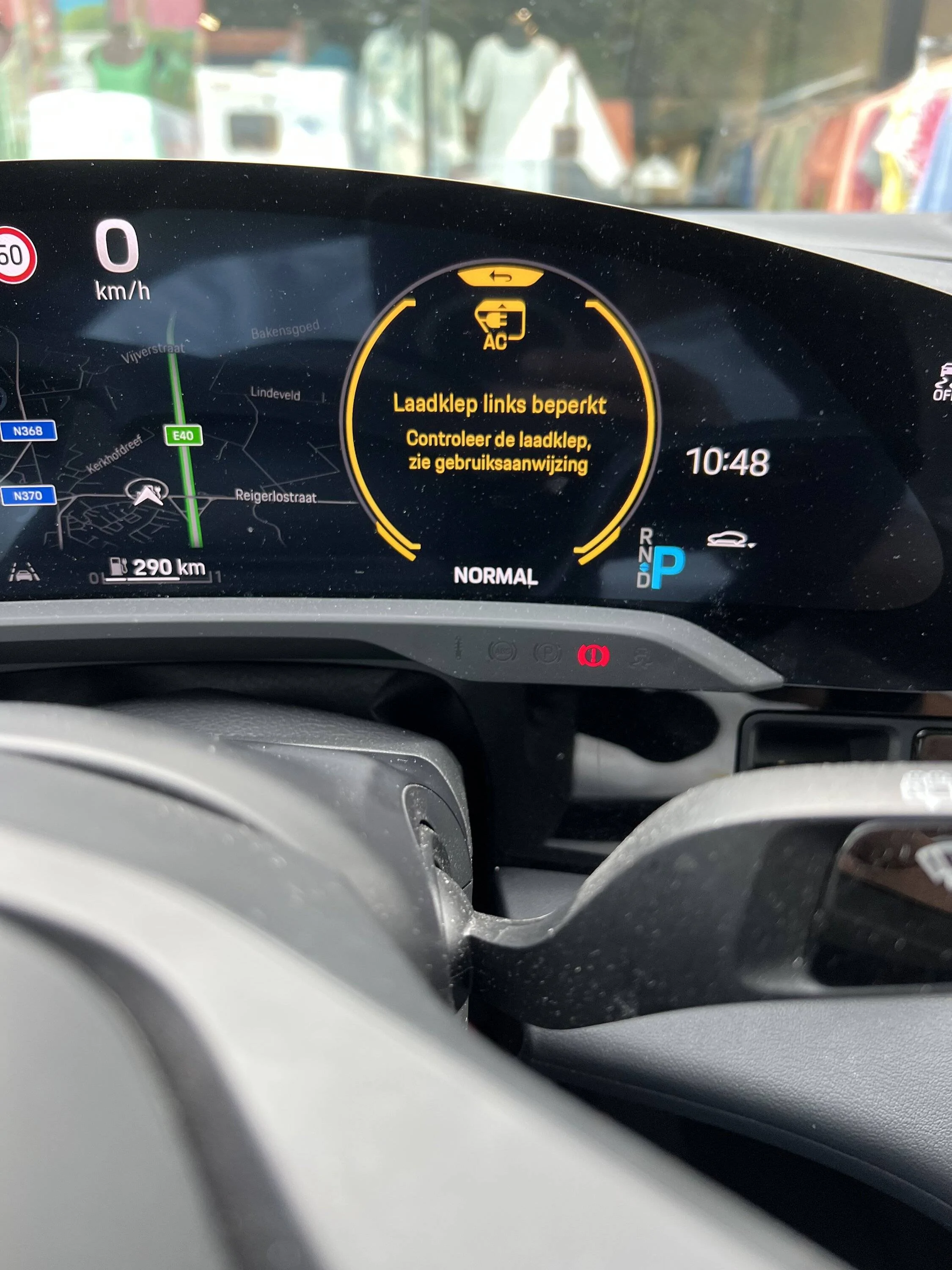

Yes_ left side was open , said my car. But it was not.

Could be the spring latch is not fully retracted. Try pushing the latch manually to ensure its properly closed.
Could be dirt causing an obstruction.
A squirt of WD-40 might help.
