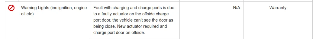

update - issue found and fixed
Porsche Taycan FIXED - Charge port reported open when closed 1684262101763
There must be a link between the offset and nearside actuators since both doors would not lock. This is unexplained for now.

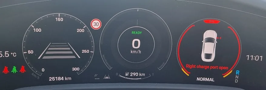

The symptoms were
Porsche Taycan FIXED - Charge port reported open when closed 1684262405054
Right charge port open

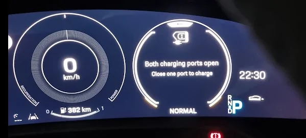

then when opening the nearside port
Porsche Taycan FIXED - Charge port reported open when closed 1684262482484
"Both charging ports open - Close one port to charge"

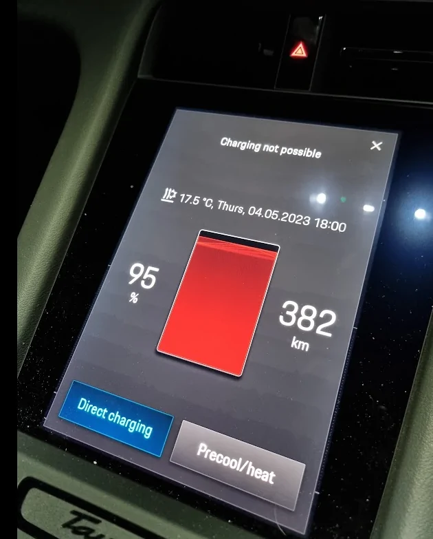

and
Porsche Taycan FIXED - Charge port reported open when closed 1684262538582
"Charging not possible" with external red led showing.
