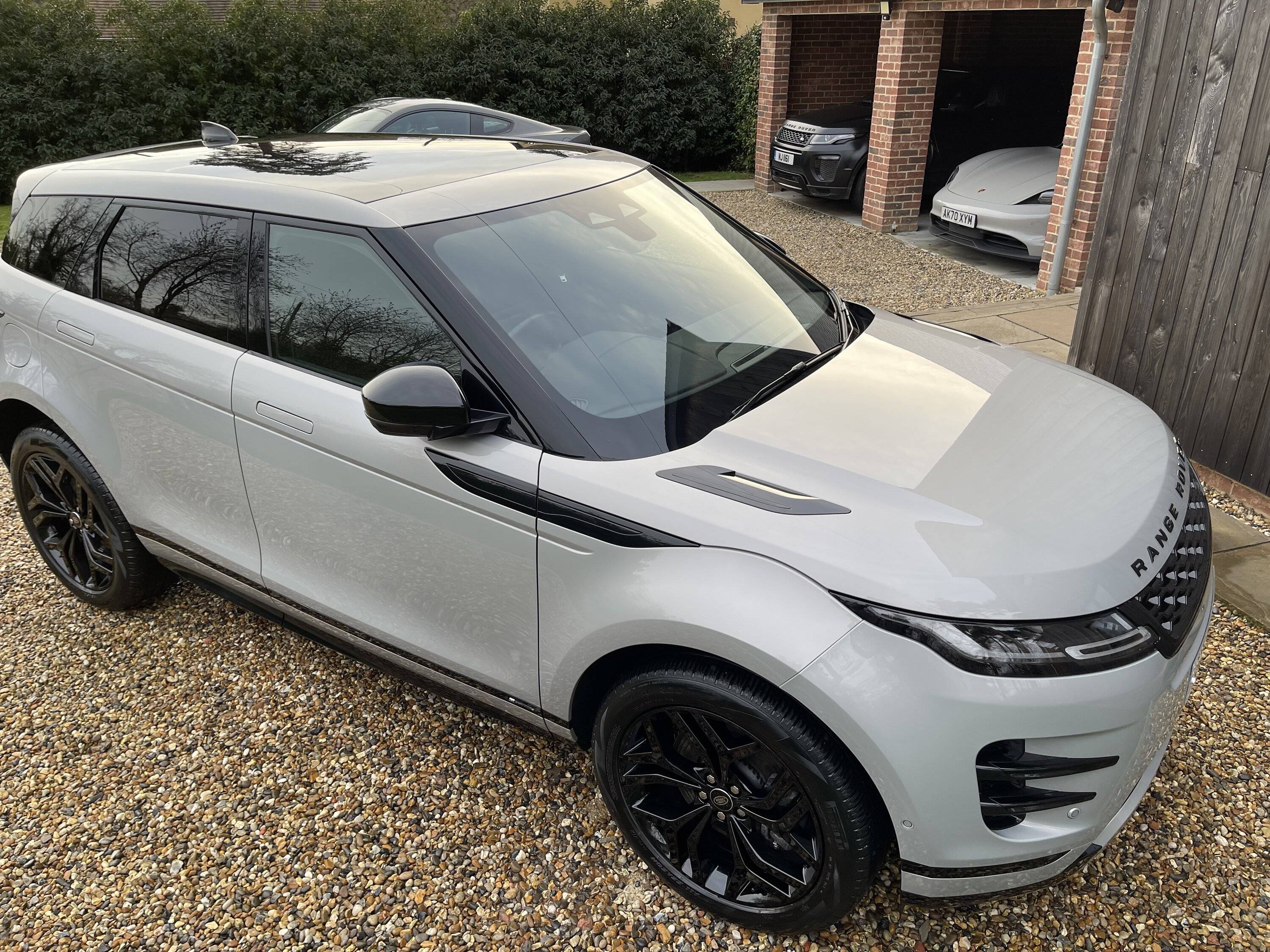

So, hybrid Evoque arrived and Mrs has been running around on electric all week. She is getting around 25 miles on 11 kw of electric so at 30p it’s £3.30 for 25 miles so not much cheaper than petrol. So thinking I will do the swop back to octopus intelligent.
Porsche Taycan Charging 2  EVs/ hybrid, Octopus vs OVO? IMG_0197
25 miles is around her daily use age as 2 x school run and gym and back in the middle, so the battery just about suits. Should get 30 miles when it gets warmer.
Anyone swooped electric supplier recently and does it take long? I see with octopus you need to go into the standard tariff initially so again anyone done this recently and how long before I can get off standard tariff onto OI?
