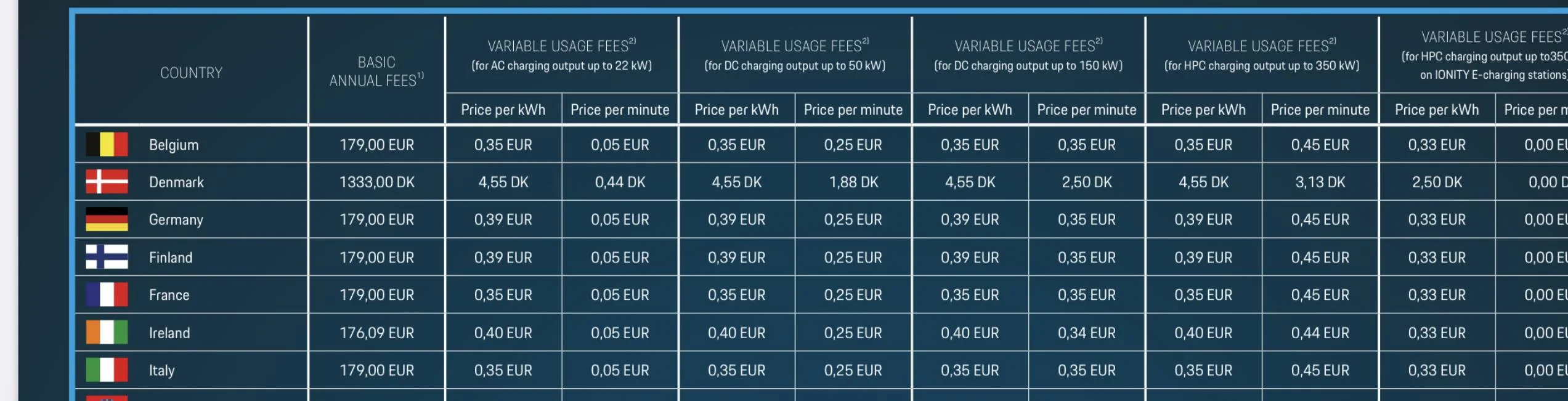

There is some charge differences in the Porsche Charging pricing. For Ionity there is just a straight kWh pricing, but gor a number of other stations in the network, there is a fixed kWh price PLUS a per minute charge. The per minute charge varies from 0.05 Euro per minute gor 22kW up to 0.45 Euro per minute for >150 kW chargers. So a differential pricing model is in place and could be further improved to steer cars to chargers suitable for their EV’s max charge rate.

Here is a screen shot of the charge rates here in Europe with Porsche Charging Service. And if you are not a member of that the prices are even higher.
Porsche Taycan Charging Etiquette 69B96A48-9B74-40AA-874A-919D4B7CBAB5

Good information in that table. Only issue is how the real charge curve looks? Some of these peak charge rates may be achieved for a very short time only.
Secondly some EV’s can not sustain fast motorway driving AND several high charge rates. BMW i4 M50 is one such case. High charge rates in spec, but throttles quickly on a long trip. No idea why but very annoying.
Taycan is such a gem in that respect. Long fast motorway trips through Germany and still consistent very high charge rates. Porsche certainly got that right!
