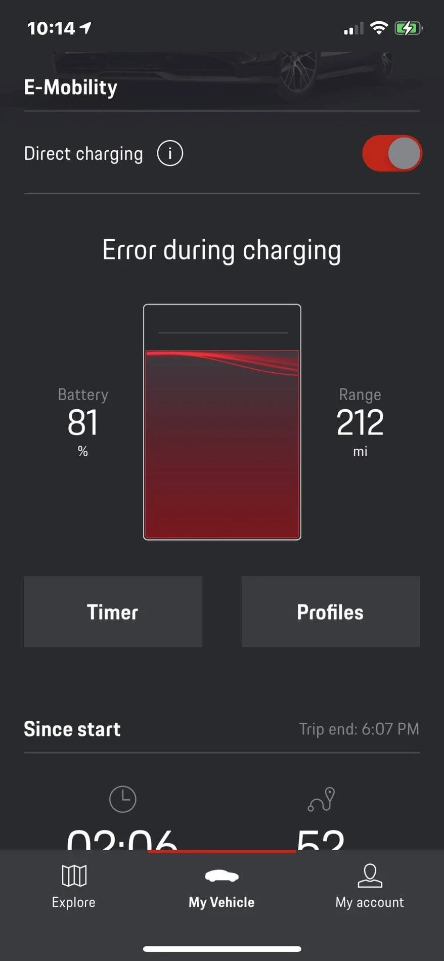

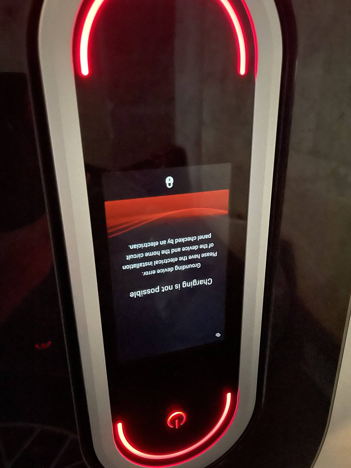

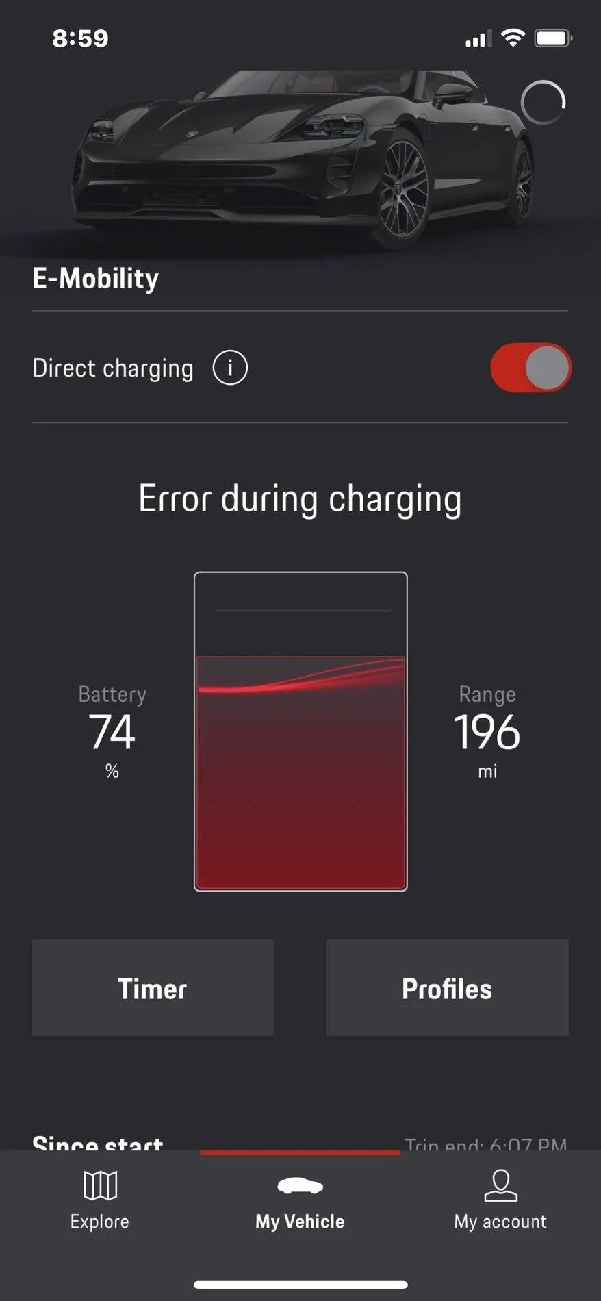

Argh. I'm still getting the elusive "grounding device error". Any ideas short of just replacing it with a ClipperCreek? Love love love the Taycan but the software and the charger leave a lot to be desired.
I'm using a 14-50 outlet and have had the electrician back to check it and the wiring all seems fine. The car actually charges successfully but then after the charge is completed the "grounding device error" occurs. The problem only occurs when using a timer - if I do Direct Charging from the app or car with the PMCC it works fine and I do not receive the "grounding device error".
I've been able to reliably reproduce the problem with the following steps:
1. Set a charging timer in the app. I generally use 85% and have the end time set for 7am. It doesn't matter whether I have one or multiple timers active. I generally just have one.
2. I use the general profile. Doesn't matter whether I use optimized charging or time.
3. The car charges successfully to the target charge rate. Sometimes it ends 1% below.
4. The charger shows the charging session was successful
5. If I leave the car plugged in, within about 45 min the fault occurs. The charger release button in the car turns red and the fault shows on the charger. If I unplug the charger from the car as soon as the charging is completed, the fault does not occur.
Here are some applicable screenshots. I have a service appointment in 2 weeks...

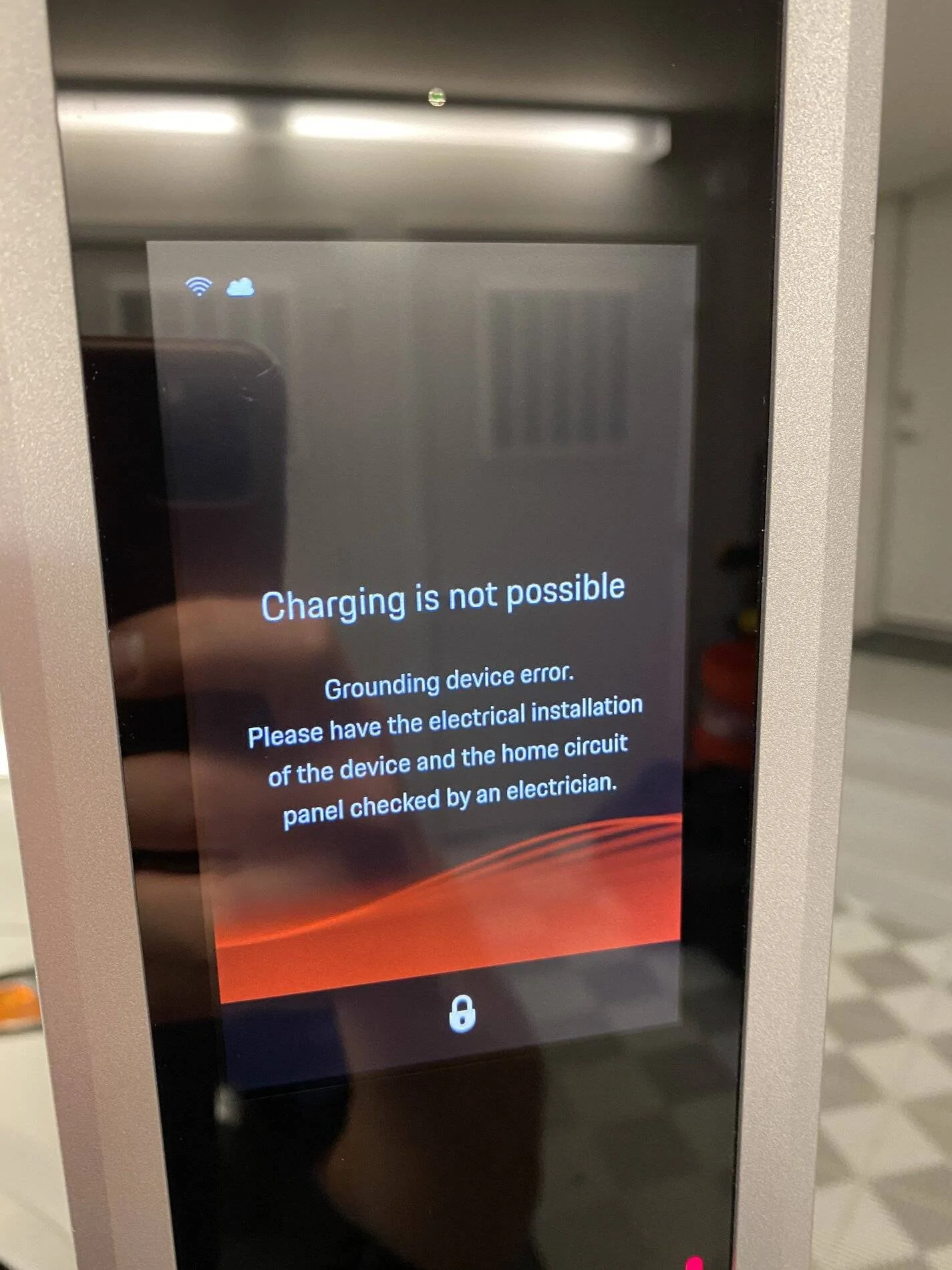

I have the Porsche-branded “pill” — which I believe is abbreviated PMCC — like the one in your photo.
We got our 4S in late August and have driven it 2600 miles. This exact problem just started happening recently. We had a reputable electrician install a 240 V outlet, and also install the pill. It has worked fine until recently when this problem has cropped up.
I cannot find any obvious pattern: sometimes it fully charges to 100%, other times it gets to 80%, and other times to even less.
The dealer, Marin Porsche, simply responded that I need to make an appointment for the car to be tested. I suspect this would be a waste of time, since the problem might be the pill rather than the car.
it would be easier just to have the electrician come back and have a look at things, but if anyone here has any suggestions, I’d be very interested.
