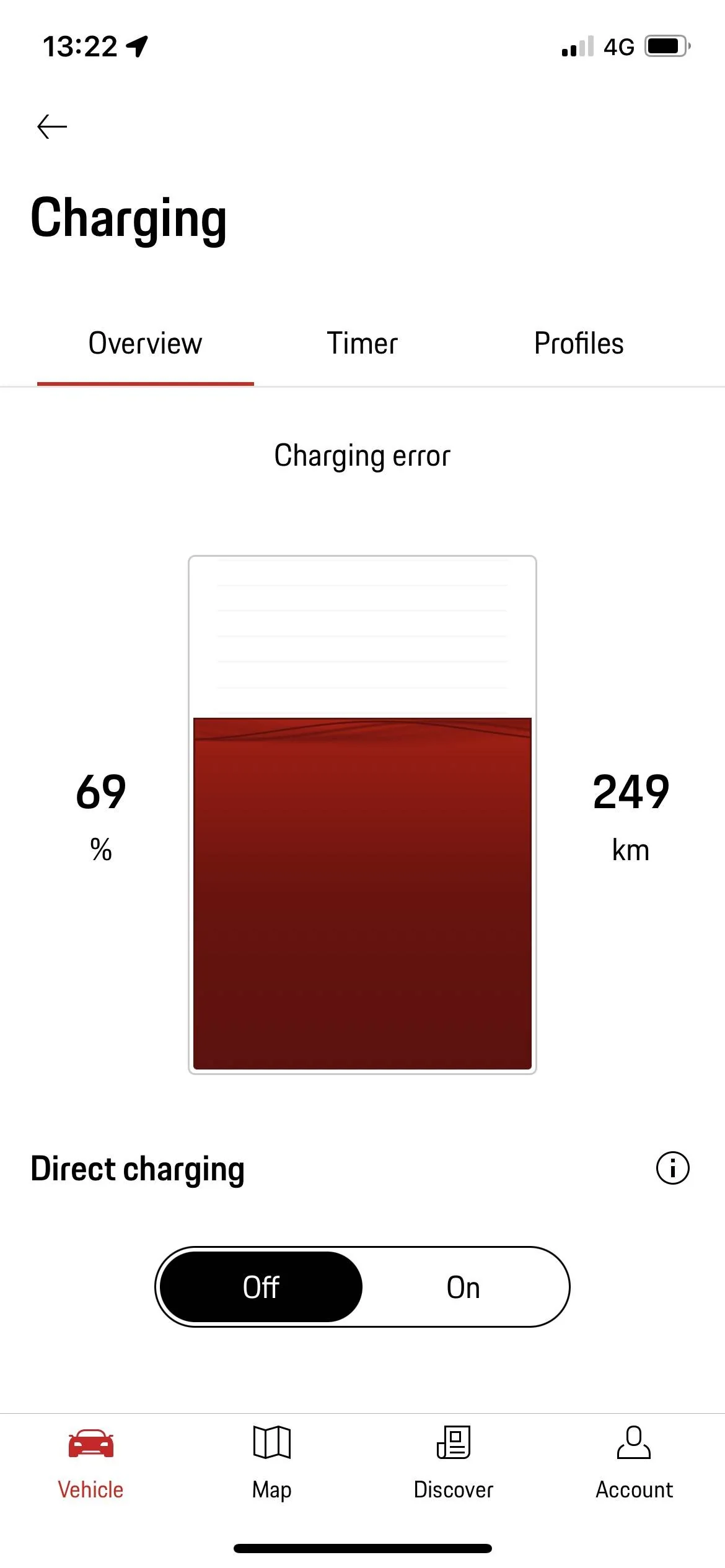

I have a JuiceBox48A hardwired installed. The car (2022 TTS - don't have the colored icons update yet) has the 22kw charger. After a 1hr drive with extra 2hrs sitting in the car in a parking lot with AC/carplay on, I got home with ~46% and plugged it in as usual. The car started charging fine.
Later in the day, I went to check something else in the garage and realized that the JuiceBox was off. Looking closer, the 60A fuse in the main panel was blown. I reset the fuse and then the car showed me a "Charge not possible" error in the center console. The chargeport light was also solid red. The car did manage to charge up to 77%. I have a simple general profile enabled with min charge of 80%
At this point, i tried the following and I still get the same error:
- other charge port - same result
- reset the JB again and gave it a good smack (this is literally the recommended official procedure by EnelX - it fixes a stuck relay issue their units have)
- tried the PMCC that came with the car on a 120v circuit to see if it can trickle-charge - same error on both ports
- disconnected the 12v battery for 4min
- turned on DirectCharging in the center console
- Went on a test drive - car shows no errors or issues and power is as expected on a few soft launches.
I suspect the 22KW onboard charger is a gonner, so I'm going to try the DC chargers around town to see if that would work. First dealer appt available is in ~4weeks so I'm hoping to at least survive on DC charge till then...
I'd appreciate any other ideas from anyone to try and get by until the dealer can see it.

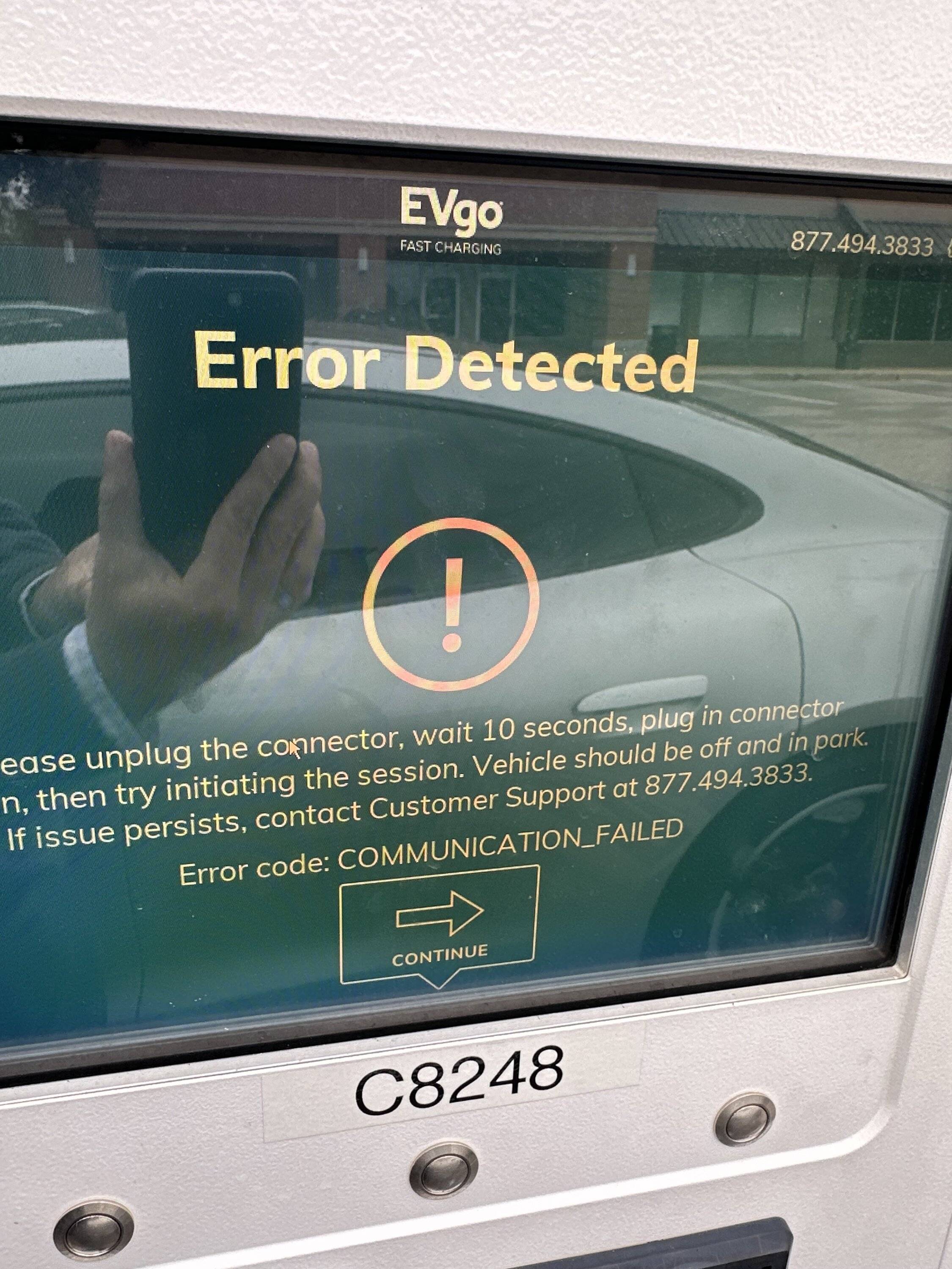

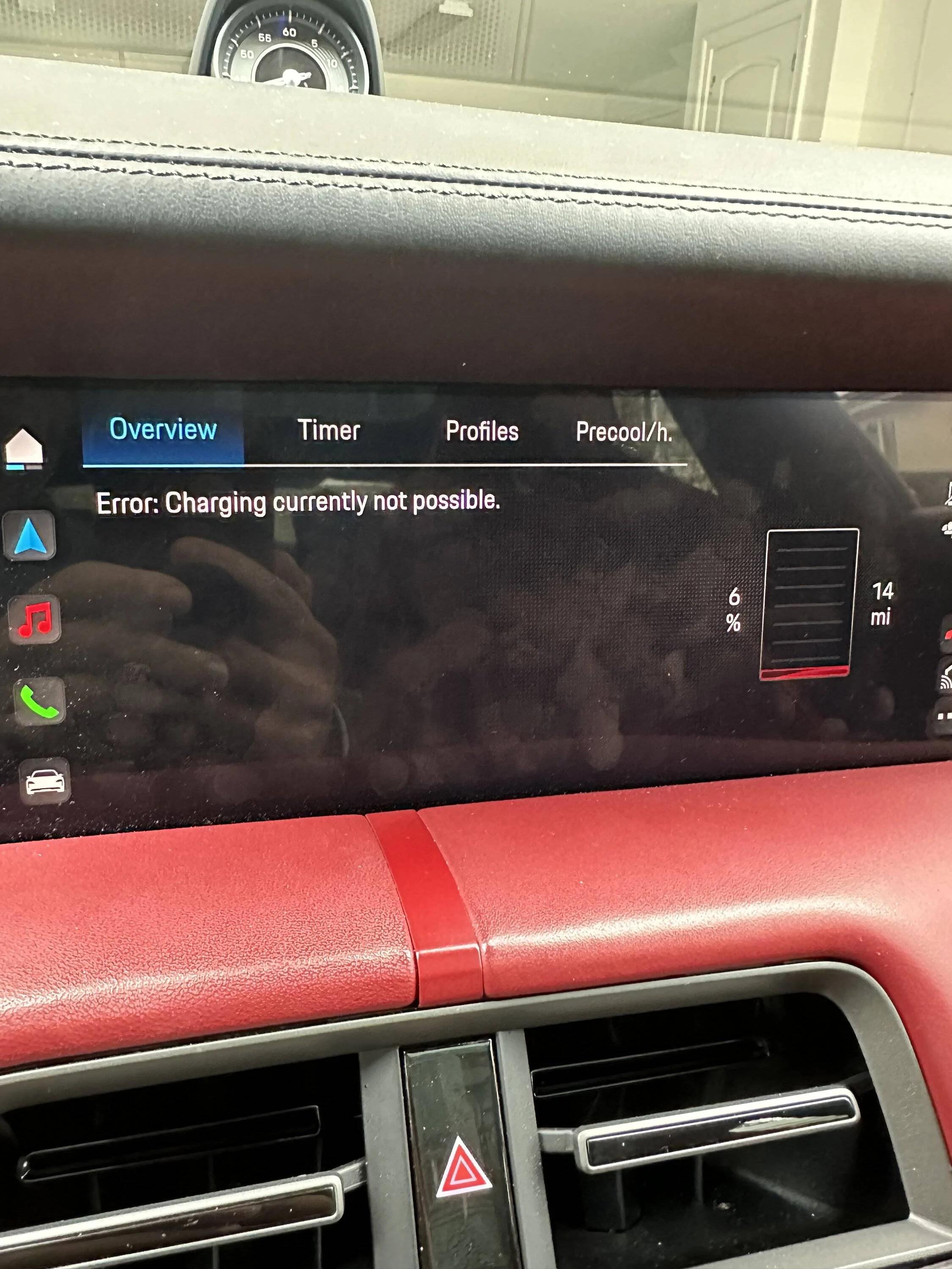

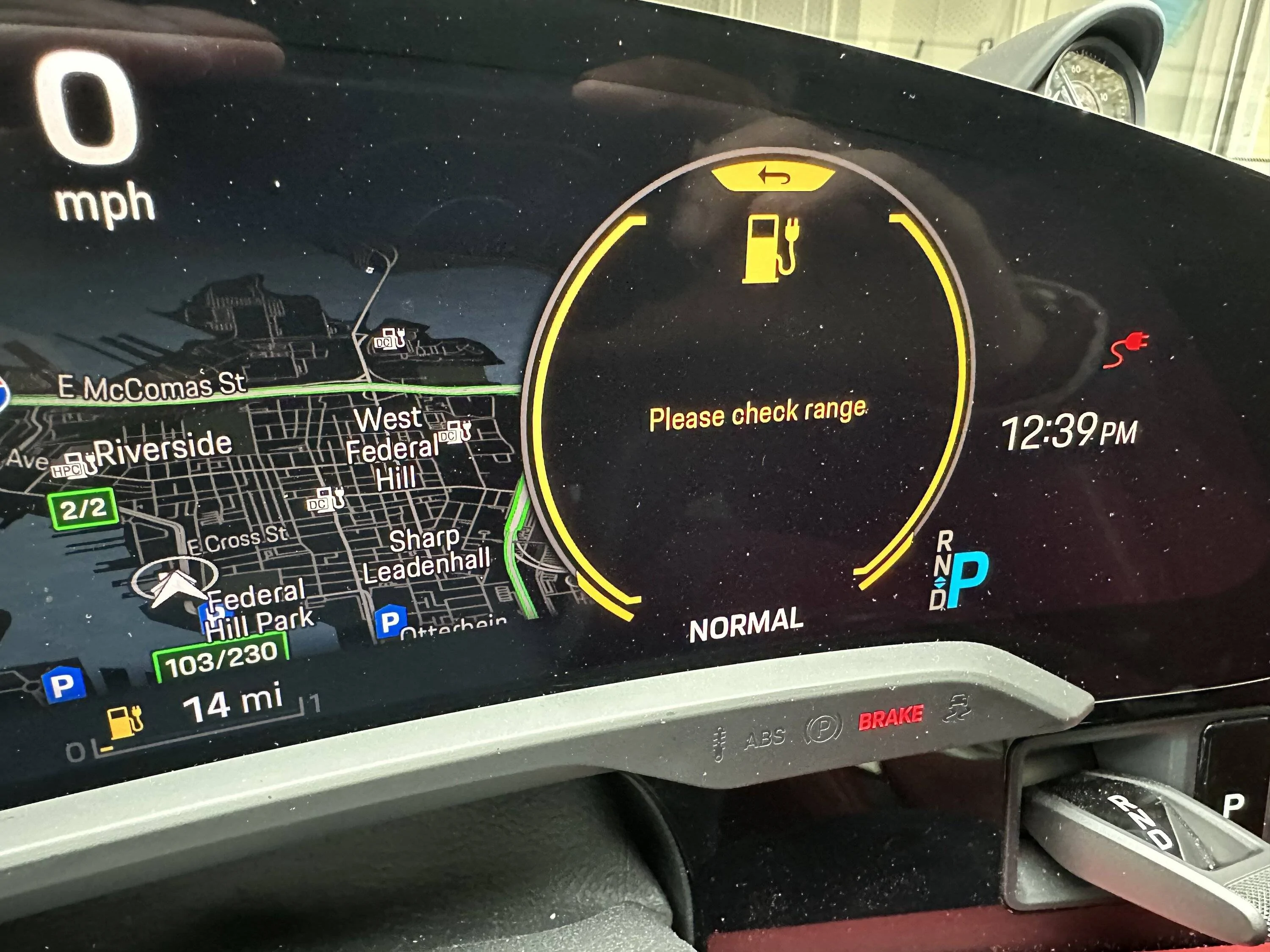

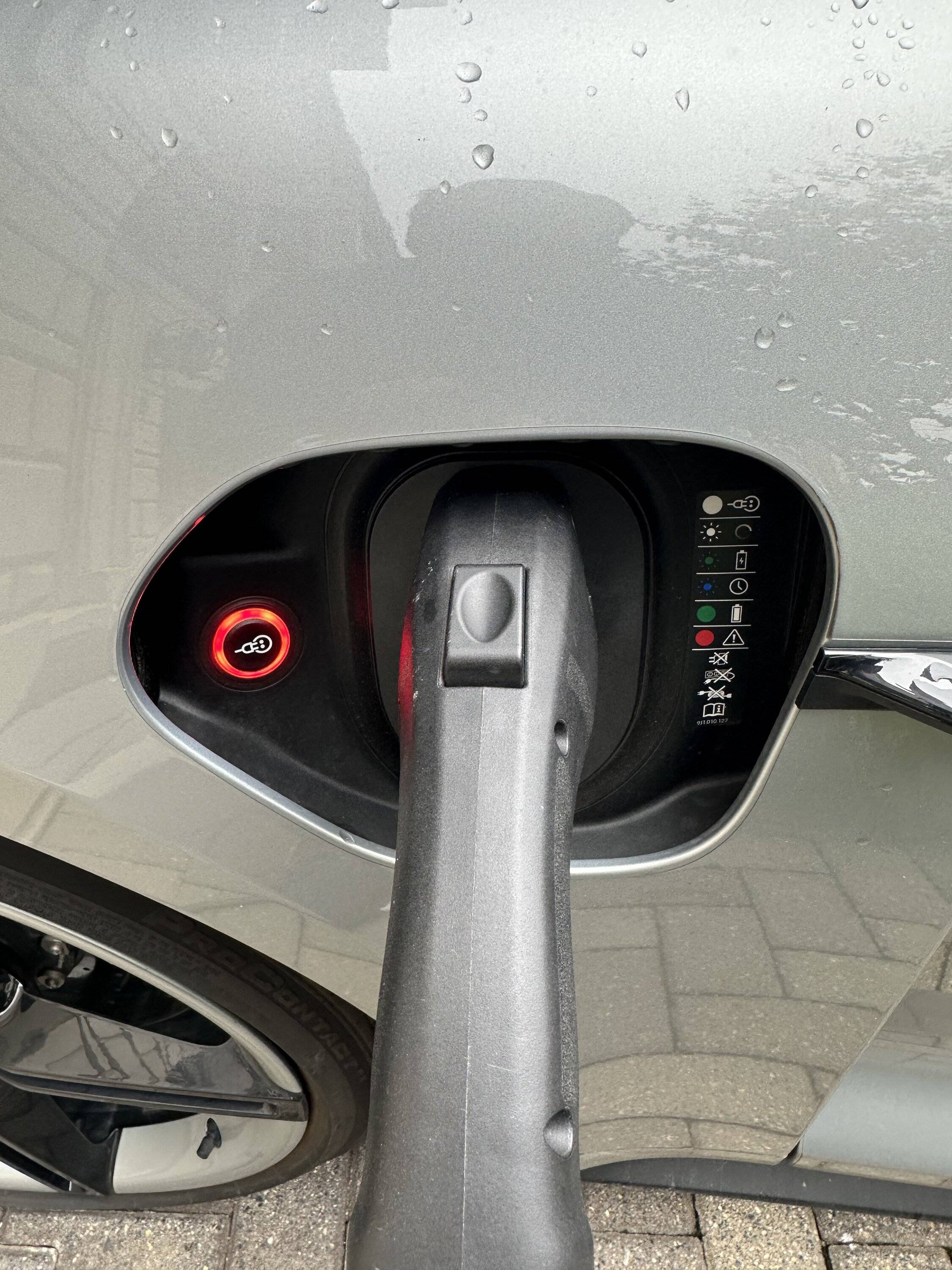

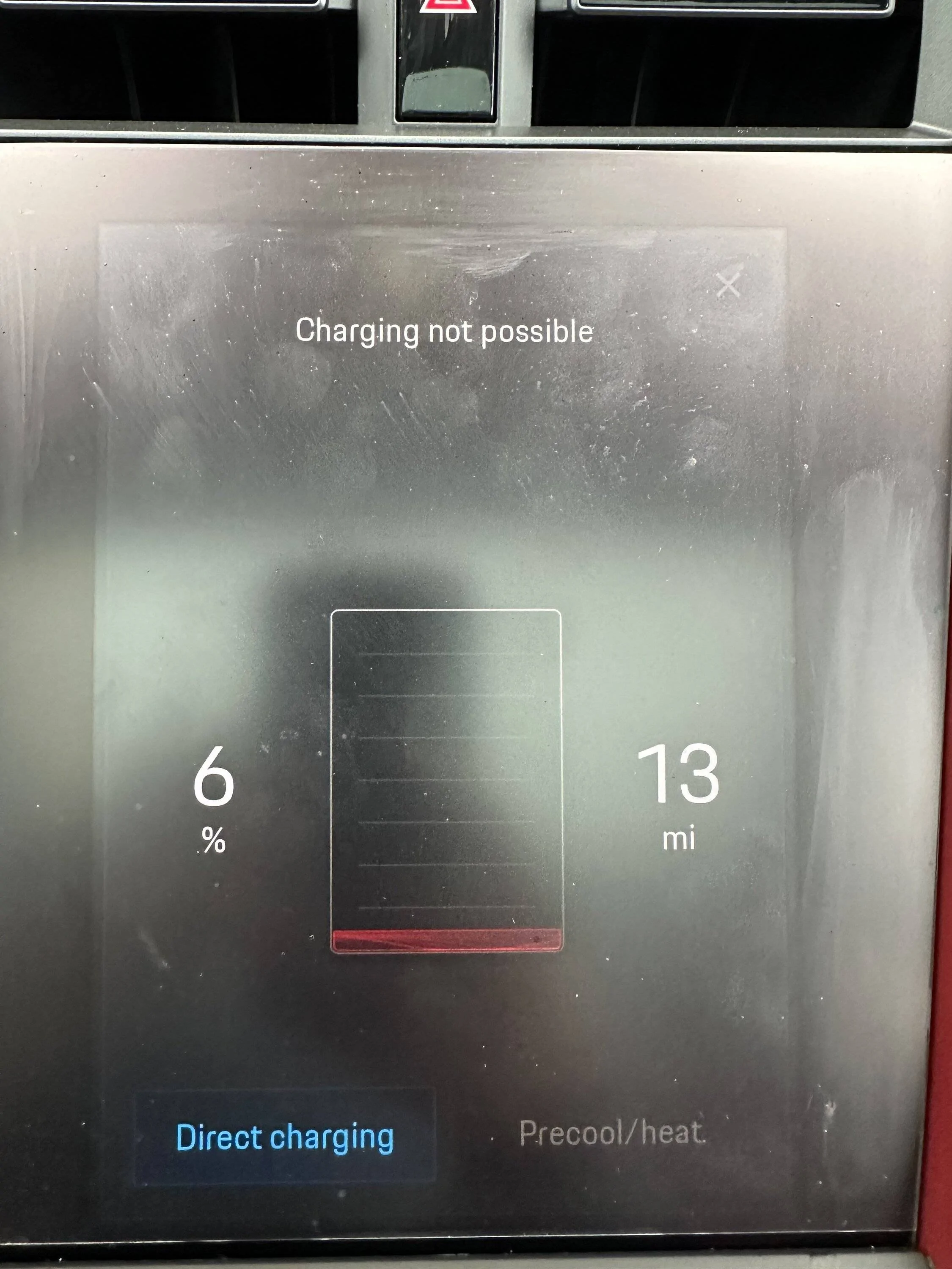

Add me to the list. Breaker tripped while charging on AC overnight. Burned up my range driving to a DC charger to see if that would work. Nope. AC fails on both sides and DC fails. I've also previously had the HV Heater replacement and AC pressure sensors replaced. It's really fun but it's the least reliable car I've ever owned.
