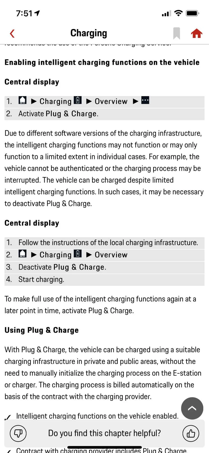

I think it's Porsche's fault. I have the same error message, and my Charing NA app shows an error for 'my vehicle', saying there's a back-end issue in the Porsche server or so. I can trigger charing by the app after turning off plug and charge option in the car.

Same exact thing here. I've gotten that PROXCAN error when trying to use Plug & Charge. Charging NA app shows backend server error in My Vehicles. If I turn off Plug & Charge and manually initiate from Charging NA app, I can charge.

This is great advice. I have a ‘21 4s with extended battery. It seems that this configuration is affected the most. I also don’t have any option to disengage the direct charging from the PCM in the car directly due to this configuration. I did follow your advice of reinstalling the Porsche Connect App and not changing any settings. It worked this am but let’s see. Will keep you posted. ?
Do you have a 21 4s with extended battery? If so where do you turn off plug and charge? Thx.

Found it! Thx for showing me what numerous Porsche employees couldn’t. Will keep you posted. Hope this works.
So far so good. Work two days in a row now. All I do now is initiate a charge session through the Electrify America charge App.
