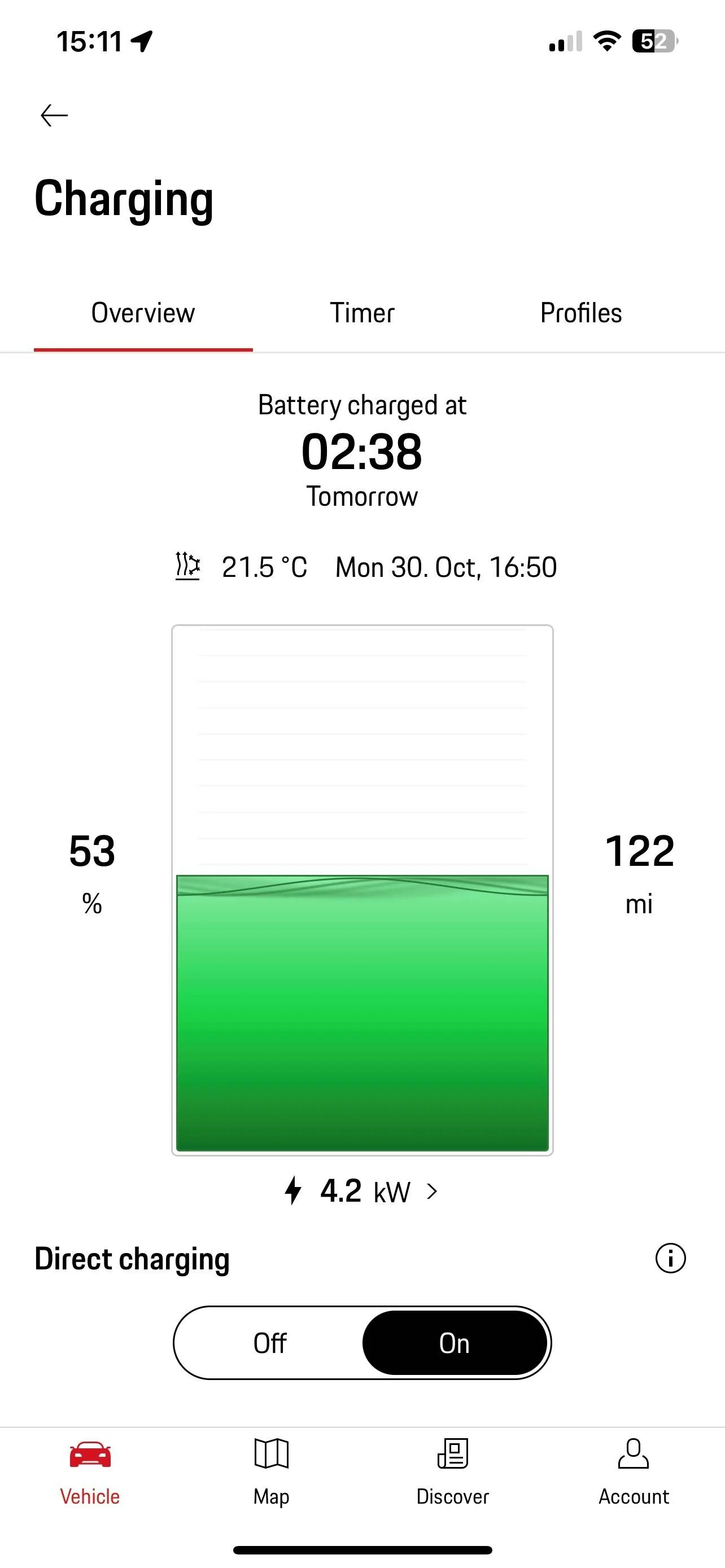

Hi all, I've just joined the forum.
I took delivery of a 2023 Taycan 4S Sport turismo with a Performance plus battery.
I'm using a 7KW charger at my office , but the car only seems to be charging at 4.2 kw or 0.2miles / minute !!
We have another fully electric car, BMW IX3 and that's charging at 0.33 miles / minute. So 40% faster than the Taycan.
Any suggestions please as to how to improve it on the existing 7KW charger ?

Be careful comparing two different cars using the .2miles/minute vs. .3 miles/minute display. Each car has a different size battery, and has a different level of driving efficiency. Apples to oranges. If car A has a battery that is double the capacity of car B…you get the point. OR if car B has double the MPGe…. Both examples have too many variables.
What you should be looking at is KW. On a 7KW charger you should see 6KW ish on the Taycan’s display.
Generally speaking, Level 2 chargers, such as the one you’re using are very stable and will deliver the same power every time. I cannot explain why it is only showing 4.6KW. I would check to see what KW the BMW is receiving.

Also, which “Porsche cable” are you using. If It’s the mobile charger plus, ensure it’s at 100% and not at 50%.

you really need to try a different 7kw evse. That will give you a much better indication if it's the evse or the car.
