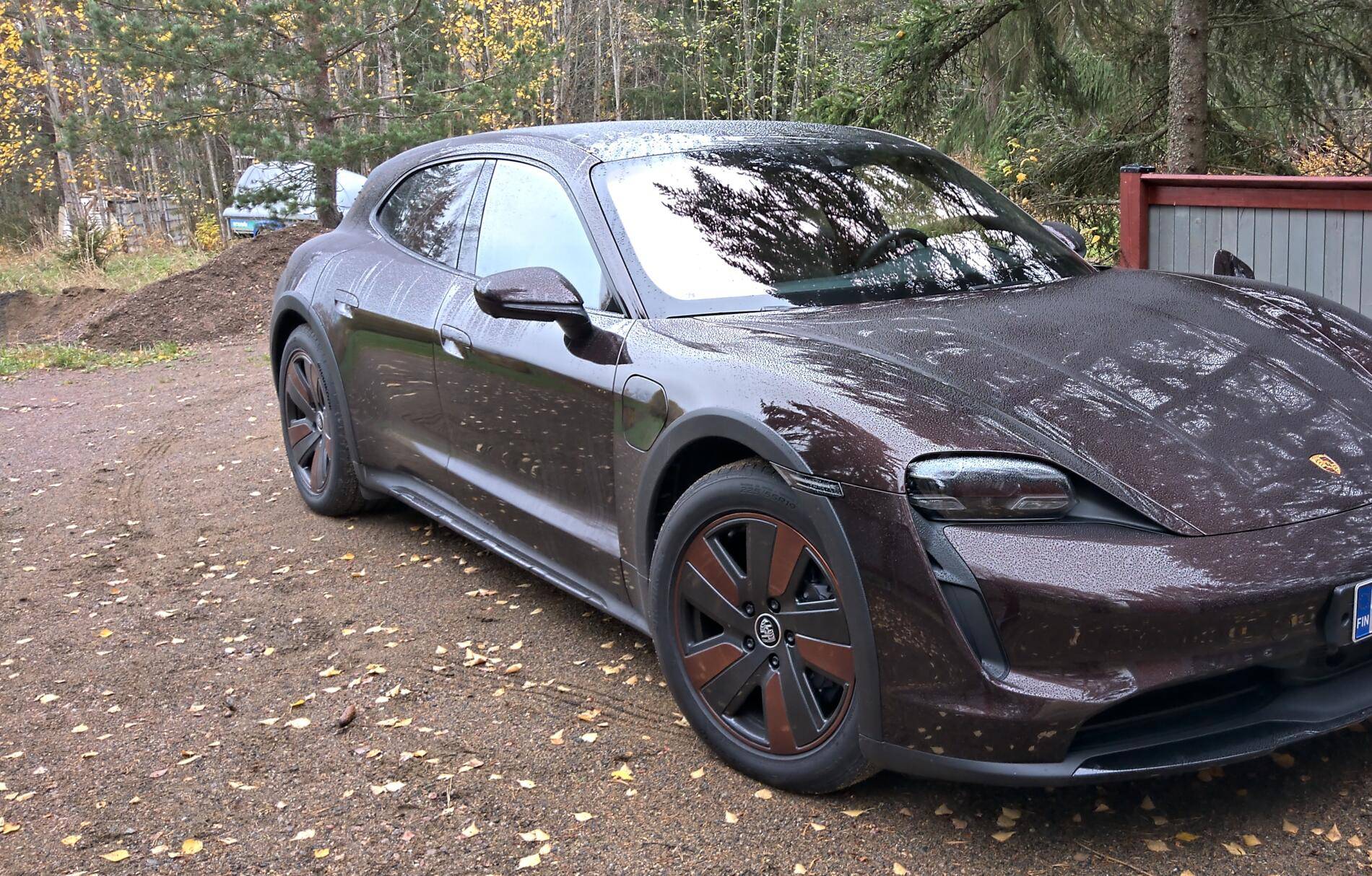

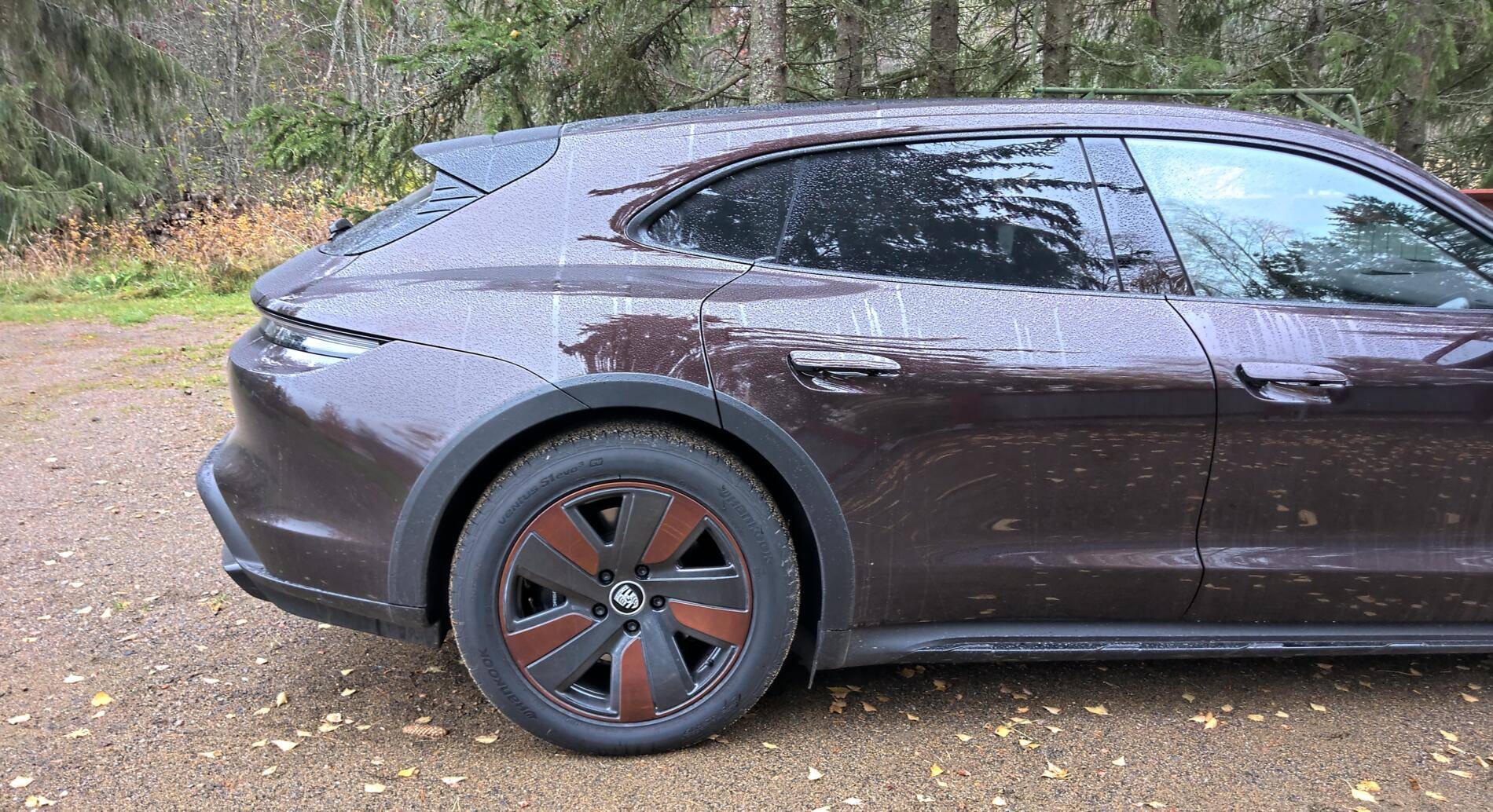

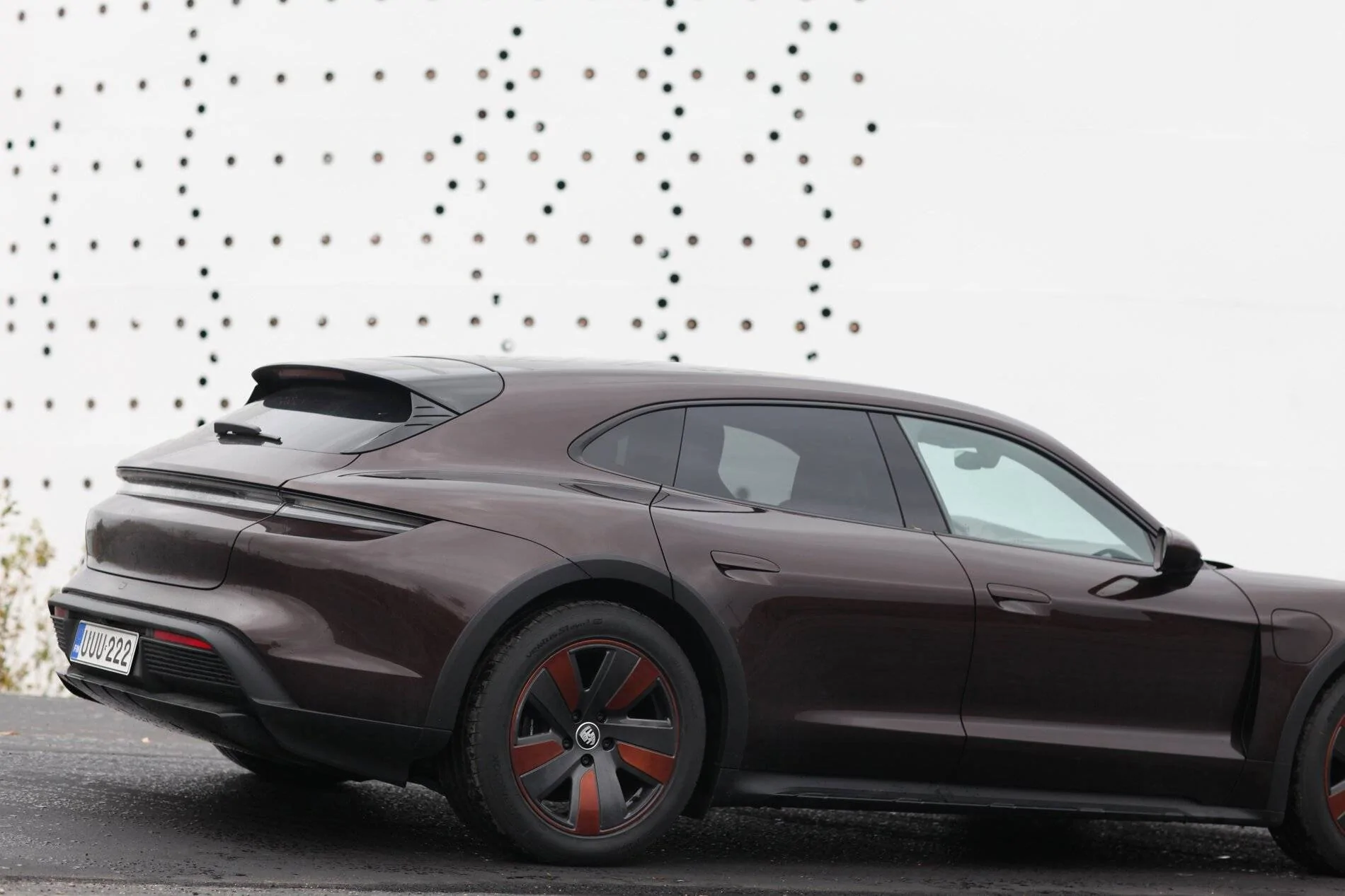

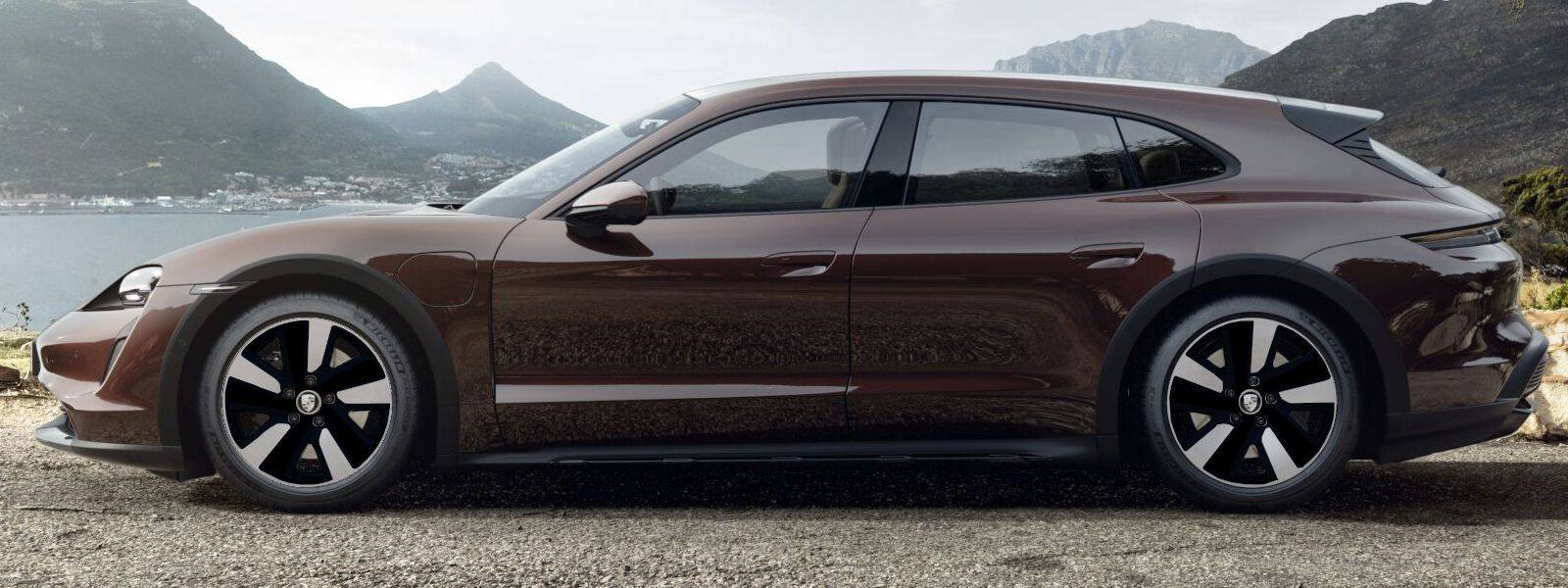

Had to do some gravel mode first - maybe a proper photo shoot later. But here's a live paint job on the 19" Aeros. The accent color is copper, here not very shiny because of the gravel driving and some misty rain.

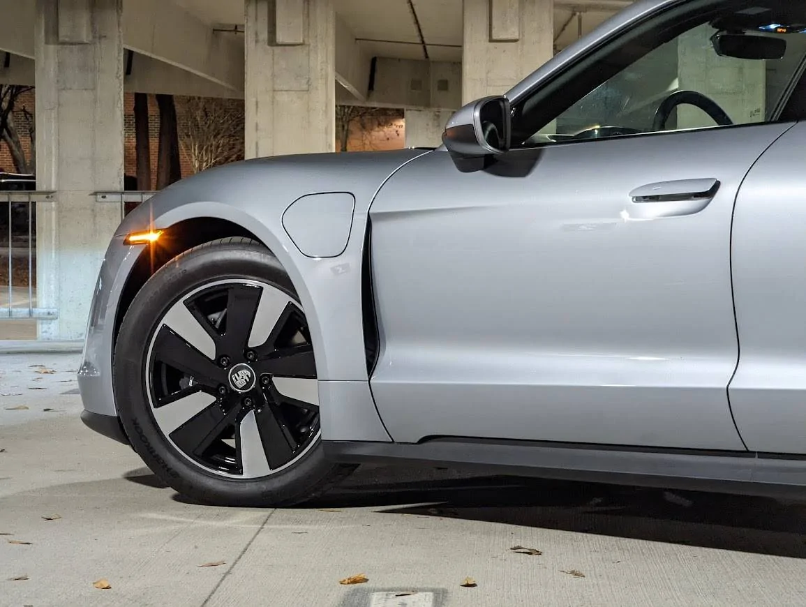

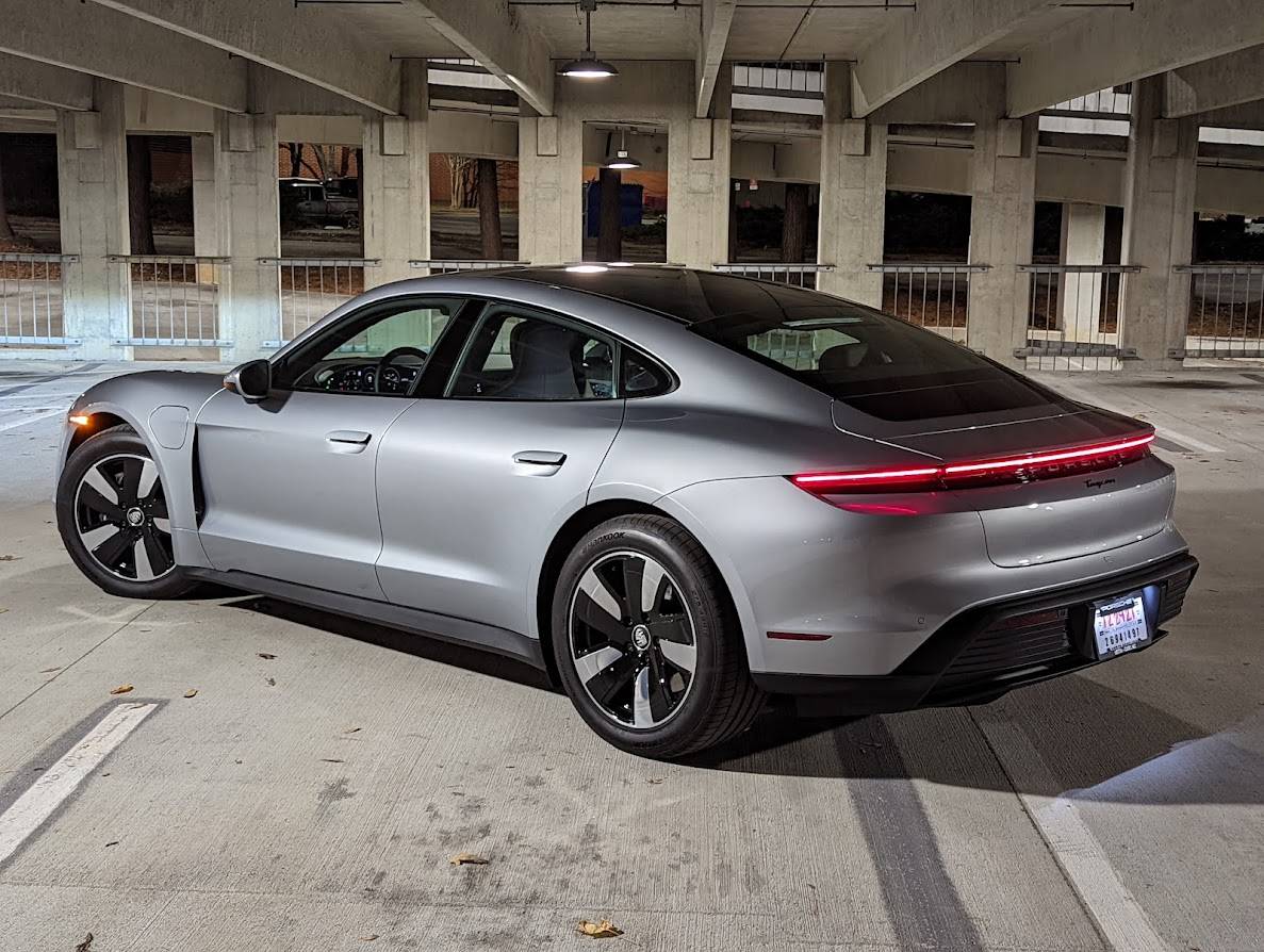

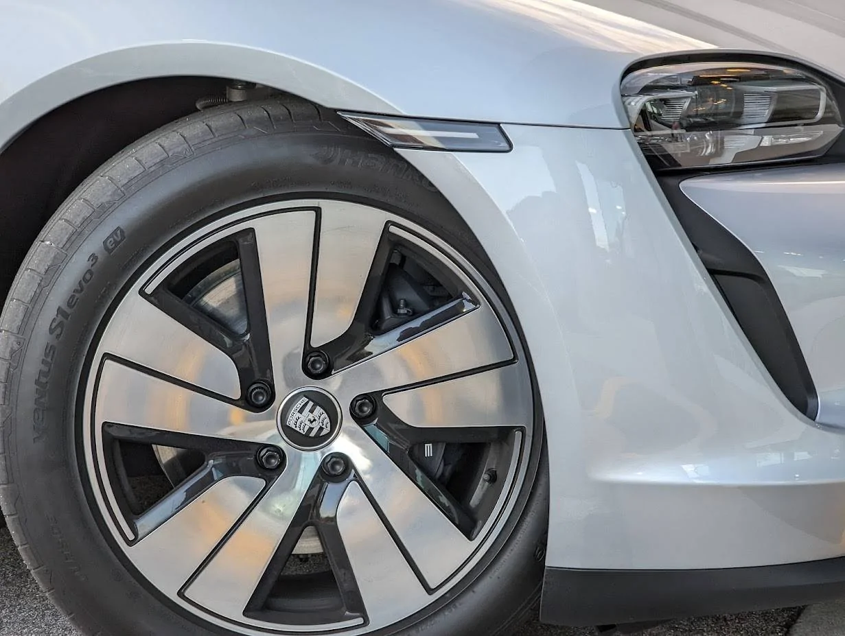

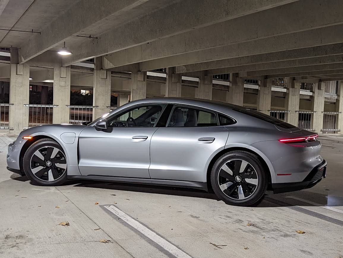

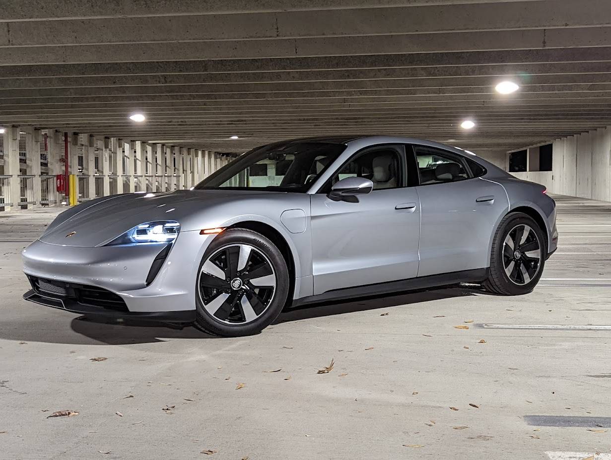

Phew! That was a tiring 7 hours spent lying on the garage floor... I think the results look great but this reverse of this would have been way easier and I wish I had done that first just to that look too to decide which I liked in person. The 3m 2080 gloss black wrap matches the paint on the wheel perfectly and you can't even see the overlap where they meet.
Lessons to learn from:
  • Get a jack and remove the wheels so you can comfortably do this on a table indoors, if you are a perfectionist this will save you so much trouble and discomfort.
  • Find a good way to mask the gloss black surface of the wheel to avoid scratches with the knife
  • removing the wheel center cap made it much easier, this can be done by prying around the edge with a dull thin blade or tool
  • removing the protective plastic after squeegee-ing before slicing makes it much easier to cut further minimizing chances of scratching the paint.
  • use a heat gun or hairdryer to work the film in tricky spots to avoid bubbles and wrinkles.
  • TAKE OFF THE WHEELS
  • try doing the reverse pattern first if you are curious because that would take 15 min per wheel
