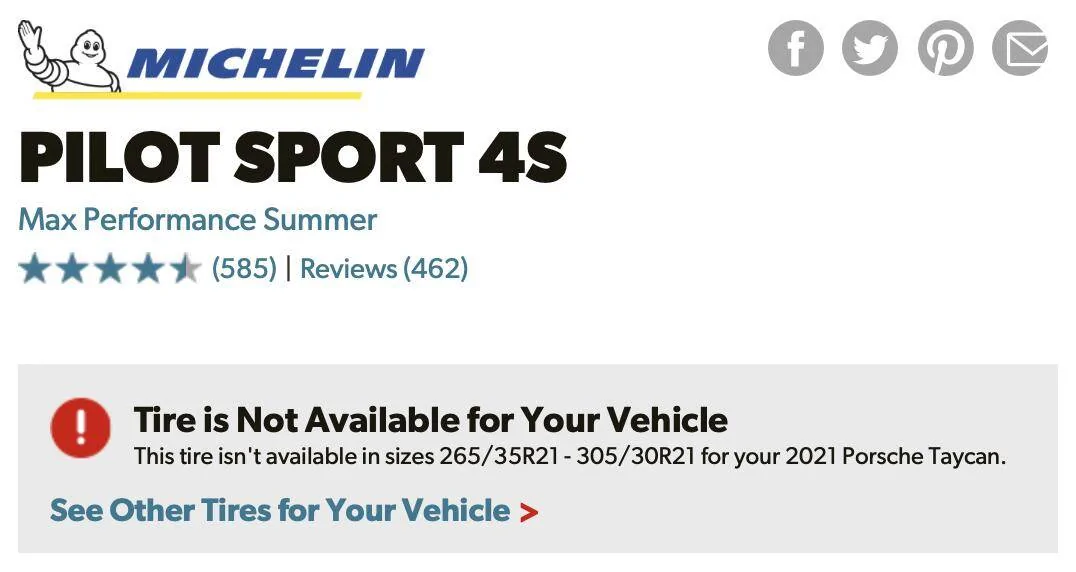

Update: both rear tires being replaced, fronts do not need replacement at this time.
I would have done all four if I could get PS4S but...sad face!

Sucks. That's one of the reasons I got the 20" turbo aero wheels.
96
3,526
7,950
Dublin, Ireland
www.targatrips.com
Granted no Michelin is available yet for 21" wheels – but just to note its only the Michelin Pilot Sport 4 (not 4S) that is NF0 certified for use on Taycan.
