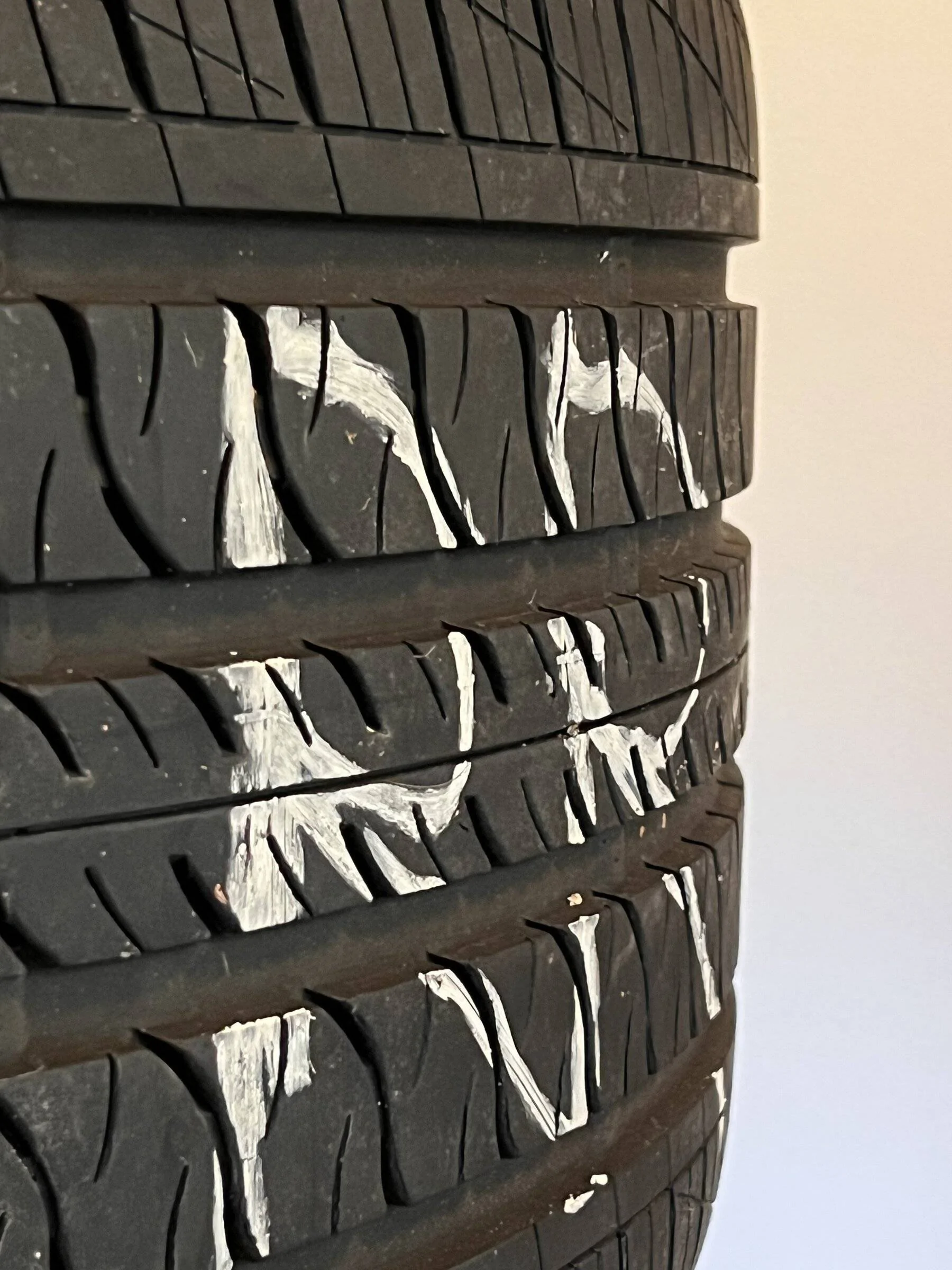

Final update on this - got the car back. Turns out both rear tires had wear spots down to the cords, so the wear was at least uniform.
Opted not to do an alignment for now.

Curious why you opted out of the alignment. Did the service center to a realignment check? If so, was it within specifications?

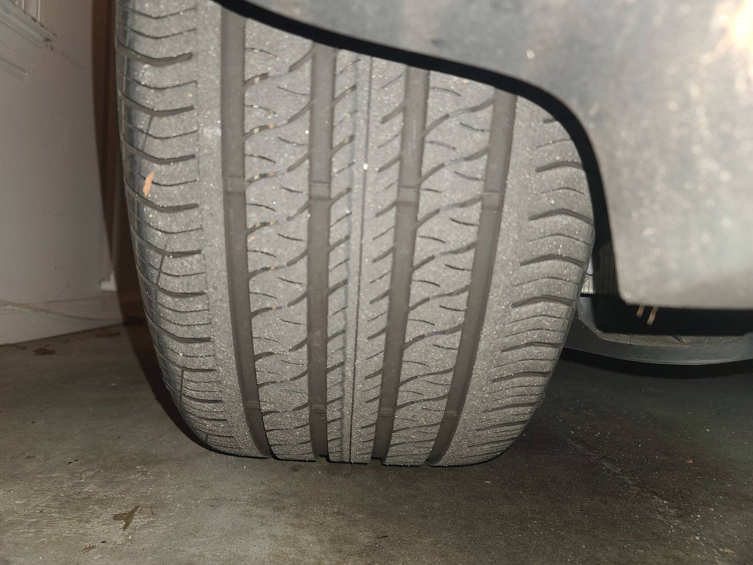

Really wonder how much of the wear was driving style, alignment or 21" wheels. Read this thread and looked at my 20" all season Continentals on my 2021 RWD 7,200 miles. Mine still look pretty good.
A few resaons.
1. It would have been $530 to align and an extra day or two without the car due to service workload. I wanted it back and didn’t like the price.
2. Since both tires ended up with the same wear I am less concerned about one wheel being “rogue”
3. I absolutely hate it when I get my car aligned and the steering wheel comes back off center. Right now it is absolutely perfect. I love the way it drives right now and don’t want to mess with a good thing.
I’ll watch the wear and I’ll consider getting it aligned at a trusted performance shop.
