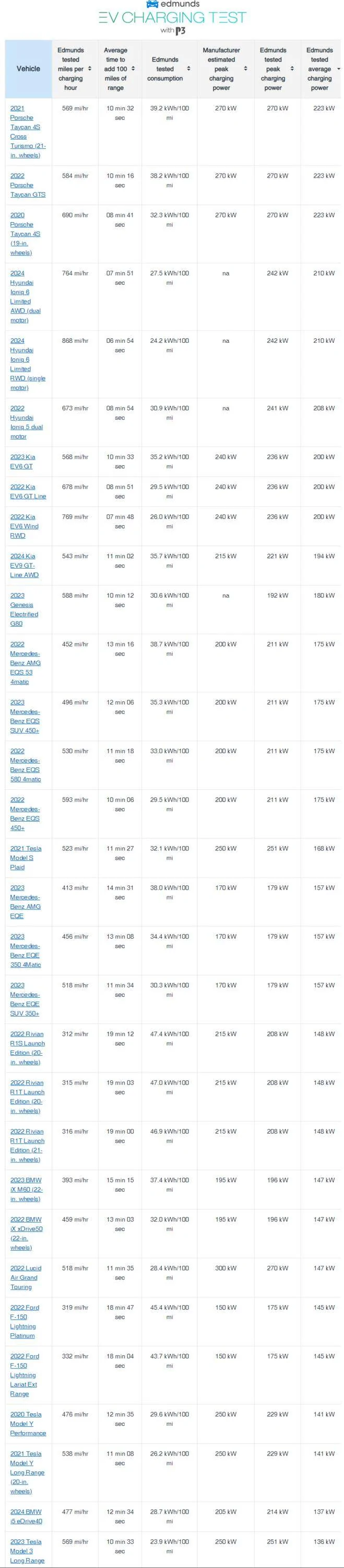

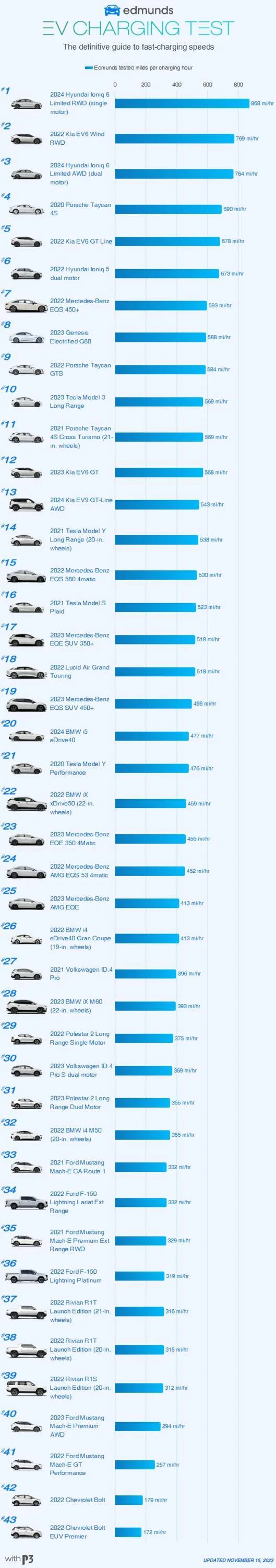

Interesting results:
Porsche Taycan Edmunds Test: How fast does each EV charge? - Article 1700500912427
Taycan's looks to have the highest tested average charging power.

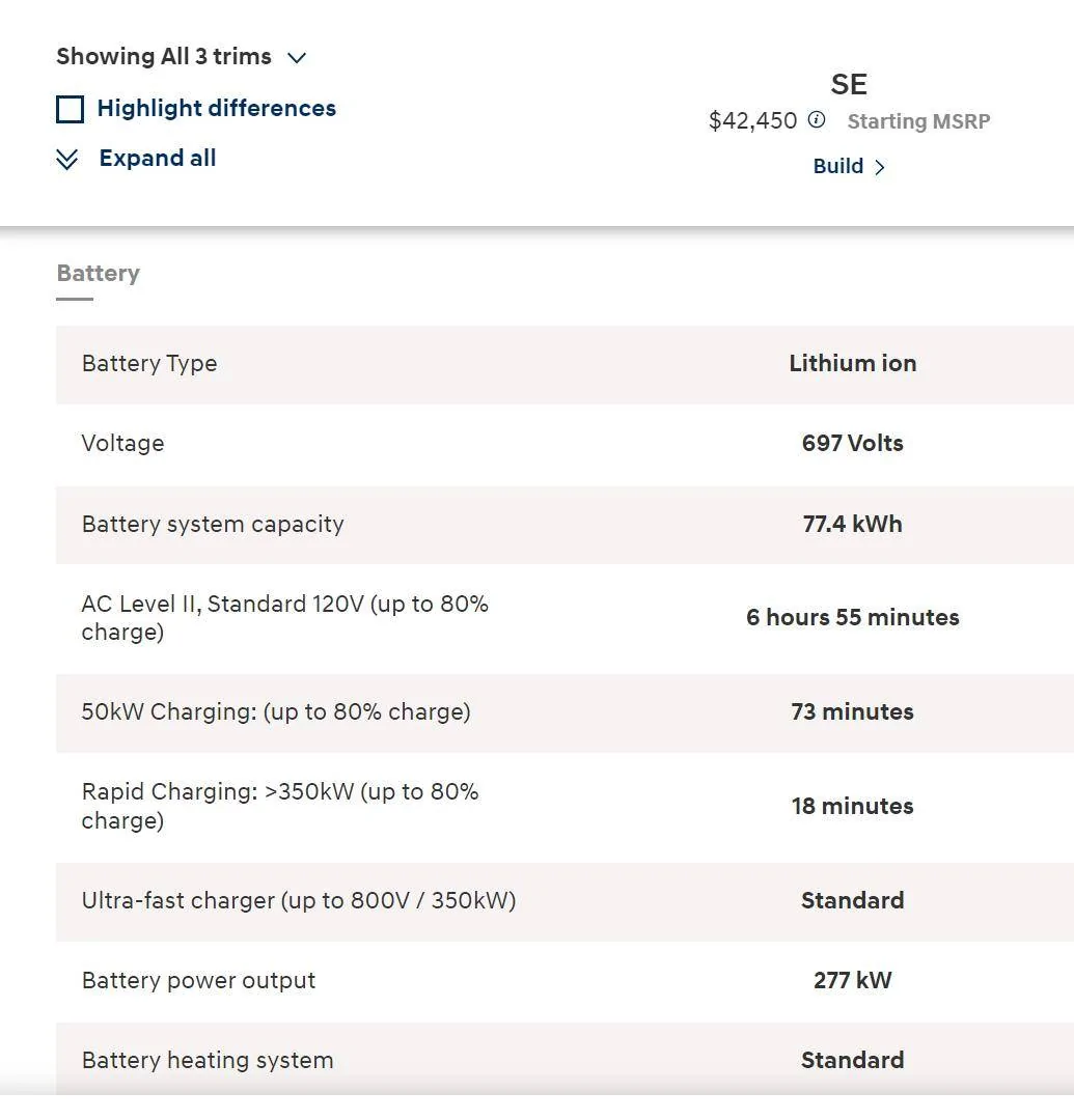

I am not following why Taycan would not be the fastest in all categories.
I understand that Kia/Hyundai use 800v architecture, but why are they so much faster, is this due to conservative charging curve for Taycan as it tapers off much more to potentially protect the battery, since software controls the curve, even though the architecture can take a more aggressive and faster charge. I understand that with software updates they are making overall time to charge faster and faster based on the data that they get on how the architecture is responding to fast charging from Taycans on the road.
I think, that explains it, it has 350kw rated charger standard vs. 270kW max we technically get:
Porsche Taycan Edmunds Test: How fast does each EV charge? - Article 1700569728541
I just tried to test charge at our local recently built EA stations and I get 200kw as I start charging at 15% SOC and that is way faster than I need for local driving, so I only use 5 min of this. However, when I drove a loaner Taycan with services not active on it, somehow, I could not get more than 50kw at every EA station I stopped along the way of a 750 mile route, so that was bad.

From my reading it has to do with range added. Because the Kia is more efficient the rate of range added is quicker.
I could be wrong 🤷‍♂️, just how I interpreted the results.
100% correct -- it is data weighted by efficiency. So while the Taycan might add more kWh (energy) into the vehicle faster/quicker, the energy it has added back in won't take it as far. When adjusted for efficiency, the energy added into the Korean cars is slightly slower, but more useful (range/miles).
Exactly, that's why I put the second chart there to explain more. Going by the highest "average charging power", Taycan is on the top, but the "tested consumption" affects the "miles per charging hour" results.
