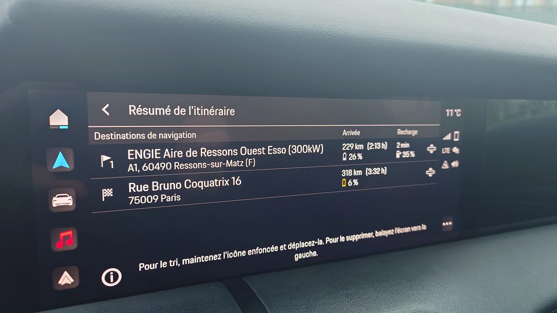

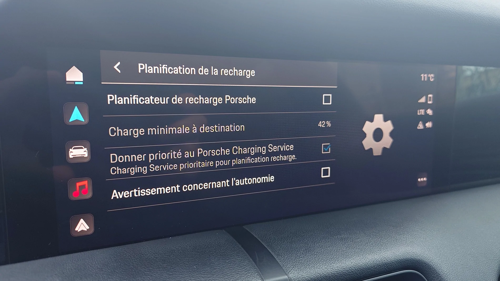

I want to share a strange experience on a round trip I just did: about 350km each way, requiring one charging stop.
I decided not to use the charging planner, to avoid NAV crashes. It was off both ways, I checked that several times...
Porsche Taycan EU/UK: Ongoing navigation issues [Solved with PCM v3892] 20260224_084209930

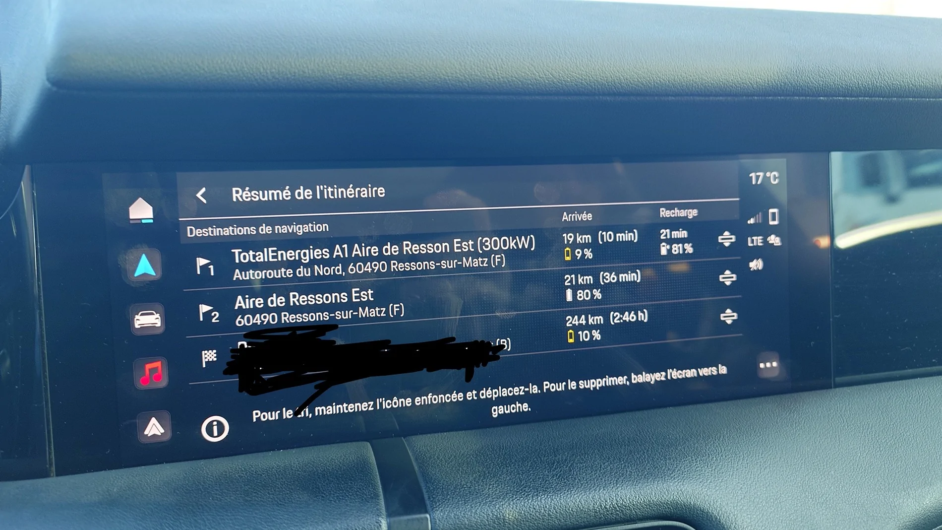

Indeed, NAV did not crash a single time on both trips. But the strange thing is that:
- when adding manually the charging stops as a waypoint (since charging planner is off), NAV interprets them as charging stops
Porsche Taycan EU/UK: Ongoing navigation issues [Solved with PCM v3892] 20260224_084201663
Porsche Taycan EU/UK: Ongoing navigation issues [Solved with PCM v3892] 20260225_120557575~2

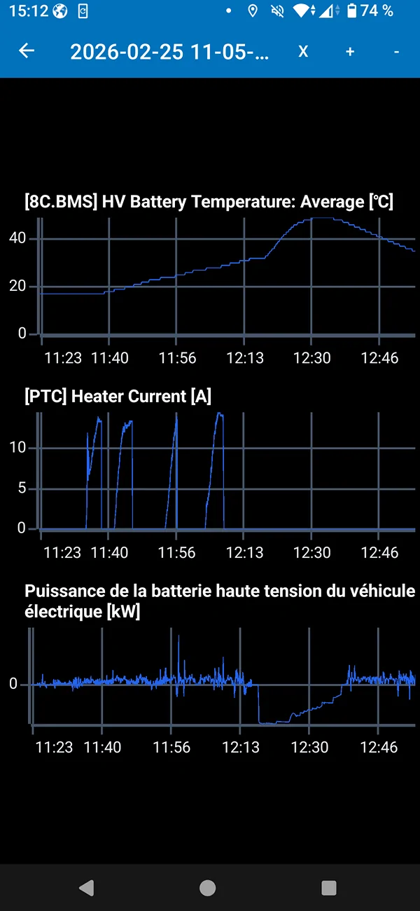

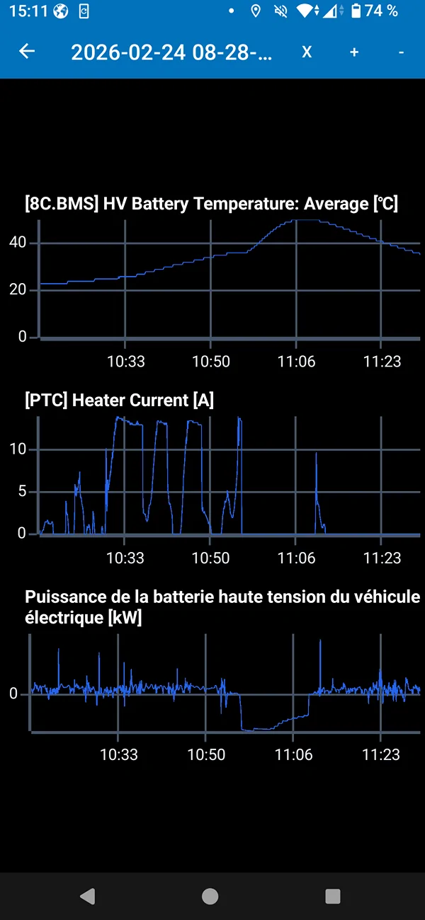

- and it does precondition the battery😳
Porsche Taycan EU/UK: Ongoing navigation issues [Solved with PCM v3892] Screenshot_20260225-151211
Porsche Taycan EU/UK: Ongoing navigation issues [Solved with PCM v3892] Screenshot_20260225-151144

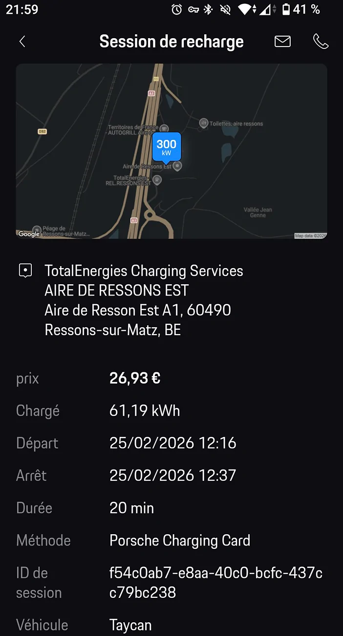

Both times, heater started as "normal" and battery temp. was right on for the stop. With an average of more than 180kWh from 8 to 82% 😇
