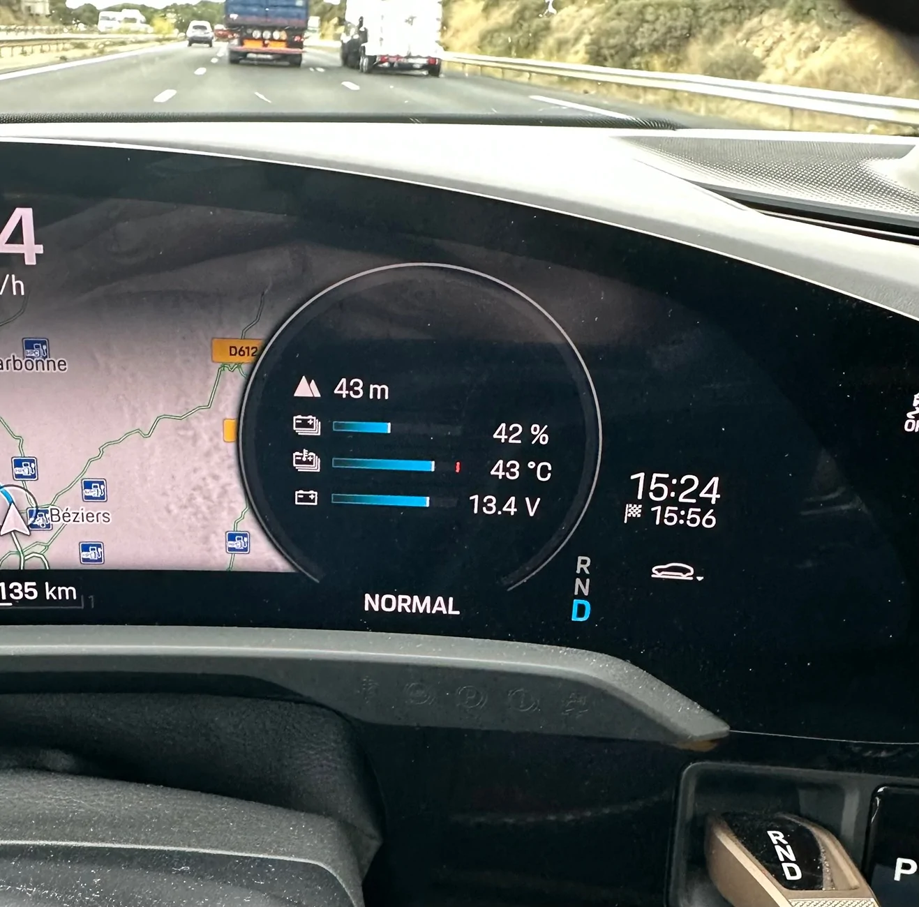

I have all of the above issues with the navigator hanging and being extremely slow for some time now. Yesterday and today I also experienced a new issue when navigating on a longer road trip of about 900 km. The PCM plans and navigates to Ionity chargers, that have been in place since 2020. So no new chargers or location. However I noticed that the navigator stated I had 1minute to drive to the charger but the distance was 0m! So I was in place and charged.
The battery had been preheated to about 40 C. And the weather was absolutely terrible, very high winds with gusts up to 120 km/h, squalls of rain and very wet .speed was restricted as visibilty was very bad. So we never switched the car off or exited and locked the car, just sat there waiting. The first leg had consumed 28 kWh/100 km for about 150 km. The second leg after the charging stop consumed closer to 30 kWh/100 km and it looked like the preheating had not stopped at all. The battery temp was over 43 C for the leg see below.
Porsche Taycan EU/UK: Ongoing navigation issues IMG_3192
It looked as the PCM was overloaded and did something else. It did not react to deleting the nextwaypoint. The instructions in the right tube froze constantly and did not react for over 8 km at 130 km/h driving ! I did Not get any advice to take the exit,on screen or verbally ( they were all well signposted so no issue). And then suddenly PCM came back in action. Seems like the processor is out of power or gets into a loop.
Most of my problems have started getting really bad after the recallto get the new battery surveillance SW installed??
Any one else experience these issues?
