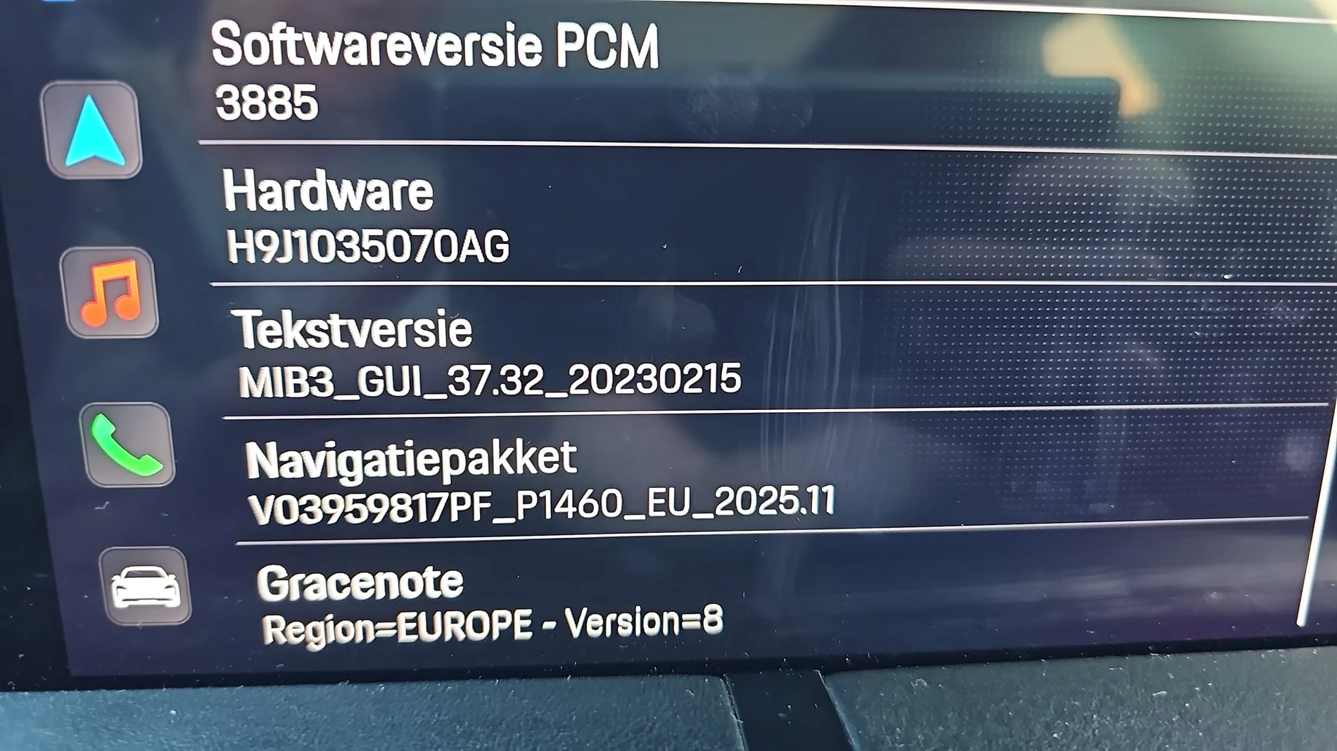

Could it been solved or anything to do with the latest nav update? I just received my car back from the dealer because I had an issue with the driver window (mechanism faulty, replaced under Approved), but also asked for the nav update and got the latest nav version installed. Not sure if that helps, but perhaps worth comparing which versions you are on.
I didn't experience the problems as described by others.

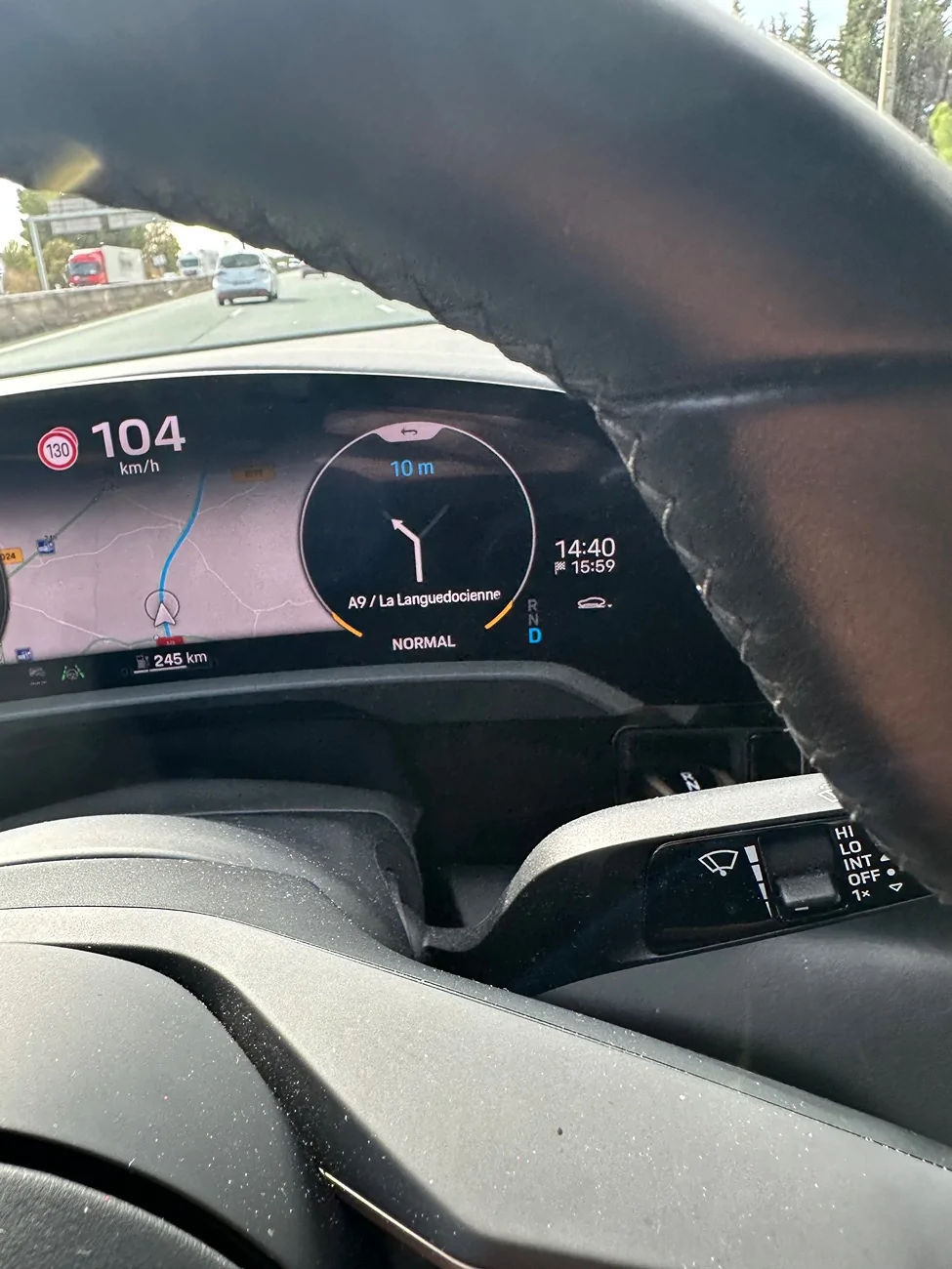

My issue is that the navigation instructions in the driver display as well as the main map freezes. Also voice instructions. And even more strange is that they seem to freeze at different times.
Yesterday my instructions in the driver display, right tube, froze, showing 30 meters to the exit from a round about, while the center display with the map showed 20 meters! And both were wrong since I already had take. The exit a couple of hundred meters earlier. It started working again at the next turn instruction when the voice command came on.
However the main map in the centre display is active and shows the position correctly?
We managed to capture a similar instance a few days ago. Exiting out from a charging stop to the main motorway, the turn by turn instructions froze. And while the map display showed the correct position on the motorway at 100 km/h.
Porsche Taycan EU/UK: Ongoing navigation issues IMG_3188
